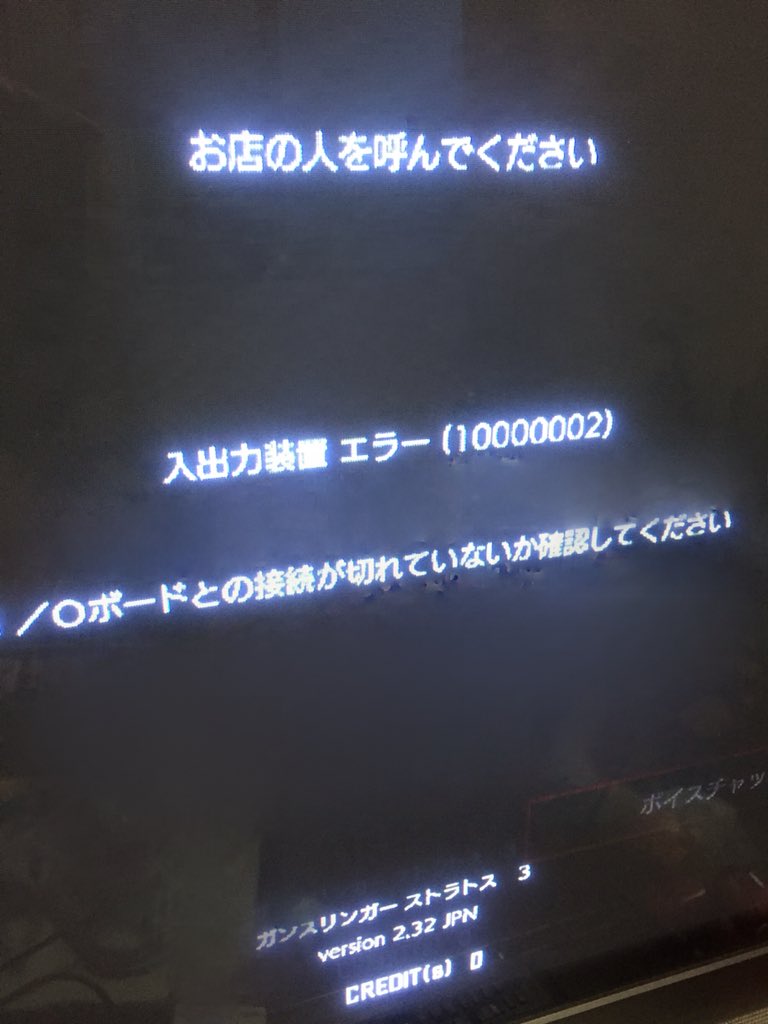

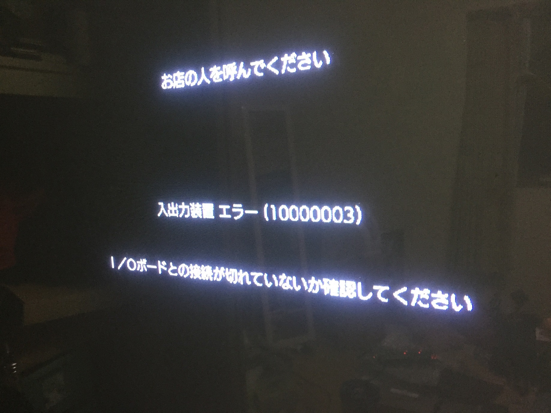

I purchased Gunslinger Stratos ΣHowever, I am in trouble because I / O error does not work
I am about to play with FASTI/O and TypeX3 and Power supply(12V 5V GND GND)
However, it stops at error 10000003(I am sorry that the image is 10000002)
Please tell me about this error
Lack of parts? Power shortage?
I want to know if there are other causes
Thank you for your consideration.

it would probably help to know what the actual error text reads.

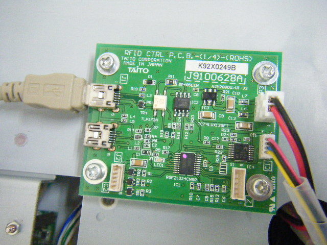

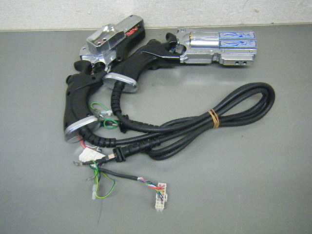

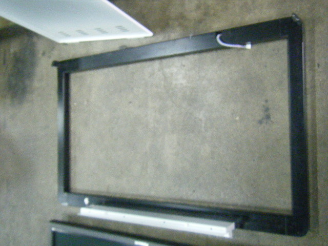

Besides probably needing a Nesica workaround, you will most likely need the Guns, Gun controller boards, Nesica card reader and the infrared array, etc..
If the IR guns work the same way that they do on older Sega equipment (and they look like they do), then there's really no way for the game to know if the gun boards/IR array are connected... they way they communicate is one way, similar to buttons or joysticks; there's no way for the game to determine if they're hooked up since the signal received when they're disconnected is within the realm of valid signals when they are connected.
Have to get the gun boards in hand, but from the pics I saw they look like the same design.
For the OP, without the guns/gunboards, etc..he wont be able to play the game, might get it to boot though with card reader added.
what little I can read of the error message it does reference the "I/O Board", which leads me to believe that it's either complaining about IO board compatibility or something not plugged into the IO board such as the card readers.

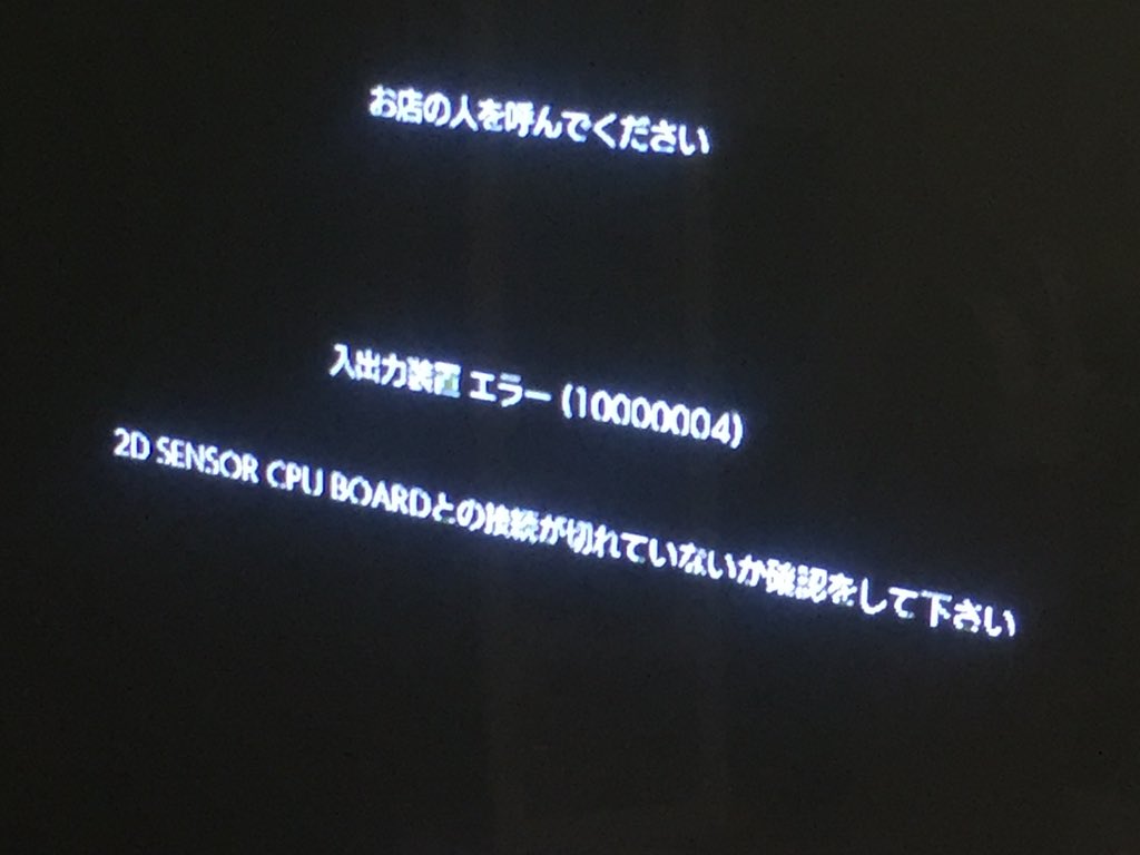

Good evening everyone
Since the card reader arrived, I connected and checked startup.
Existing errors no longer exist.
However, there was an error that there was no 2D sensor as a new error.
If you know more about this error please let me know.

Then I would say the ‘2D sensor’ is part of the gun io and sensors ;)
I am also suspecting that it is an error caused by a gun device or an infrared sensorBecause there is no means of obtaining, it can not be confirmed any more.

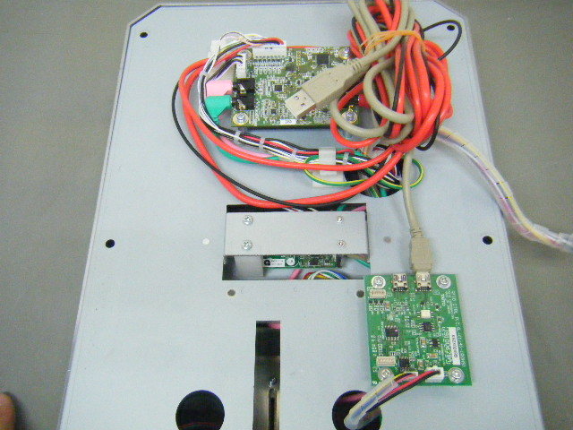

You'll need the following also:
I doubt this game will be playable without the guns/io boards,etc.
