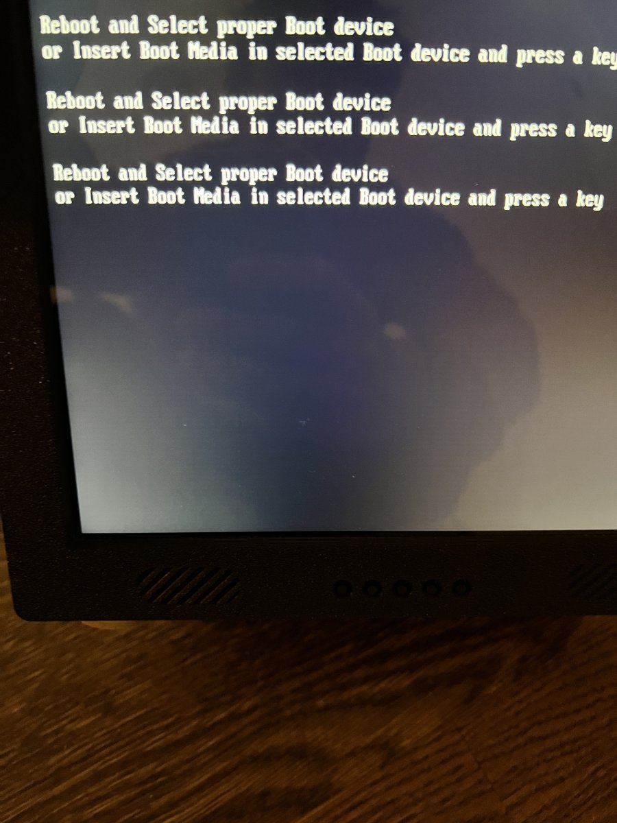

My x3 loaded windows and booted into the stock game it came with as it should. I went into the bios and disabled the security. Now when I reboot I get this msg:
A stock game drive won’t boot with the security disabled. You should be all set to install a new drive with a Multi image applied to it though.
Ok tks for the clarification. I am trying to get this running in my nnc. I have the 31k image from one of the French forums. I have the jvs plugged into the jvs x3 port and the vga plugged into the dvi port, but no signal on the display. Messed with the dip switches which did not seem to do anything for me. Get the taito splash screed into the no boot msg when the hdmi is plugged in. Do I need to have the fast i/o port connected somewhere?
I have the ttx3 31k image fom neo arcadia. I am having trouble getting it to boot. With the security enabled the stock ssd boots up as it should. When I disable the security and install the 31k ssd I get a boot screen error msg. I have toggled between both ahci and ide modes in the bios with the same result. Any suggestions? I would post in the neo-arcadia forum but I cant seem to get past their registration security msg (what is equipped with a screen, joystick, and buttons). I tried all your normal answers (cab, cabinet, arcade, enclosure ect..) with no luck. I sent them an email a few days ago that has not elicited a response.
I haven't tried that image (I'm using the Artax 1080p image) but since you're just booting Windows then the usual "Windows won't boot" troubleshooting steps should apply.
- What's the specific error message you're getting?
- What program are you using to write the image to the hard drive? I suggest using Belana Etcher.
So I used win 32 for the 31k image. Boot msg i was getting attached. I am currently trying to burn the attax 1080 img onto the same ssd with Belana Etcher to test. The first go around I got a write failed in Etcher. Maybe there is an issue with the ssd? It is brand new so I am giving it another go.

Yeah, if you’re getting Write Failed messages then I’d suspect something is up with either your SSD or it’s connections to the computer you’re using to write the image.
So I got the atrax image to work as it should. I will give the 31k image another go using hd raw as that is what is recommended. If I want to run the attrax image using a fight stick with a brook ufb how do I use joy2key? Install it on another cpu to map the controls or do I have to somehow install it on the ttx3?
