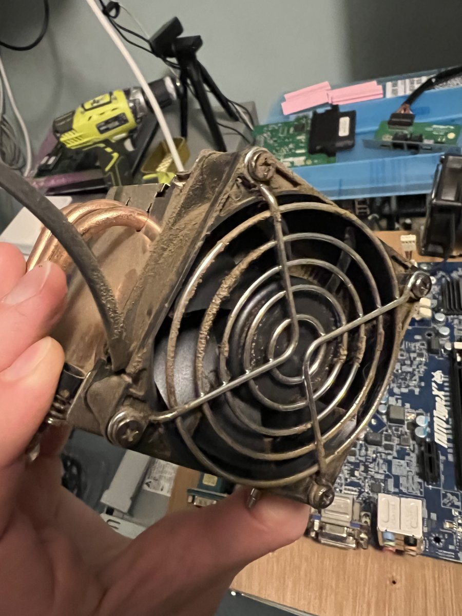

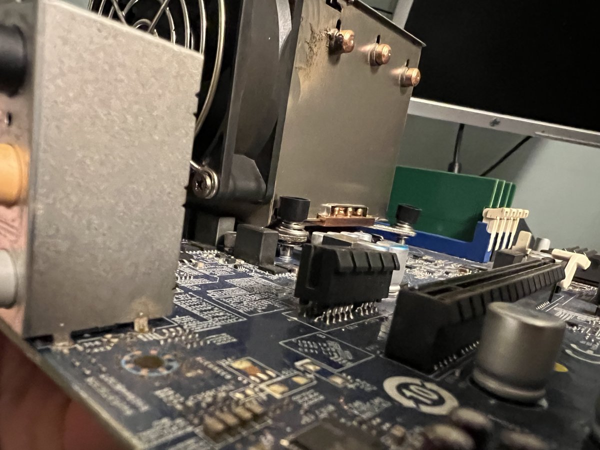

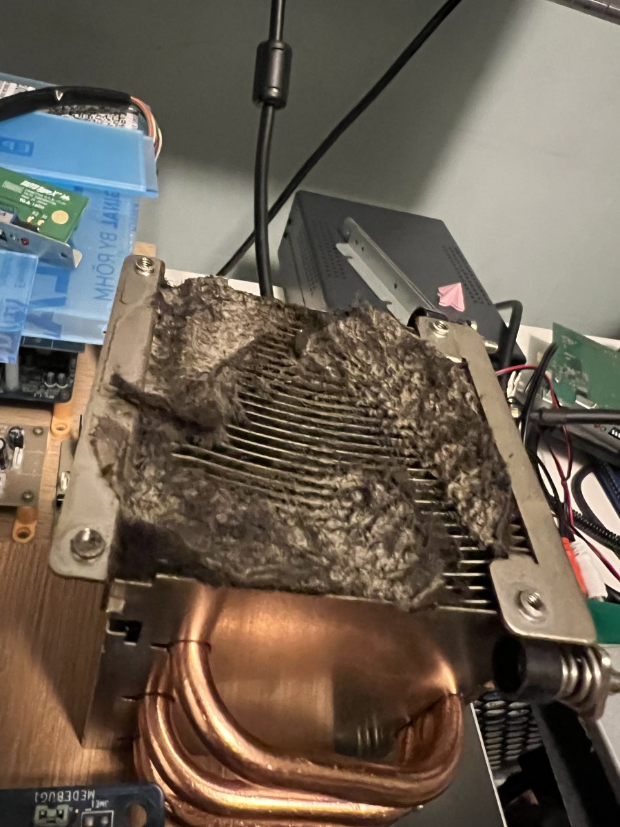

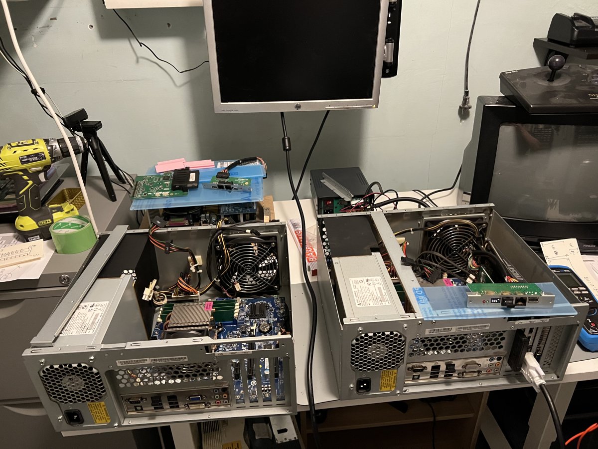

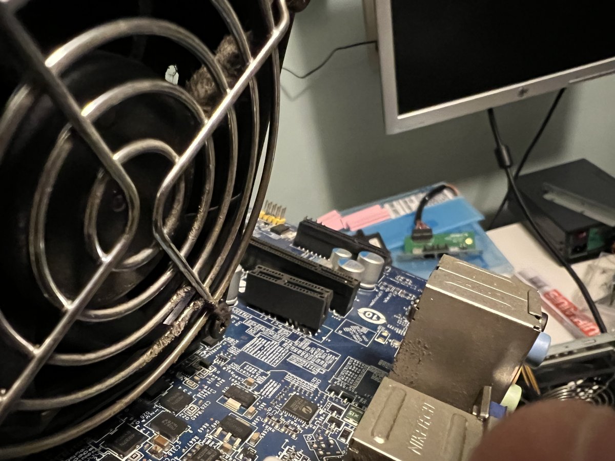

Ok so. Brought the other one over. Opened them up and yeah… theres the problem
Someone managed to smash the security thing plugged into pcie enough to fuck the connector. Will order a replacement and try soldering a new one i guess.

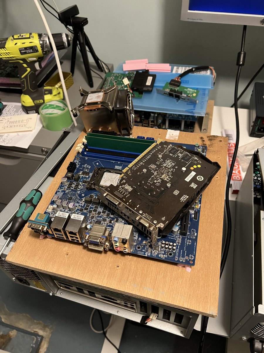

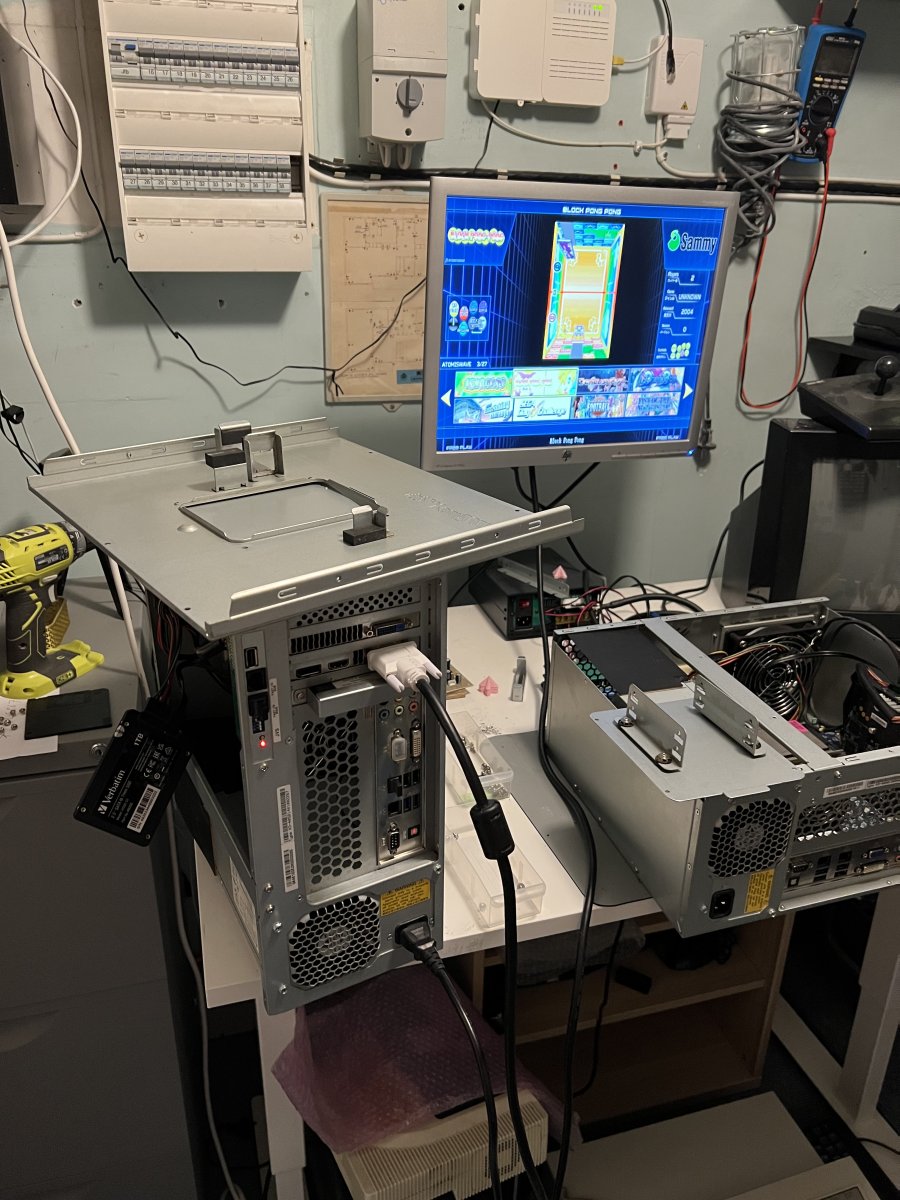

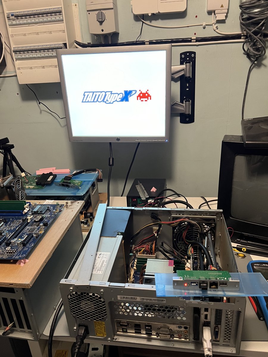

Trying to build a working strong and fast unit based on these two now, and will jam the shitty parts into the broken one for now
Well, moved the better cpu, gfx and ram to the working mobo and hey.
Now bleh. This will suck.
