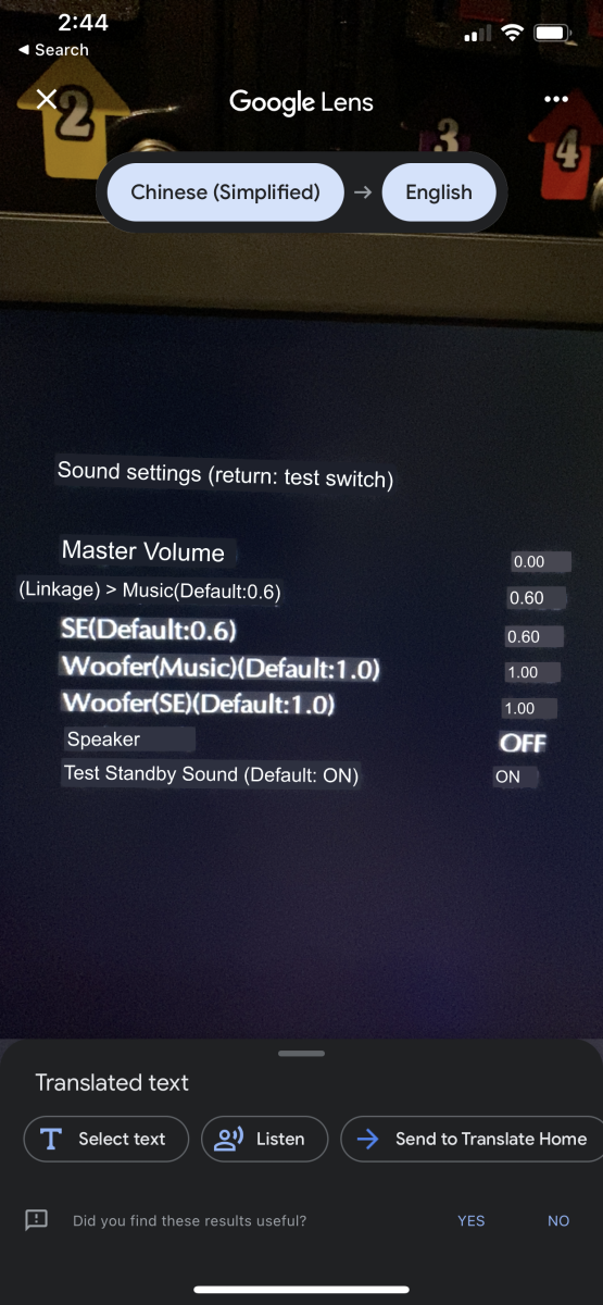

Update: @nem mentioned that there was a pot on the original arcade cab that controlled the volume itself. I verified this on the test screen and it confirmed that the master volume is at 0.
View: https://youtu.be/nxNMKwvo3qk
Looks like I will need another pcb. Will update as soon as I receive one and confirm that is the issue.

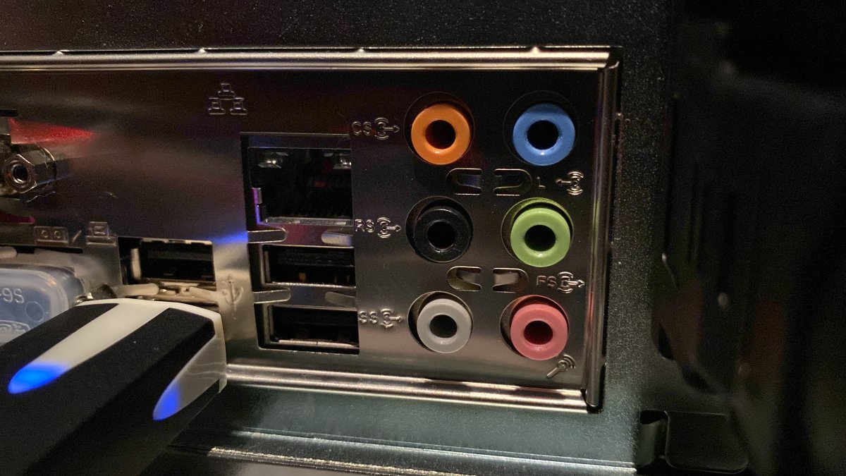

That's weird. The audio comes out of the green (or possibly the blue) socket on my motherboard. I've not checked if it's missing channels or anything, but sounds good like a mixed down version of the audio. I'm going to have to check again to make sure.

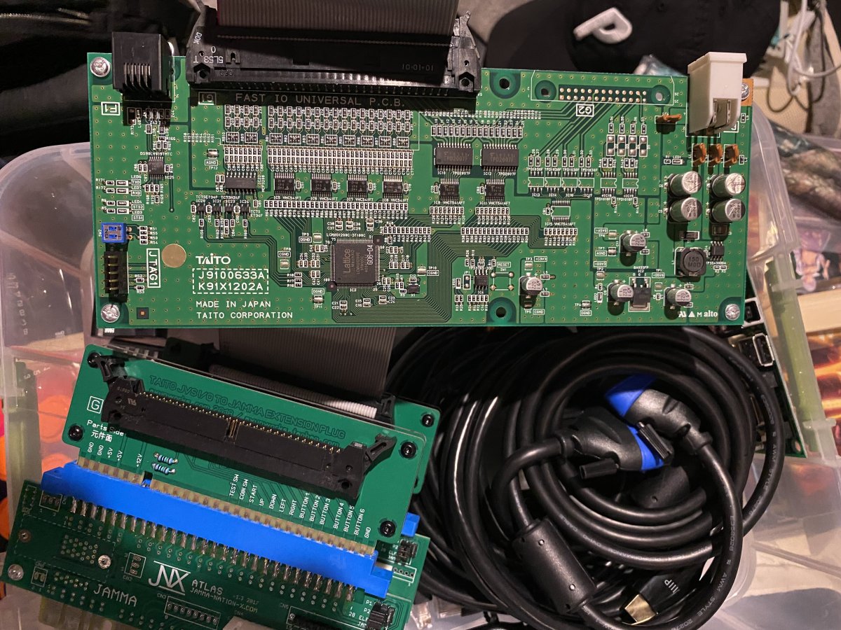

I ended up using a different taito fast i/o which had sound was coming out of it.
2 x K91X1202A > taito fast i/o to jamma extensions from axunwork
The other fast i/o was only used for street fighter type games.
