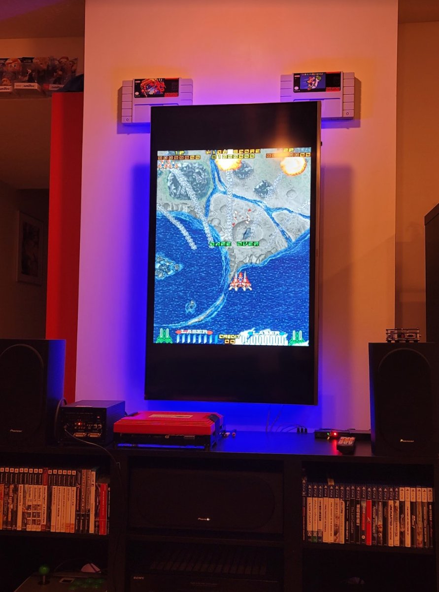

I got my F3 a few weeks ago and ran into the same problem with the OSSC even though I am running my Axun Supergun via HD Retrovision Neo-Geo Component Cables. But the OSSC wouldn't sync for even a second. I read the Retrotink 5X had similar issues but was playable with the curve at the top of the screen.
I had an old Retrotink 2X Classic (like, from early 2019) lying around that wasn't in use, so I plugged in my Axun directly to the 2X and VIOLA! Perfect, stable picture in 2X mode and no s-scroll at the top of the screen (or the side if in Tate). The only game that will flicker on occasion to sync issues using this method is Riding Fight - and it's rare occurrence. From what I understand, the stand alone Retrotink 2X SCART to HDMI should also produce the same results.
Playing Rayforce in Tate on my 50in rotatable (low lag) display is glorious! Nice, sharp, stable image.
