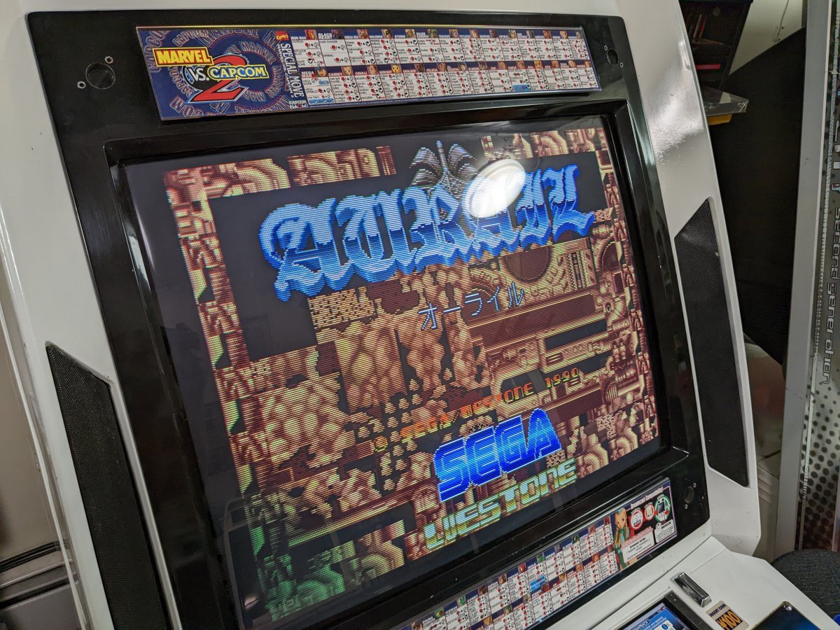

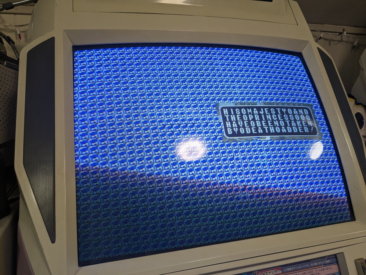

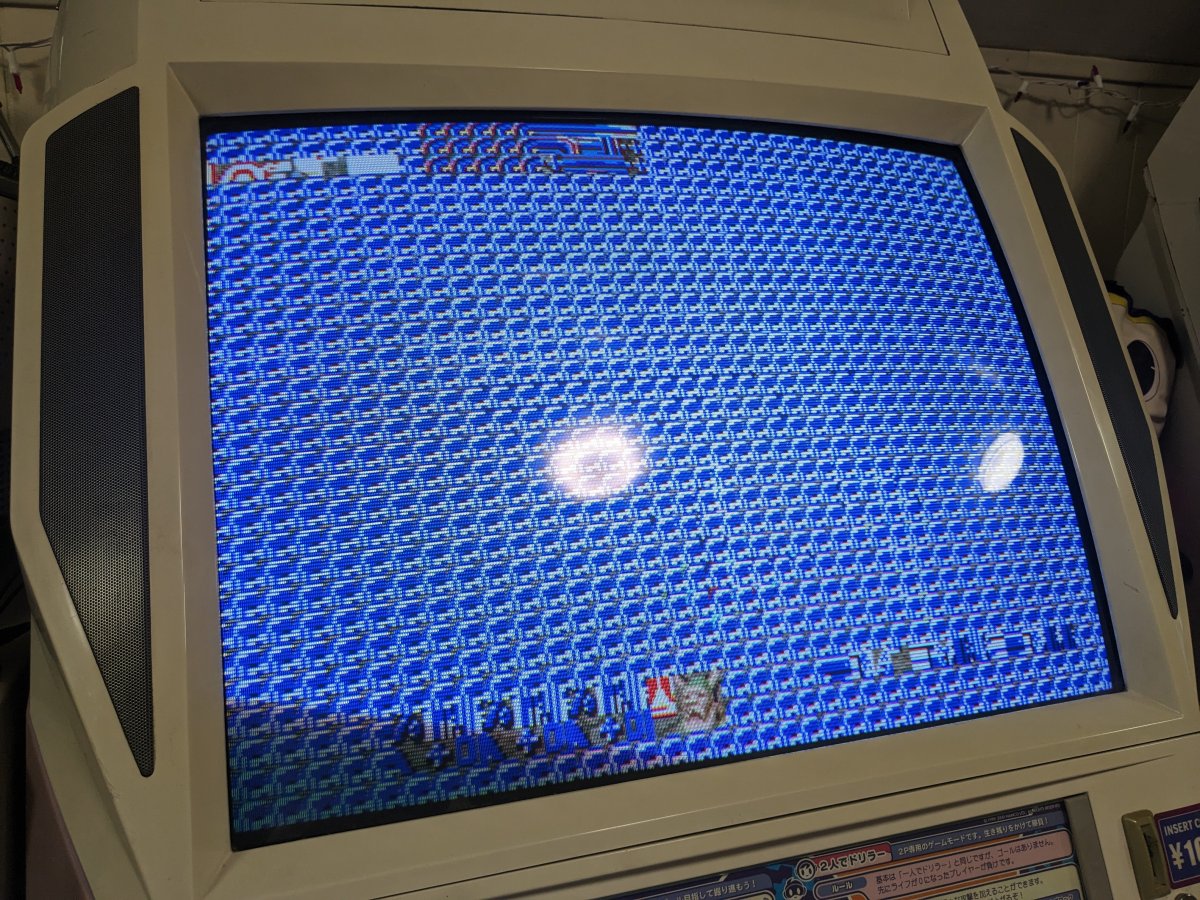

Aurail always exhibits some sort of corruption.

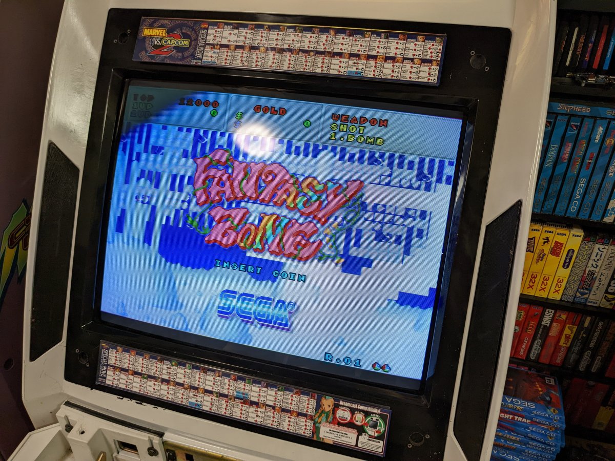

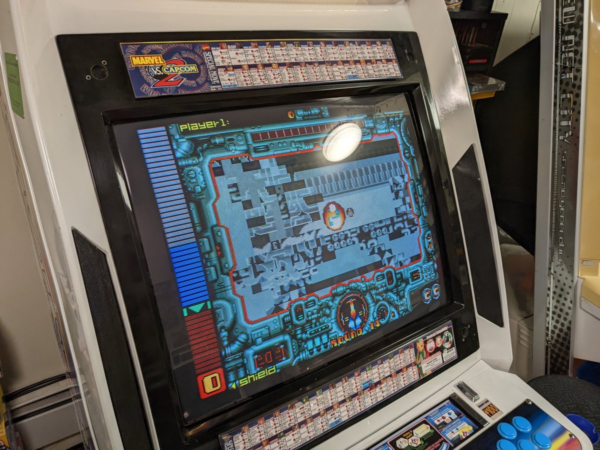

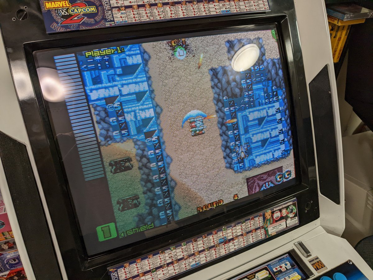

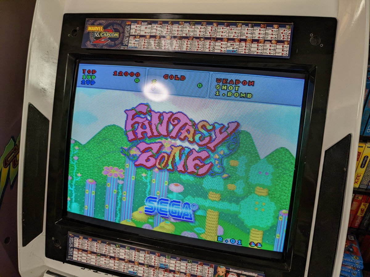

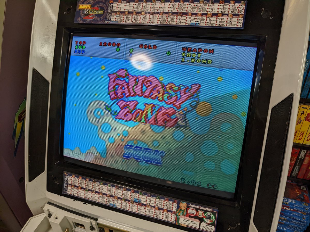

Some of Fantasy Zone was fine and some was not fine.

So it’s pretty much like the ones Im currently facing.
Did you burn the JPN set from the rollup pack ? or did you generate all the files by yourself ?
