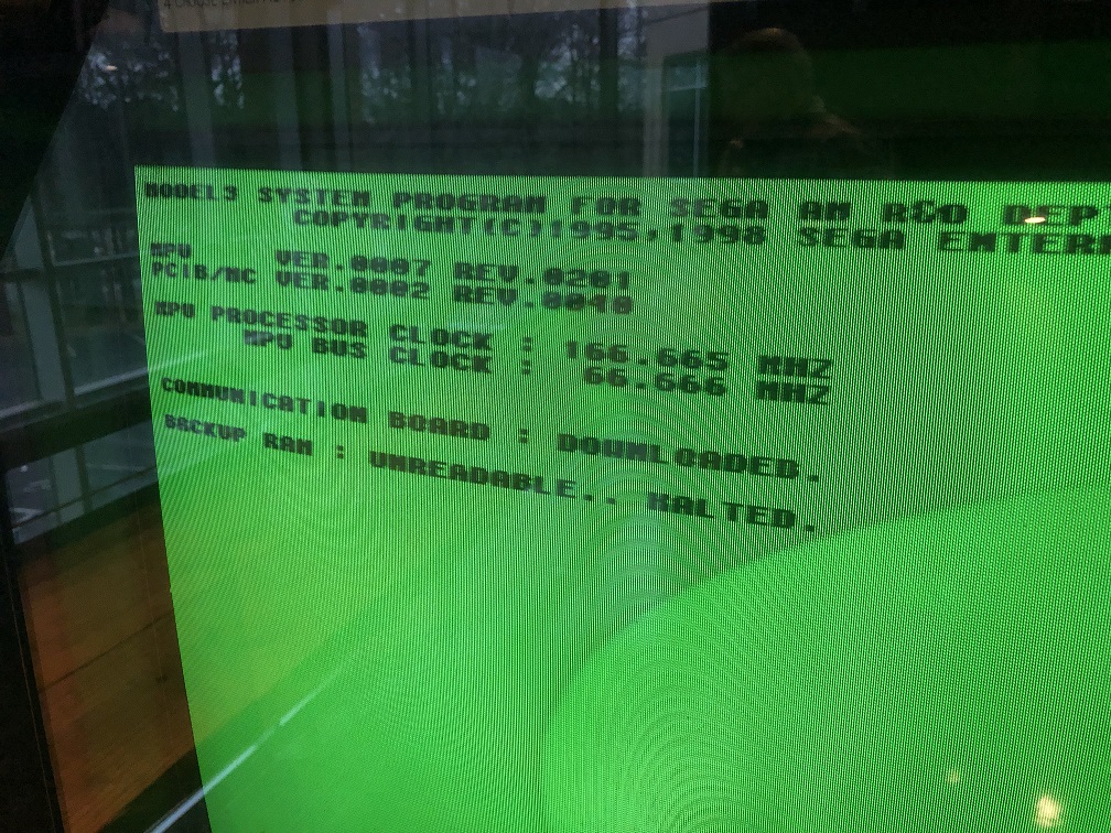

So bought this cab as part of a local deal and it's been giving me issues since day 1...
Doing some research I see this discussed below, but is there not way to fix this w/o buying a new CPU board?
http://www.ukvac.com/forum/model-3-wont-boot_topic367197.html
Any help would be greatly appreciated!
Last year I bought a Daytona 2 full stack from Pennsylvania, and when I powered it on after placing the security chip, it would boot with this error every few cycles. I popped a Harley-Davidson ROM board in that partly worked but froze when scores displayed.
I had sent the CPU board out for repairs and it ended up being a leaking C200 supercap. Maybe I'd check for broken traces there and/or replace that supercap. I unfortunately don't have any good desoldering tools around so I am not able to be fully sure atm.

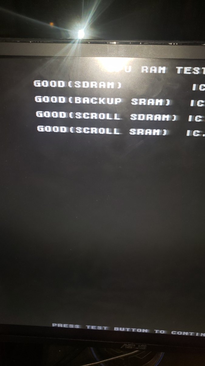

Do you know if Daytona 2 stacks actually run without the supercap? I have a Ski Champ stack that had a leaking supercap. Removed it, swapped coin cell battery and the IC21 and 22 chips display good with it removed.
I am converting a Virtua Striker 2 '99 ROM board to Emergency Call Ambulance with the official security chip and plan to temporarily use it on my Skichamp until I find another working step 2 stack to put it in.
Edit: Yeah... no go with Daytona 2. Black screen only. Guess I shall send this off to Ken if ECA doesn't boot in it.
