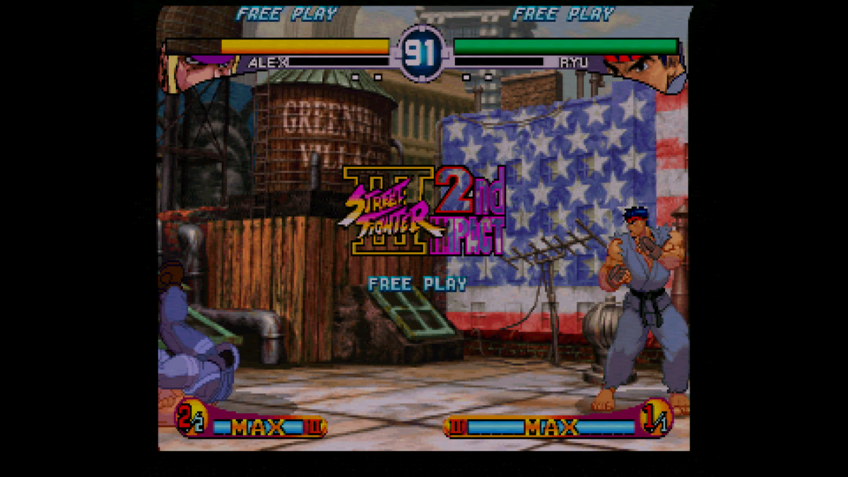

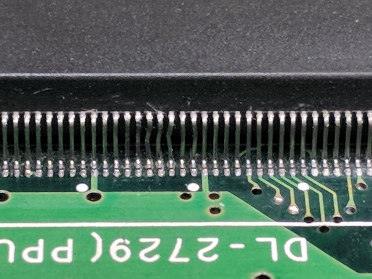

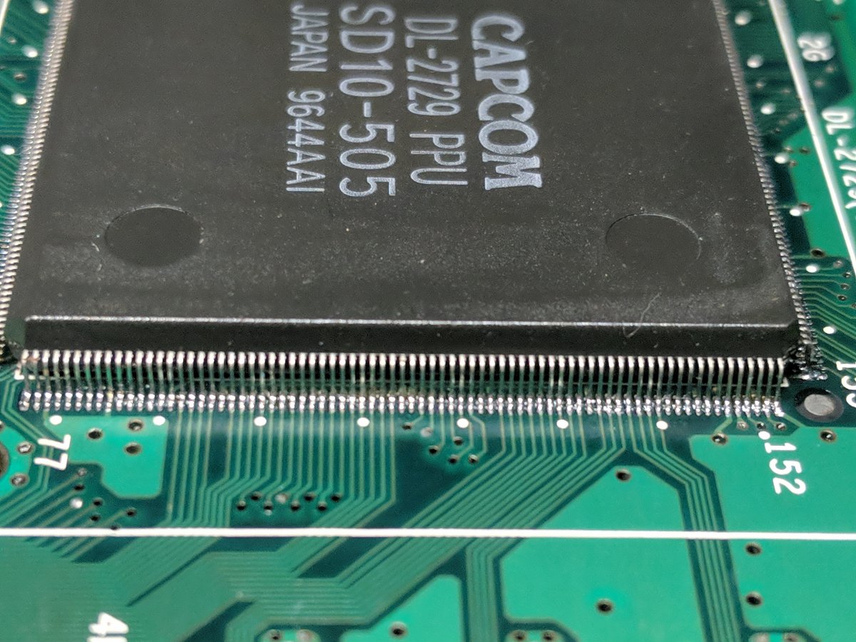

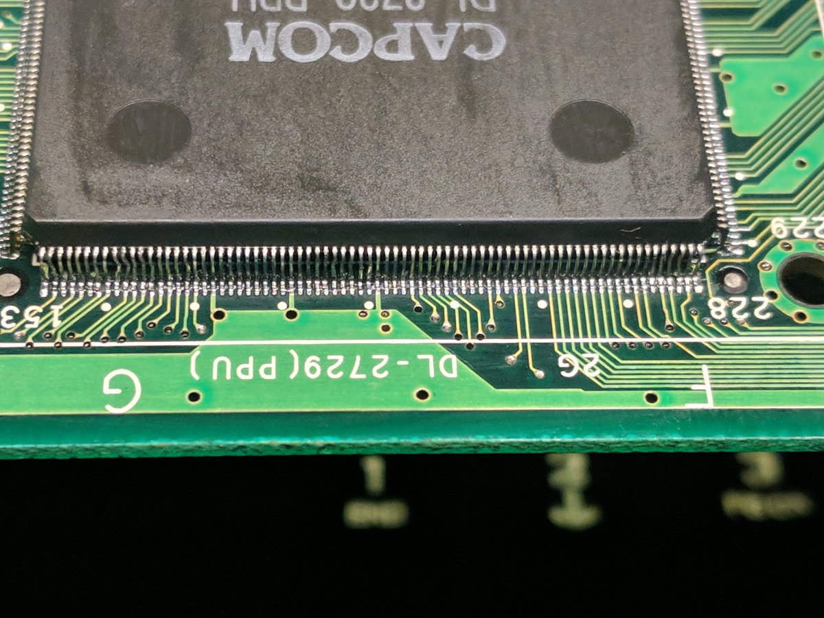

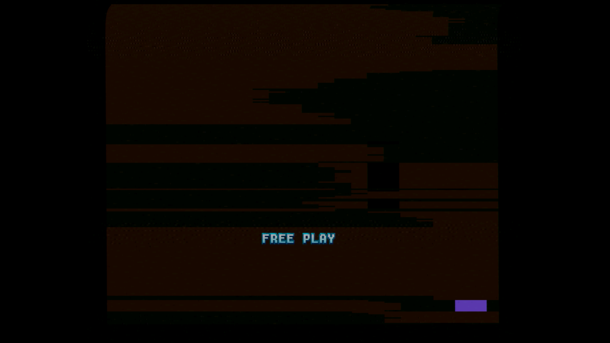

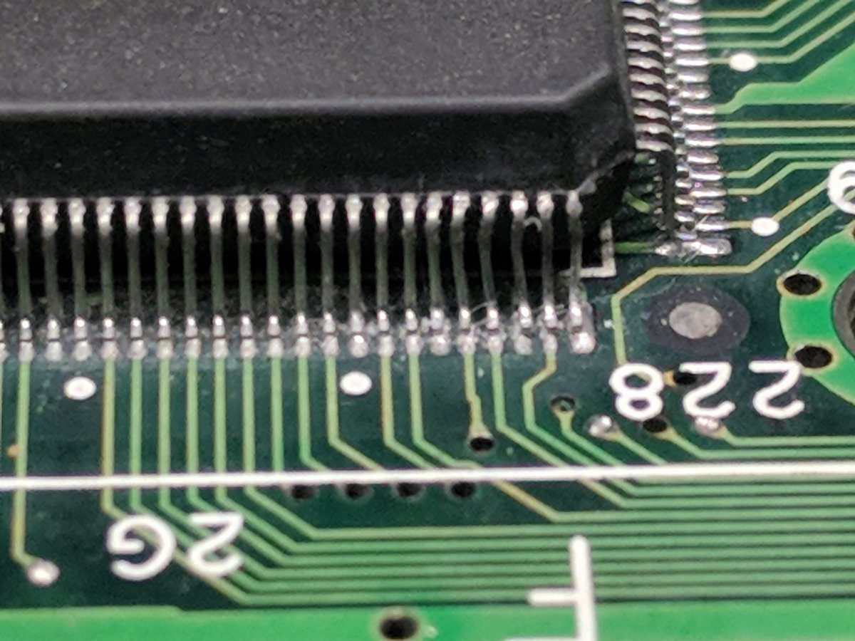

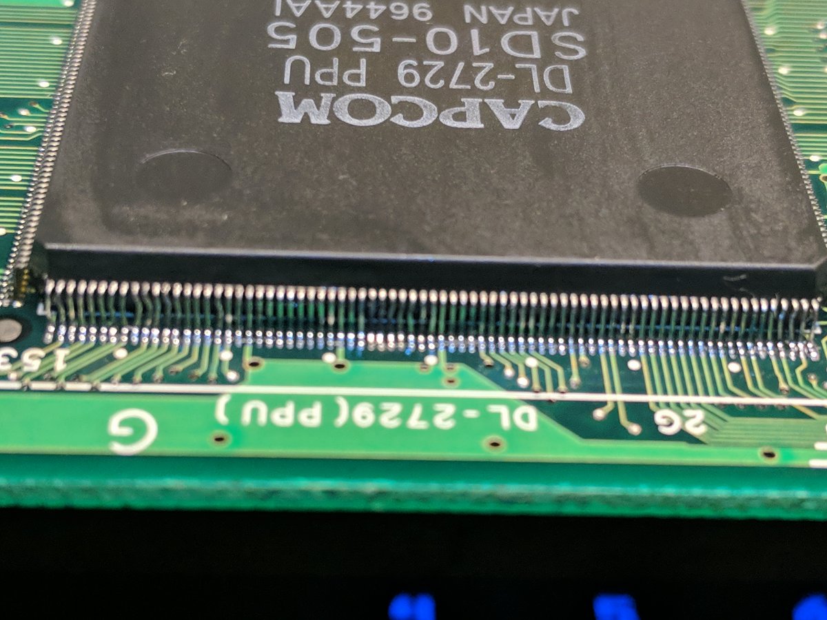

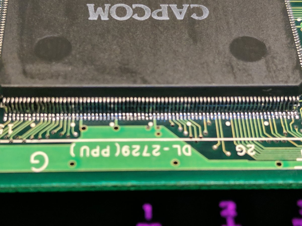

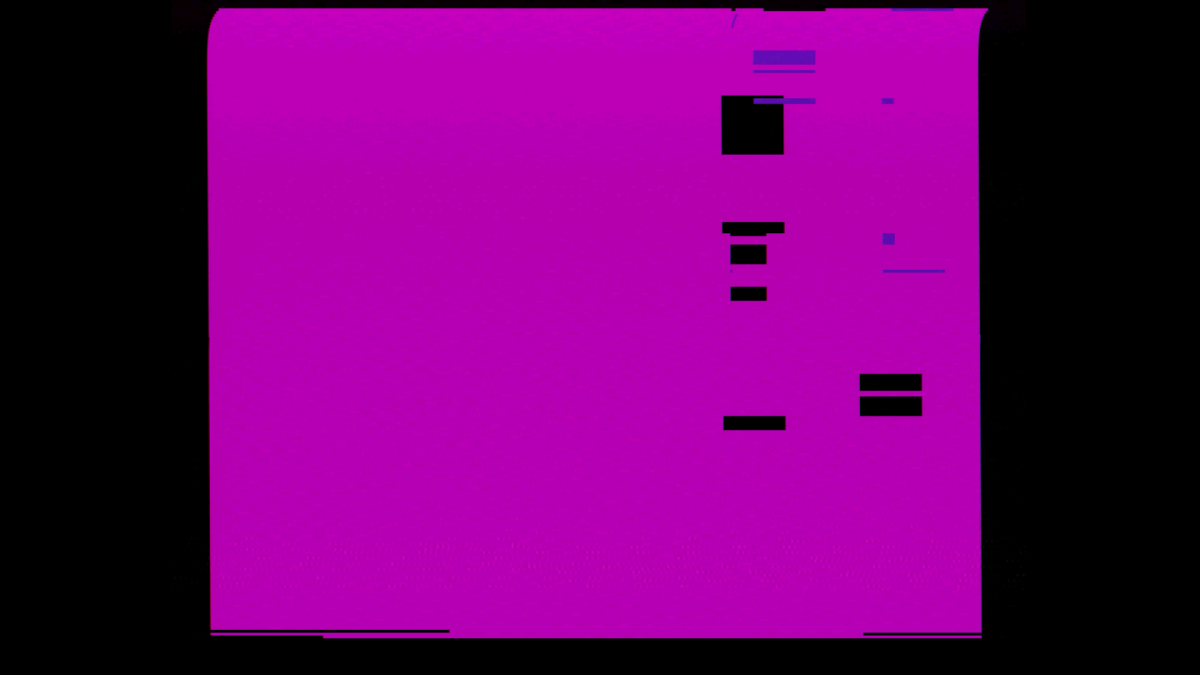

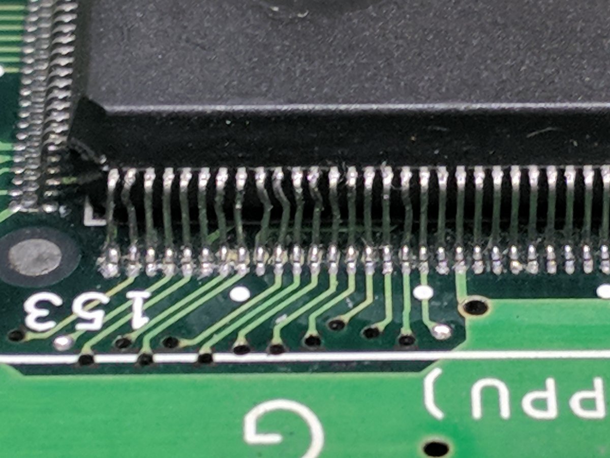

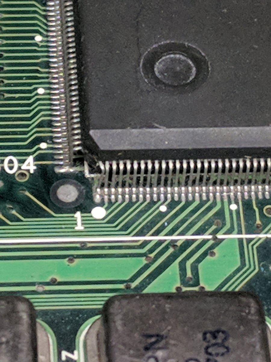

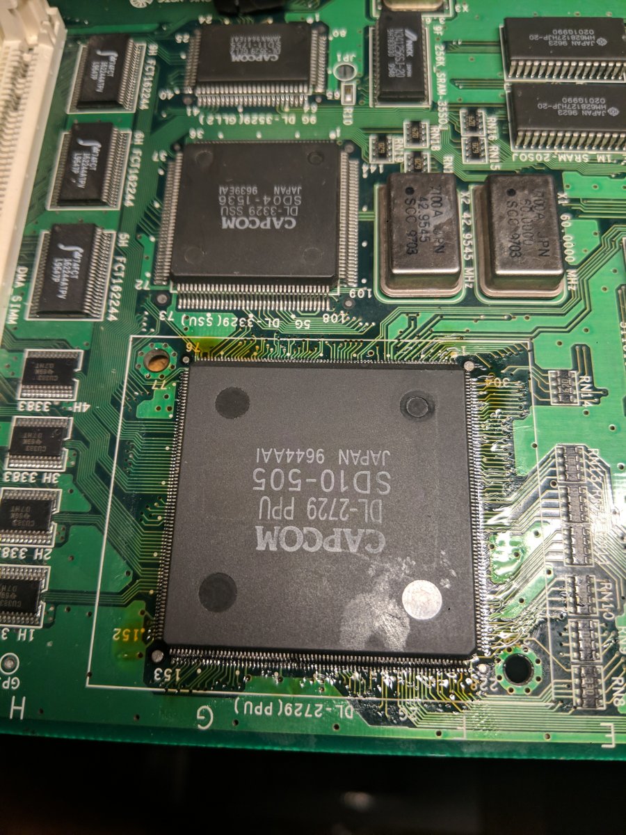

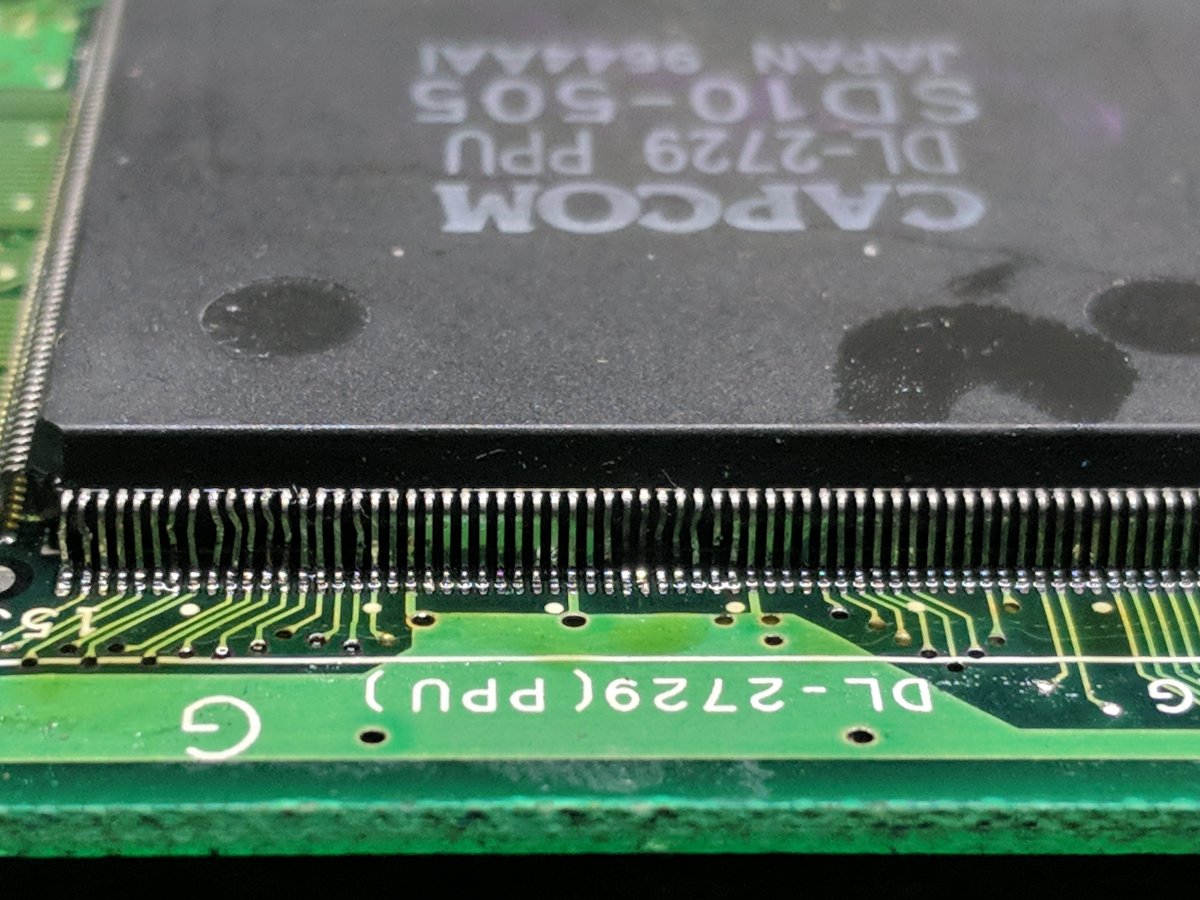

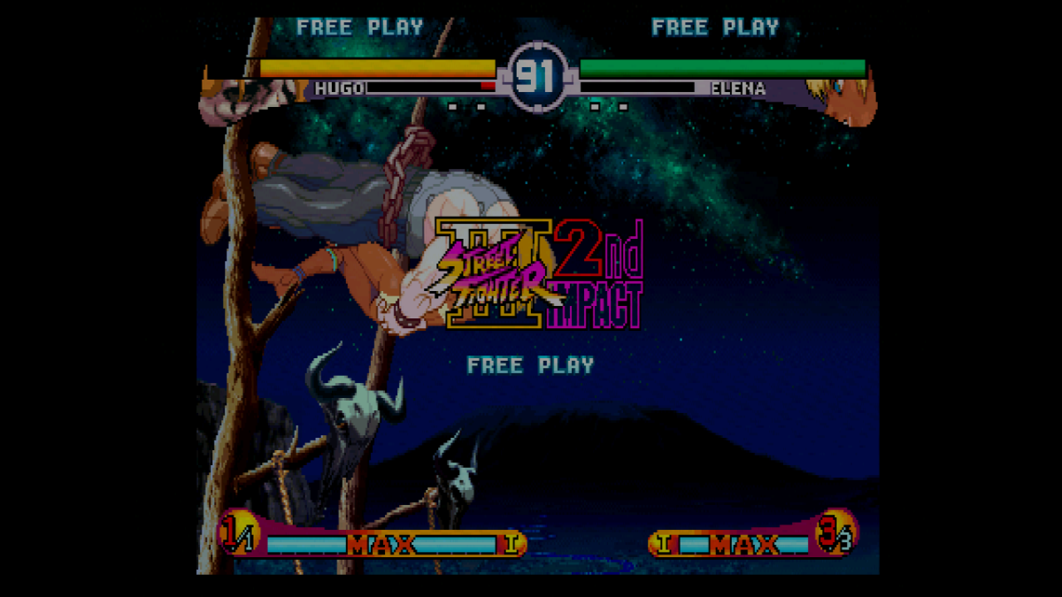

Someone saw my post about the previous cps3 ppu pin repair and sent me theirs. Seems their graphical issues were similar. Some pins were bent, some were floating. I reflowed and straightened the pins.
