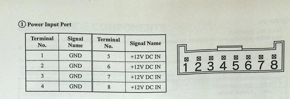

doozer Unobtanium Professional Joined Jan 12, 2018 Messages 222 Reaction score 131 Location Brisbane, Australia Dec 3, 2023 #1 Anyone got a part number and/or link to purchase the female plug required to provide power to a Sega Ringwide?

doozer Unobtanium Professional Joined Jan 12, 2018 Messages 222 Reaction score 131 Location Brisbane, Australia Dec 4, 2023 #2 It appears to be an 8 pin JST VH female. Attachments ringwide_power.png 353.6 KB · Views: 45
Darksoft Staff member Immortal Joined Jun 12, 2015 Messages 11,447 Reaction score 16,829 Location Poland Jan 13, 2024 #3 https://www.tme.eu/es/details/vhr-3n/conectores-de-senal-raster-3-96mm/jst/ And these are the pins: https://www.digikey.ca/en/products/detail/jst-sales-america-inc/SVH-21T-P1-1/527367
