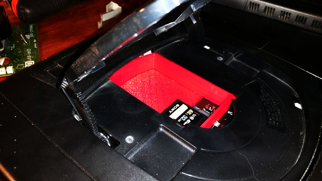

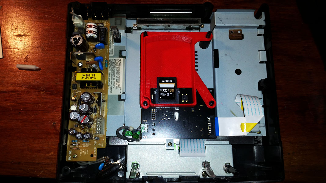

First test print.
Mounting is perfect, I need to reduce the wall height a hair since it puts a little pressure on the case right now when bolted down. then I'll change the front and back walls a bit to fill in the few remaining gaps.
