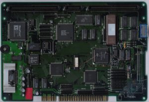

V1: IGS PCB NO-0133-1 (25G4285-1)
From gc8tech.com
This is the oldest version Identified so far.

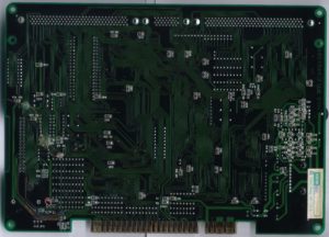

V3: IGS PCB NO-0133-3 (25G4285-3)
From gc8tech.com
Similar to the above PCB

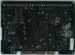

V5: IGS PCB NO-0133-5 (25G4285-5)
This one Came From Yahoo Auctions bundled with a Demon Front Cart
Similar to the one above

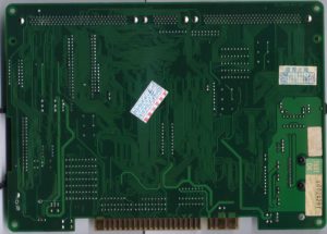

V10: IGS PCB-0133-10 (41-069-B4-10)
From gc8tech.com
Similar to the above PCBs

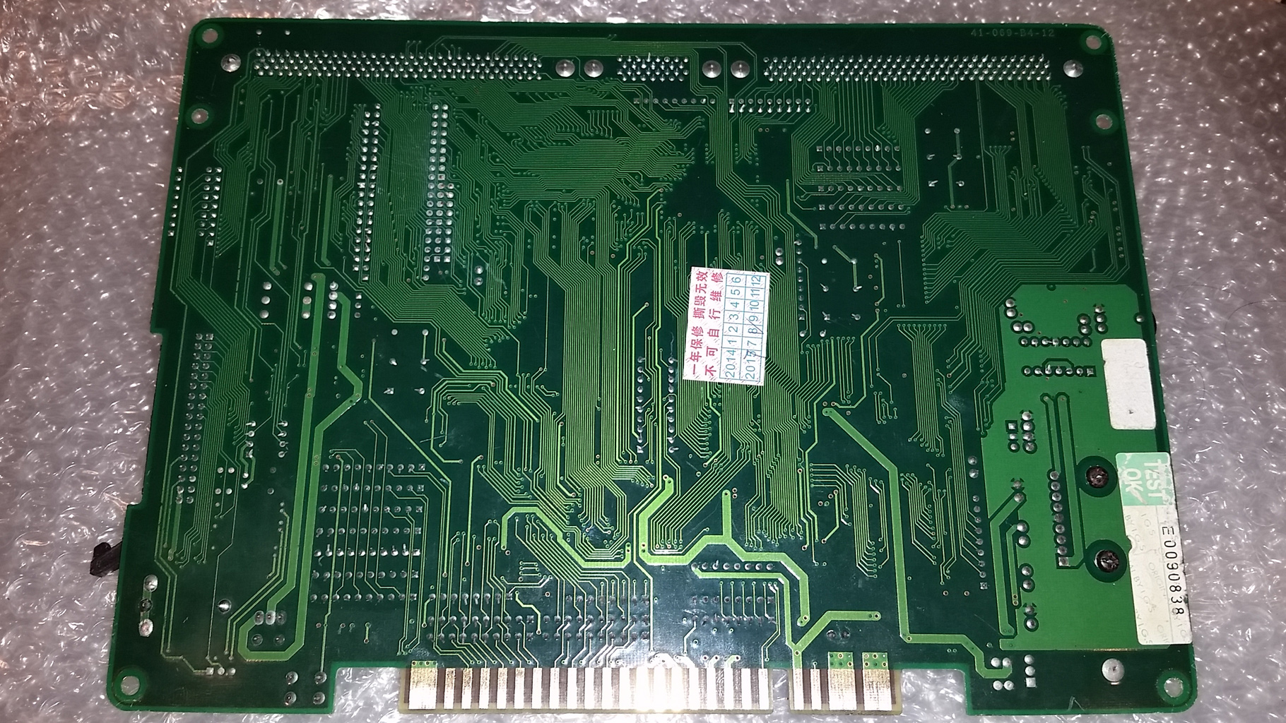

V12: IGS PCB-0133-12-CP (41-069-B4-12)
This one came From Sheep Nova

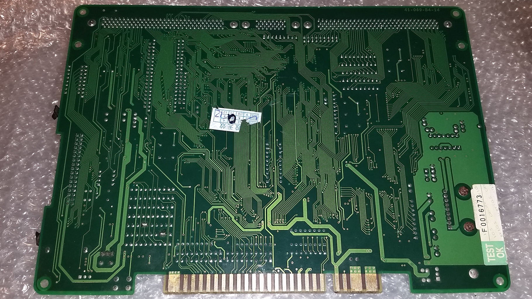

V14: IGS PCB-0133-14-CP (41-069-B4-14)
This one came from Yaton and was bundled as part of a DDP2 kit
This is the newest revision identified so far.
the battery section switched from a square silk screen to a round silk screen and where the previous models had several pin options for the battery this one seems to have only one option and was shipped with a battery holder rather than a soldered battery.

So all 3 of these look very similar, they all have the same major chips in the same general location.
the biggest difference between the first and second boards that I can see is the inclusion of a 3.3V voltage regulator on the lower left. I'd suspect they use newer versions of components that require a lower voltage, hence why that appeared.
the only differences I can see from the second and third boards is some of the trace routing around the battery, this is most noticeable on the bottom of the PCB but even then the differences are subtle.
