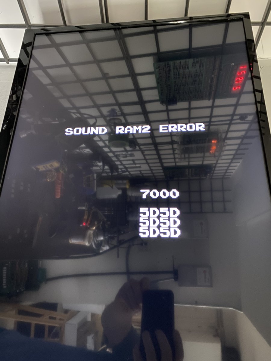

Hey, I think if you turn the game on but with the DIP switch configured for service mode (I think its the 1st one), it will do a "rom test", maybe that can yield some useful information?
Excellent - I had gone into that after boot (to set options), but didn't realize upon boot that it did a self test. Here is what comes up.
Off to see which chip is sound ram2.

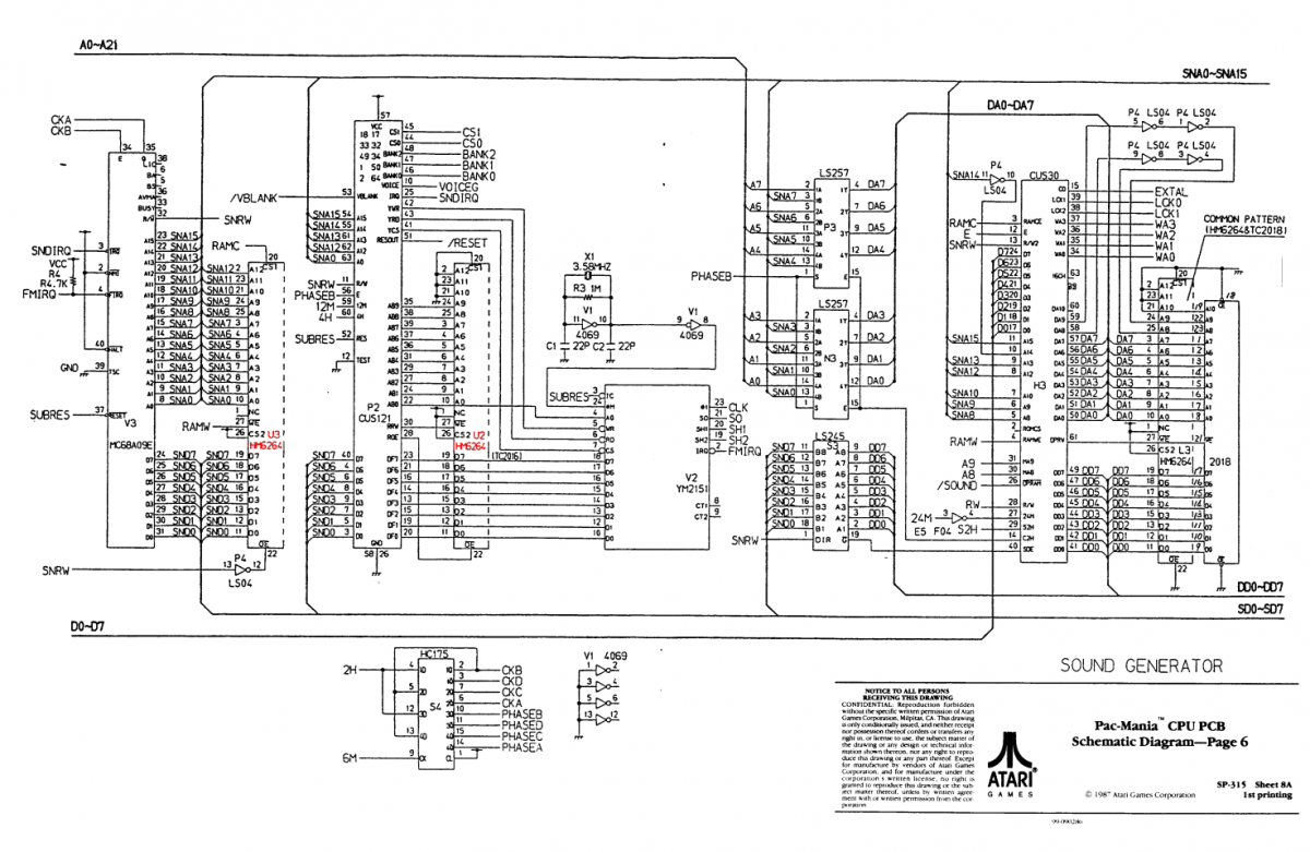

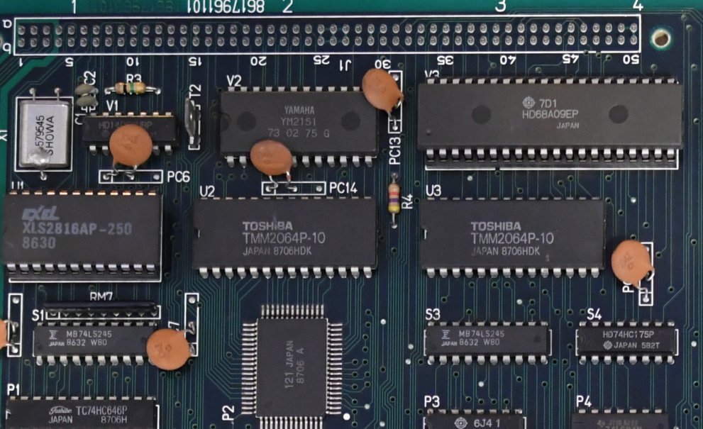

Both U2 and U3 are right there at the "sound generator" part of the pacmania schematic, don't know which one would be "RAM2",.. but if replacing one doesn't work I'd replace the other. And I had a pic I took from my pacmania board where you can see the 6264 exact model, maybe you find it useful, good luck!

So I replaced U3.. upon bootup, basically no sound now - except some samples at the level selection screen.
When I do the test - I get "SOUND CPU NOT RUNNING".
off to look at schematics.

V3 looks to be the sound CPU, I swapped it out with a known working Hitachi 6809 (from a working Namco System 1 board) and still the same issue. Likewise, the sound CPU in the other working board works fine.

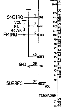

You’ll want to get a logic probe eventually (they’re only $20 or so), but in the meantime, check for continuity on the HALT line to the reset circuitry (see schematic) and check continuity on the CLOCK line.
Logic probe is ordered. I looked at the schematic and tried to find the continuity test points. On the sound CPU (V3) I see the HALT pin is 40 but I can't see where it connects to - other than pin 2, and then its just a line.

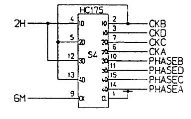

For the CLOCK line I see two clocks - Clock A into 35 and Clock B into 34 - and it looks like the clock lines are coming from the H175 chip at S4. ClockA is pin 6 and ClockB is pin 2. Any way I test - I don't seem to have continuity from the chip at S4 to the CPU on V3. I suspect I am doing something wrong.
I've had a chance to look over the schematics some more on a real computer (rather than my phone). Here's what more details on what to check:
- Pin 37 of the Sound CPU is the Reset line. It should be triggered once to start the CPU executing. It's Active Low, so with a logic probe connected you should see it pulse briefly from high to low then stay high all the time at board startup. The pulse trigger (SUBRES aka Sub CPU Reset) is generated by the Custom 117 chip located at N5 on Pin 51 and then runs to several parts of the board (Schematic page 1). Make sure you read continuity between Pin 37 of the Sound CPU and Pin 51 of the Custom 117.
- Pin 40 is the Halt line. It's tied together with Pin 3 (NMI aka non-maskable interrupt) and Pin 4 (FIRQ aka Fast Interrupt Request). This line will halt the CPU execution temporarily from time to time during normal operation. It's Active Low, but you should see it pulse regularly during normal operation. If the logic probe shows it holding low all the time, then something is wrong with the lines that feed it. Make sure that continuity is confirmed between Pins 2, 4, and 40 on the Sound CPU.
All three pins can be triggered by either the SNDIRQ (Sound Interrupt Request) or FMIRQ (Fast Interrupt Request). SNDIRQ is generated by the Custom 121 located at P2 on Pin 25. FMIRQ is generated by the YM2151 audio generator located at V2 on Pin 2. Both are shown on Schematics Page 6. Verify continuity between Pin 40 of the Sound CPU to both these points.
- As you noted, the Sound CPU uses two clock signals, and those signals are generated by the HC175 chip located at S4. There should be continuity between Sound CPU Pin 34 to HC175 Pin 6, and continuity between Sound CPU Pin 35 to HC175 Pin 2. A logic probe should show regular pulsing activity on both clock lines on the Sound CPU.
Hope that helps. Let me know what you track down.
Now that I figured out chip pin numbering, continuity here is good.
Pin 40 and pin 2 on the sound CPU have continuity - which is how I believe it should be looking at the diagram again (not pin 4).
V2 pin 2 has continuity with sound CPU pin 4. P2 pin 25 has continuity with sound CPU pin 3.
Clock signal continuity looks good also.
Next step - when I get my logic probe - revisit these and see how they act while the board is under power!
