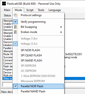

Received my FlashcatUSB XPORT yesterday, currently finishing to flash the last memory module.
It's slow, but as you have to do this only once...
To be noted : you have to set the programmer in "Parallel NOR Flash" mode.
This is not mentioned explicitely in the instructions pdf file, but you can guess it by having a look at the Console log screenshot.
