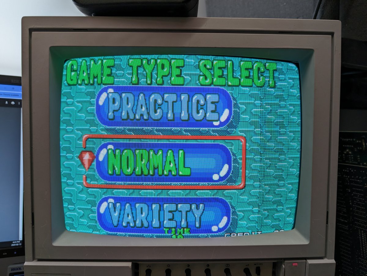

Wondering if anyone has seen this before. This 4 slot board is showing black dots on the right quadrant of the screen on all slots, and different cartridges.
My 4 slot actually has LSPC-A0 and PRO-B0. So I went through with those two figures and checked all the connections - they are all there, nothing missing that I can find.
