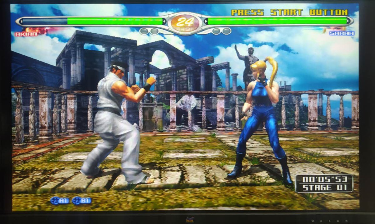

The above link shows some various patches for running games in widescreen on the Naomi.
The resolution stays the same, but I think the FOV is changed (image is squashed) so when it's enlarged on a 16:9 display it looks correct.

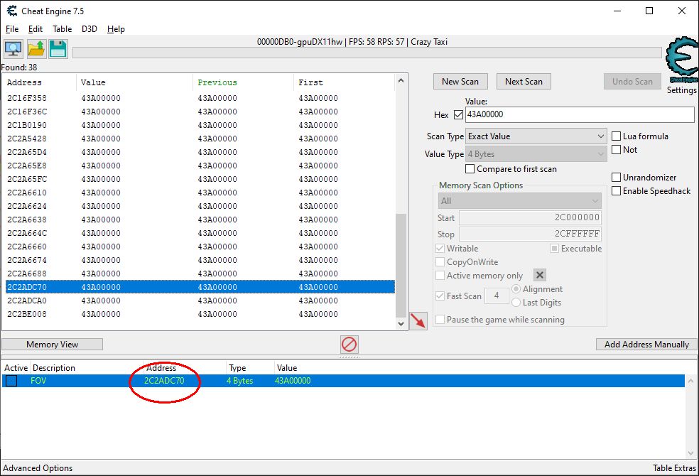

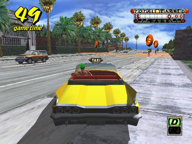

So I'm not sure why, but I started thinking about this recently. So I messed around a bit with Crazy Taxi yesterday.
DEMUL + Cheat Engine:

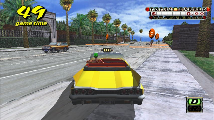

Here's how it looks like when you set "FOV" to 43700000 and stretch it to 16:9:
Looks good to me!

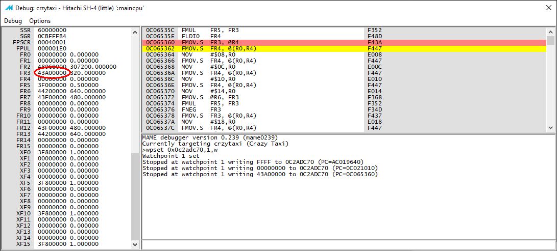

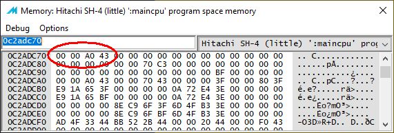

Let's put that memory address in to the Mame debugger and put a watchpoint on it:
Now I just need to figure out where and how the FR3 register is being filled?
