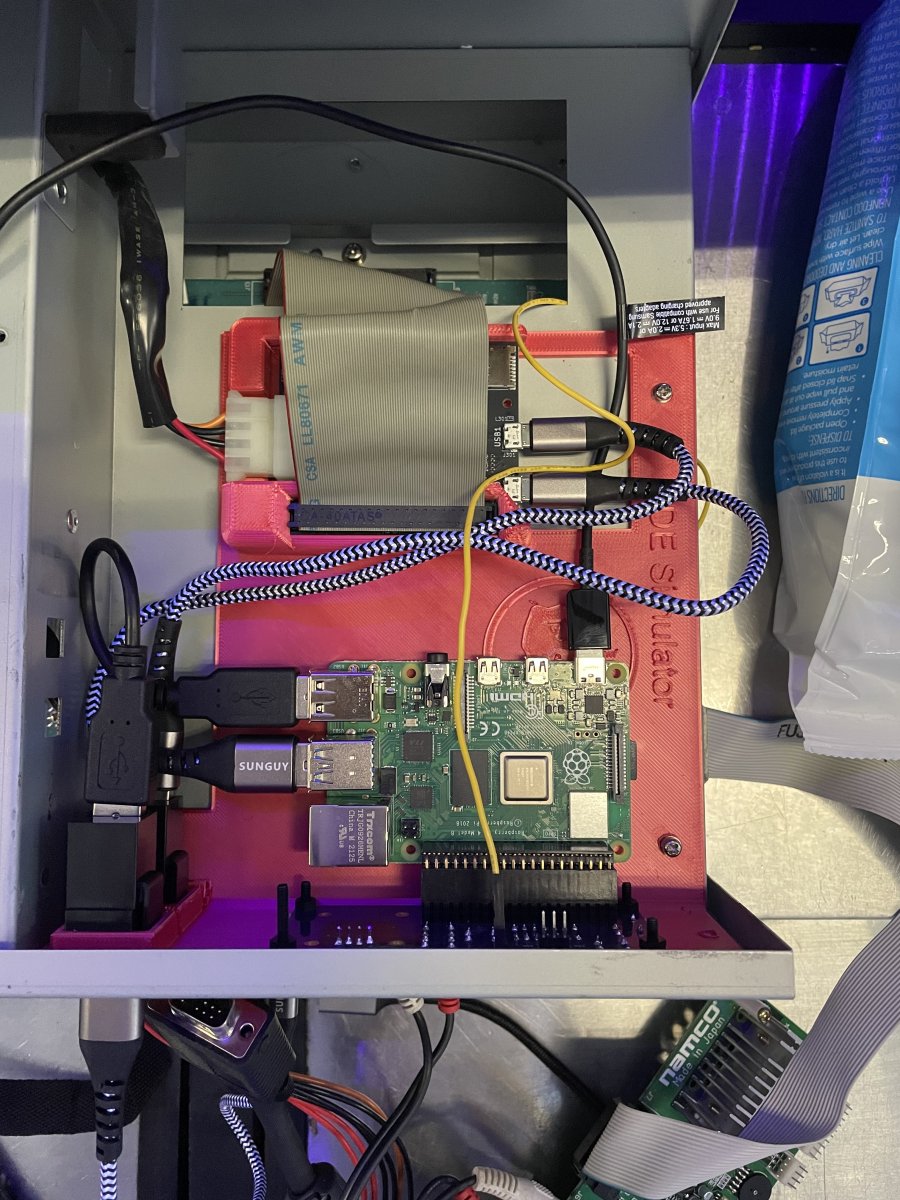

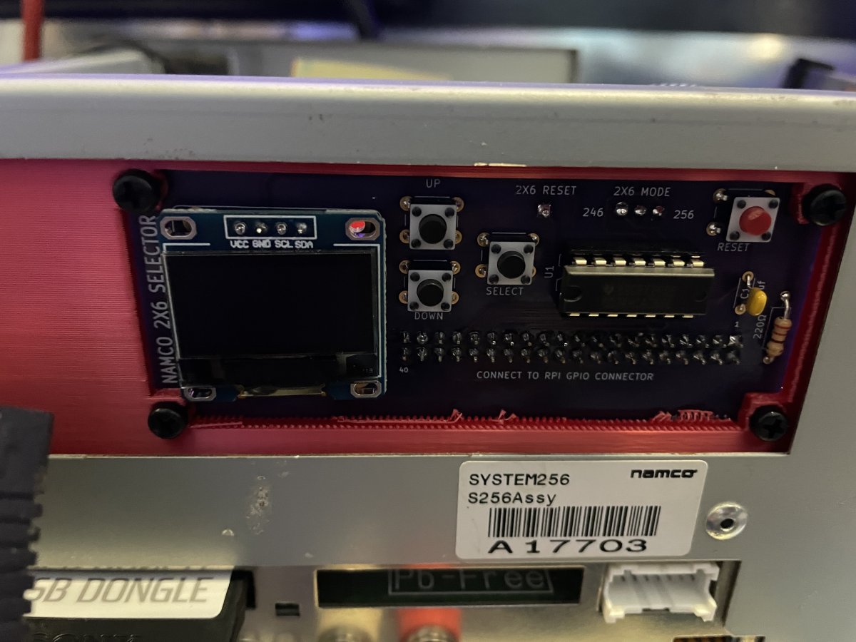

So I got everything set up I had to get a rpi4 hoping it would work. I plugged in the rpi to test before I hooked up to a machine but the screen just gets like.. unbelievably hot
Edit : Amazon sent me the wrong fkn screen vcc and ground are swapped
And do I need the 12/5v line plugged into ode I’m assuming

You actually don’t need the Molex plugged in - the rpi can power the ODE with no issues. I assume you have a 246? Since the selector pins aren’t hooked up.

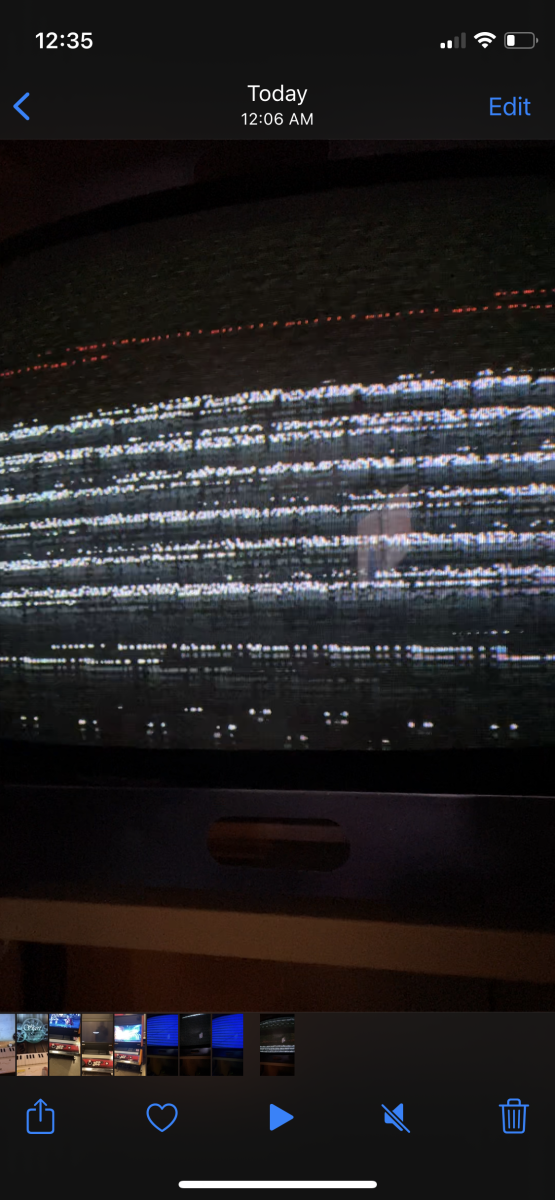

I got another screen was wrong again..
This is what I got. Acted like it wanted to start then just blank screen
It’s a 256 gonna hook up the pins when I get the proper screen.

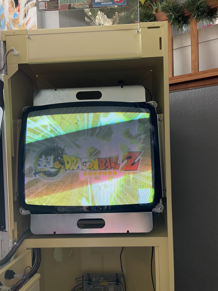

Yea I have some games I’ll double check operation but worked when I last had it hooked up

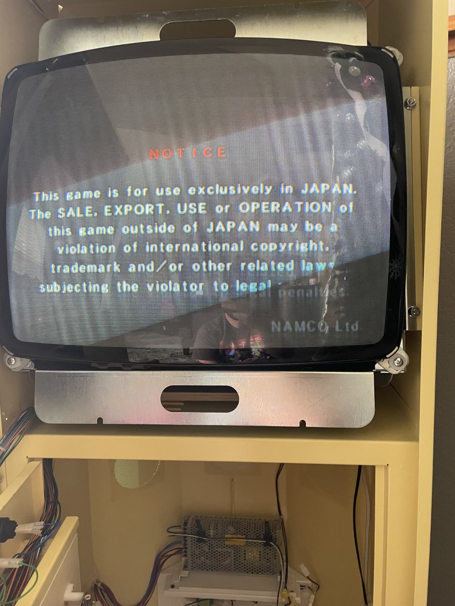

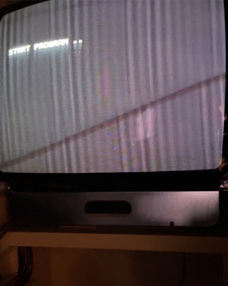

Ok made “some” progress confirmed working with my dragon ball dvd
So I hooked the multi rig back up had a 256 mode error swapped the jumper then got to the (notice screen) thought it was all good but then it just goes to black screen after countdown. I wanted to try another game but without the screen a little difficult. I’ll wait till the screen arrives and get the 256/246 plug installed to the multi
