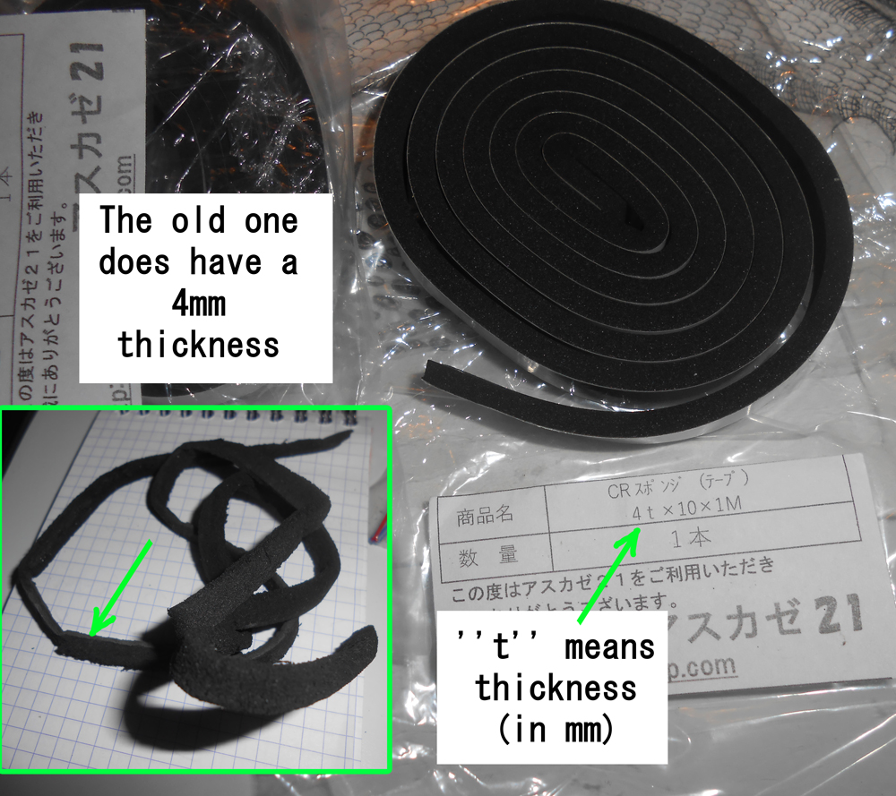

Refering to my measures, the former one was 4mm. 25 years later it may shrunk, but I guess 6mm is too much (I see you have got 6mm).
I'm simulating the foam since days, and I start to think that 3mm should be enough, I suppose.

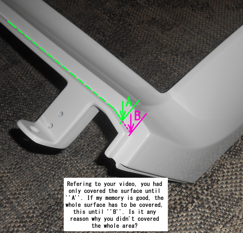

Also, I wonder about the lenght of your foam. Maybe you didn't put enough (check pic#2)
