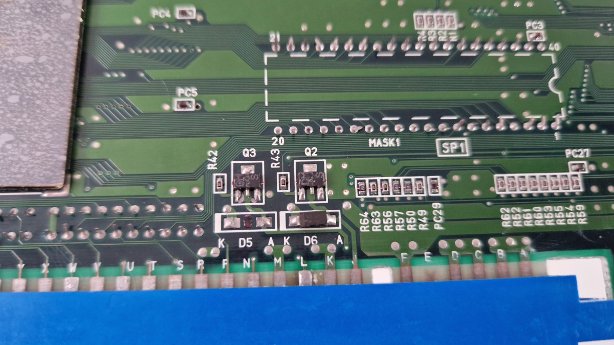

I bought this MV1A board off aliexpress and made a supergun. Works fine but on inspecting the underside of the board there is a missing component labelled D5, near the Jamma edge.
Does anyone know what the purpose of this smd is for and if its recommended to replace it? It looks almost like a tantalum capacitor

It's a Diode connected between the coin counter and 12V line if I am not mistaken, protection?
Ah, hope that is the case cos i'm doing the 5v mod and that can just get chinned off if not required.
