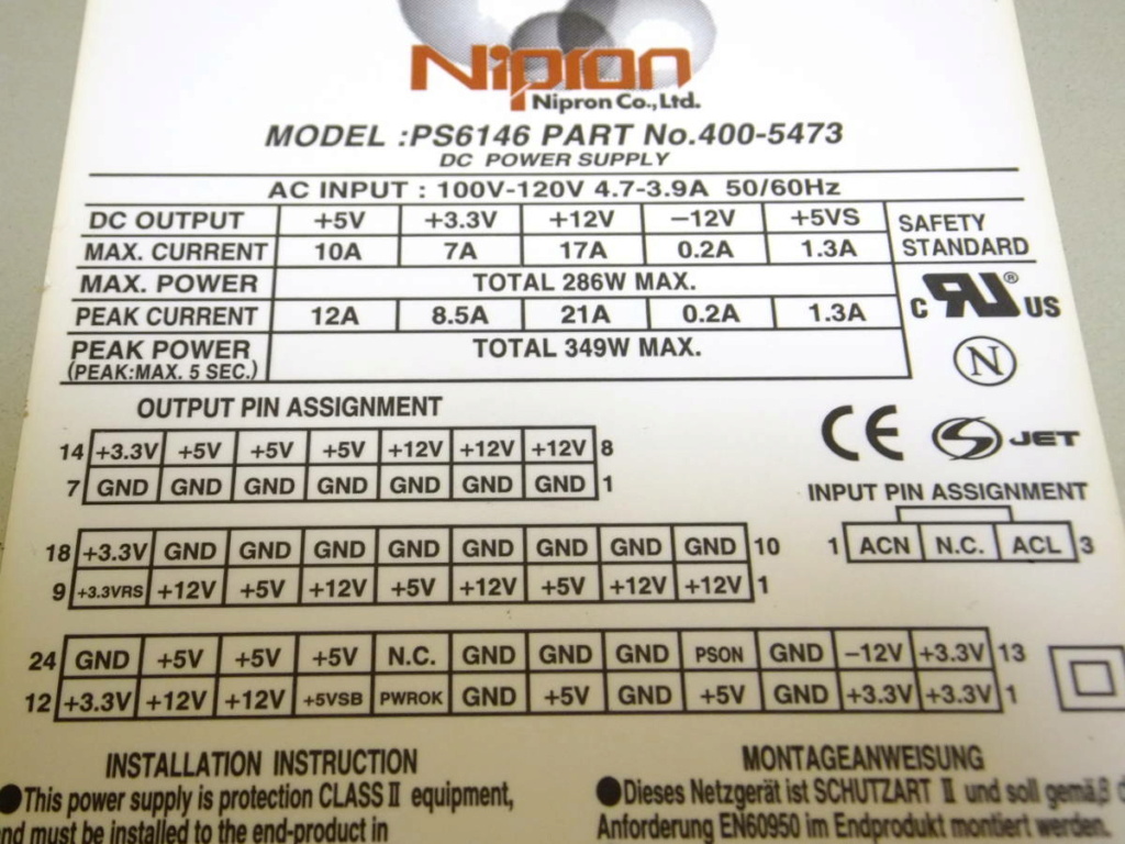

I found yhis unit for lindbergh is it a good PSU, better than SUN Naomi? or SUN Lindberg
