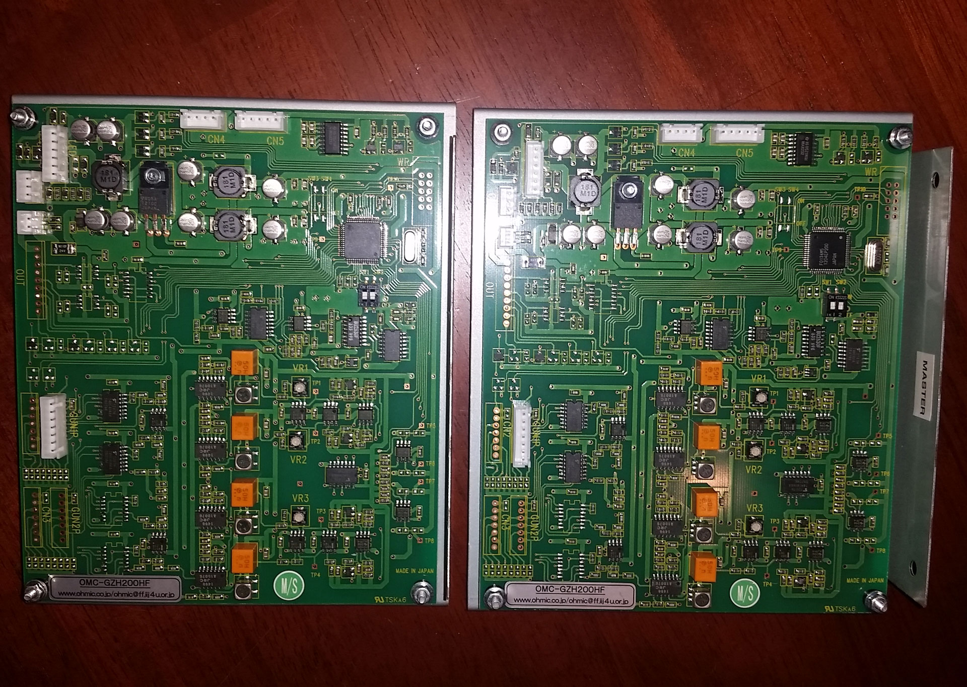

The gun tracking seems to use the OMZ IR setup similar to Sega's that's been in use since the lost world. One difference though is that there are TWO gun sense boards labeled "master" and "slave". I've managed to pickup a pair of guns (those are mine in the picture above) as well as a pair of these Gun sense boards. a cursory look they seem nearly identical to the later revision Sega boards with the exception that each board only has 1 gun connector populated.
My speculation is that they do this for the speed of tracking the gun position, perhaps the older boards could only calculate the position of 1 gun at a time and alternated which gun was being tracked. The older Sega games don't put a reticle on the screen unless you're in test mode and generally it seems very jumpy/laggy while in test mode. During gameplay this isn't noticeable since there is no on-screen reticle; however, GSS has reticles on screen for both guns, and in my experience they track very smoothly and quite quickly. This could be the reason for using 2 boards. Sharing an LED array and they could theoretically track both guns simultaneously, but they would also need to be synced. This would be interesting to know more about; if this is a stand-alone system similar to the older OMZ IR equipment i would mean that it's also backward compatible with all the older games that use that hardware and could be a faster/more accurate system to use.

for good measure here's a photo I snapped of my gun sense boards:
looking over the diagrams I leaned something interesting about the Gun Sense boards... they don't communicate with the Fast IO AT ALL.
they connect to each other via CN5, it looks like it's just a duplicate of the LED output signal. but then they connect directly to the Type X3 via RS232C using CN4.
Or at least the Master Gun Sense board does, the Slave gun sense board goes to a USB to RS232C adapter since the Type-X3 only has 1 serial port.
I took a look around to see if I could track down this adapter and didn't find anything, but here's hoping any off the shelf adapter will work.
The analog sticks and the rest of the gun functions (other than tracking) are all routed to the Fast IO.
there were actually 2 sets of diagrams, one for the 60in deluxe cab and one for "compact" cab I scanned the diagram for the deluxe cab, though the only difference I could spot between the two was size of the monitor specified in the monitor block.
