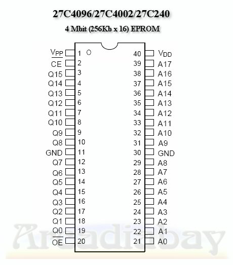

That 27C240 you're using, I'm pretty sure that's only 256Kb not 512Kb. Could be your issue.
Got it :)
Thanks for the help guys. I changed 21B and 27B to Gokujou, finally have this! 8o
My jumpers are: JP5 right, JP6 empty, JP7 right. I borrowed this from a picture.
27c240 are, also, 512k x 8 ;) Basically, 4096, 4002 and 240 are the same exact type, i used them as 4002 while burning with my programmer.
