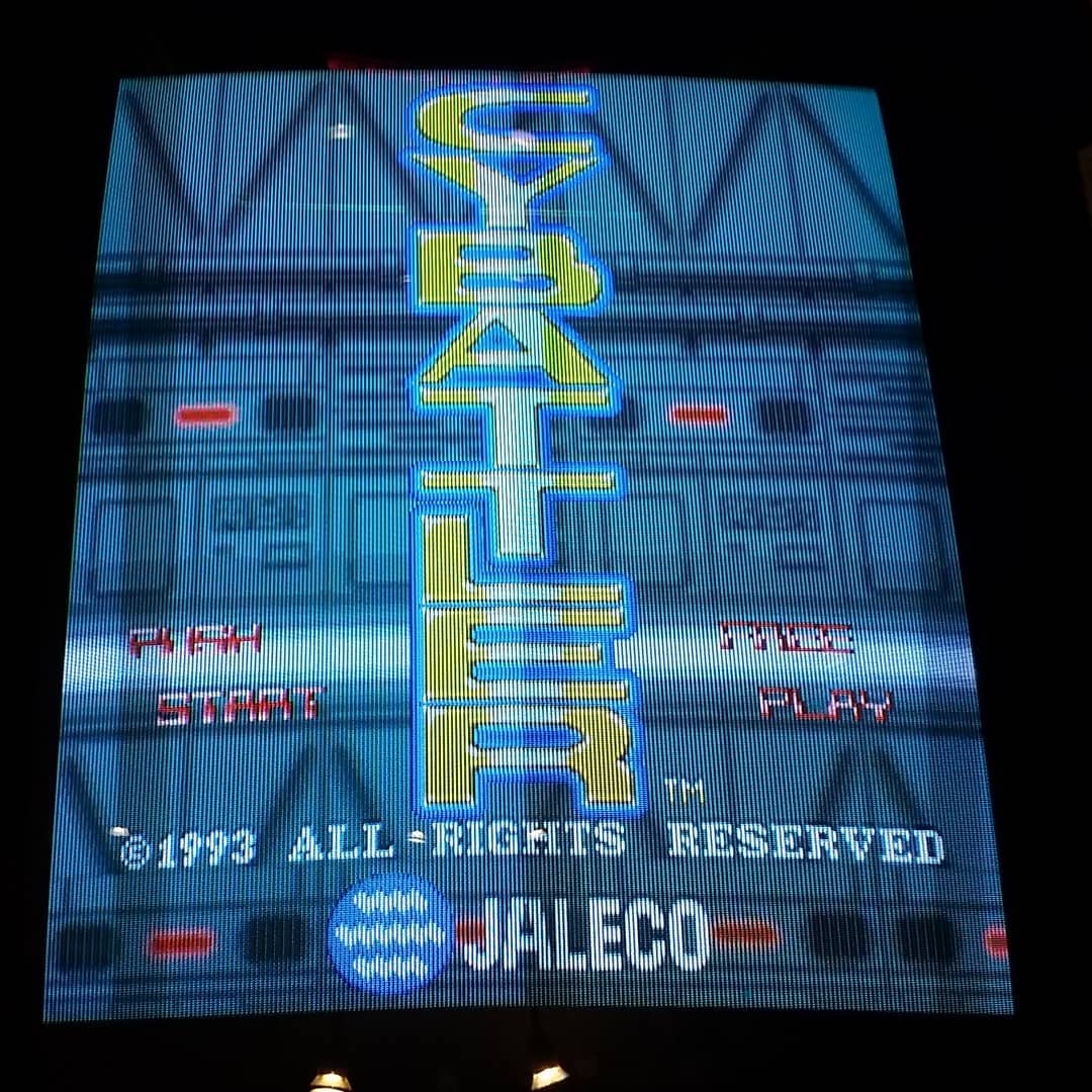

I've done my first conversion patch! and I'm pretty stoked. I'm sure this is a joke compared to the titans around these forums that have cracked some hard games wide open, but I've been trying to get my feet wet with this stuff for a while so this is a big step even if it was an extremely simple patch :) The pointers for using the MAME debugger that you guys have given me really helped and a big thanks to Hammy who suggested I look at the memory map when I got stuck in a situation where it worked in MAME but not on the hardware :)
It uses a Big Striker Donor PCB use the ROMs from MAME but replace ROM #2 with a patched file I created.

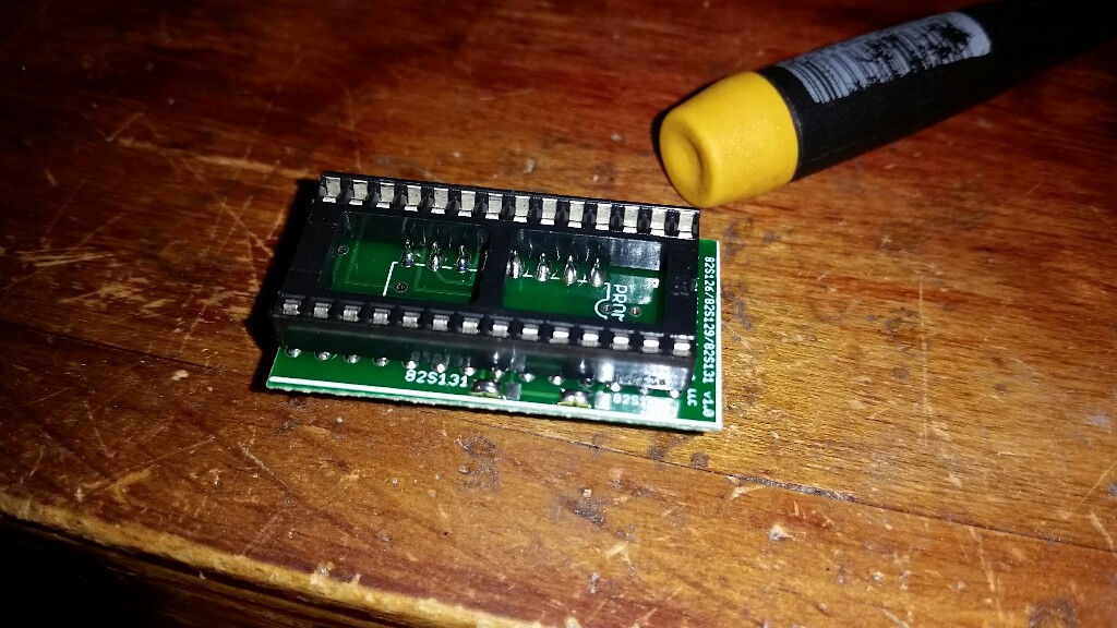

All of the EPROMs are socketed but the sprite priority PROM (ROM [12]/IC155) will need to be de-soldered. These N82S131N are also tricky ICs to find and even harder to find a programmer for. I bought some of these: https://www.etsy.com/listing/244633763/4-x-82s12682s12982s131-bi-polar-prom per Darksoft's suggestion and they work perfectly

I had a few minutes to spare tonight so I assembled and installed one of those bi-polar rom adapters from etsy and it works fantastic. A little ugly but it works.
Out of interest, if you remove that PROM or the incorrect one is installed, what happens?
I'm repairing an original Cybattler and it's got sprite issues. ROMs, RAM and associated logic has all tested ok, so I'm wondering if this PROM has gone bad.
the proms on all of the mega system 1 games are just used for sprite priority. So you can use the wrong one but some sprites get displayed in the wrong depth order on the screen.
Using the big striker prom on cybattler just had some of the background objects blocking your view but otherwise fully playable.

Hammy was nice enough to test out my Chimera Beast conversion and confirm that it runs on actual hardware.
I've posted the patched files for Chimera Beast and 64th Street A Detective Story in the first post.
