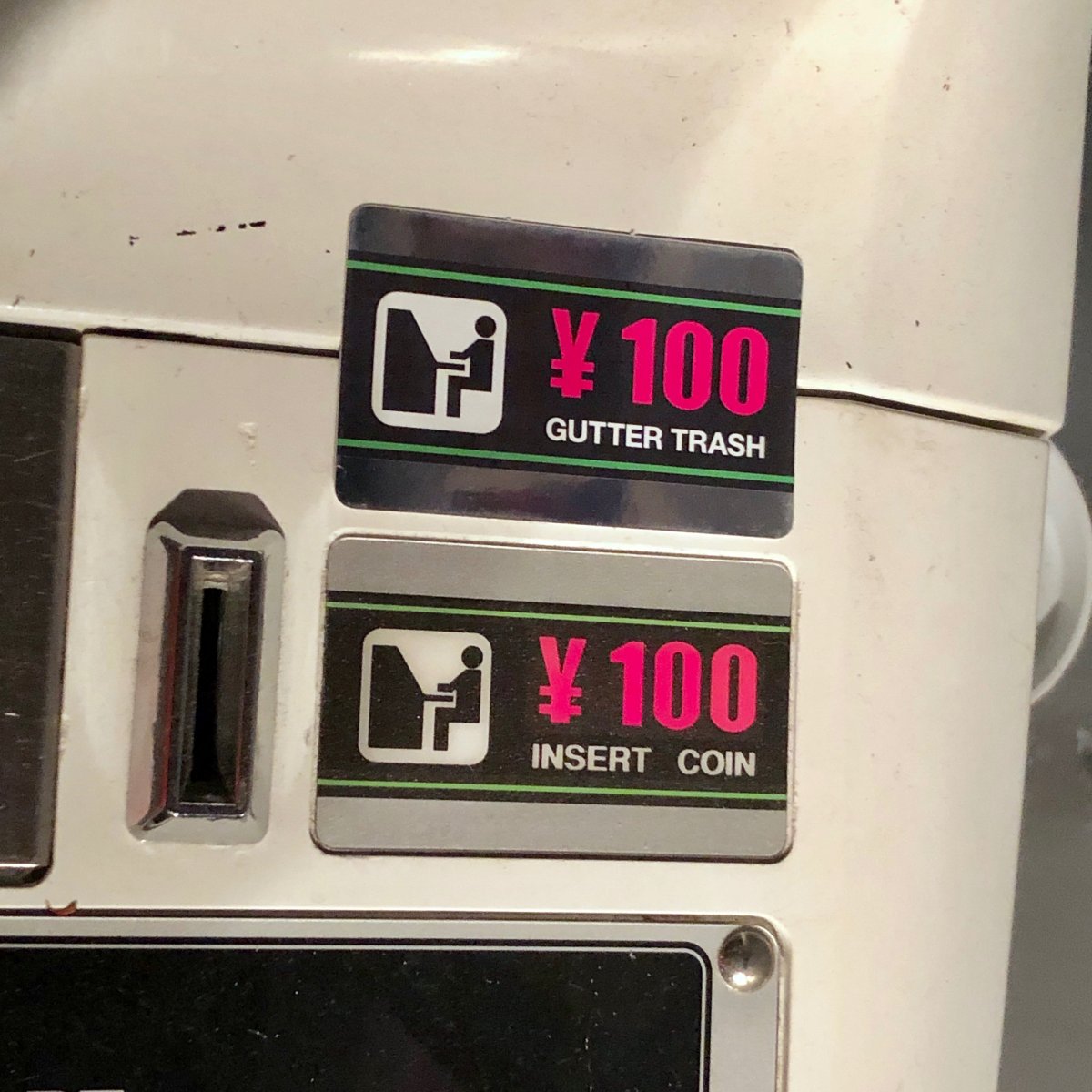

Here, lemme show you something, making this a separate post. The top is my personal sticker design for my arcade, bottom is a stock ¥100 sticker.
First, if you look my parody sticker is more accurate than some repros I've seen. Which is shameful. I'm a professional graphic designer, but it's not like what I did here is that hard.
Secondly, check out the colors. Mine is digitally printed, cheap way to do some joke stickers. The pink is 100% magenta, and isn't bad, but it's darker than the stock pink. But if you look carefully at the green you can see on mine it's got little fine dots in it. They don't print green, they mix cyan and yellow dots to make it look green.
It looks fine! I like my stickers. But if you're repainting your cab and trying to get it cherry and super clean and factory looking it's nice to get parts that match that level of effort.

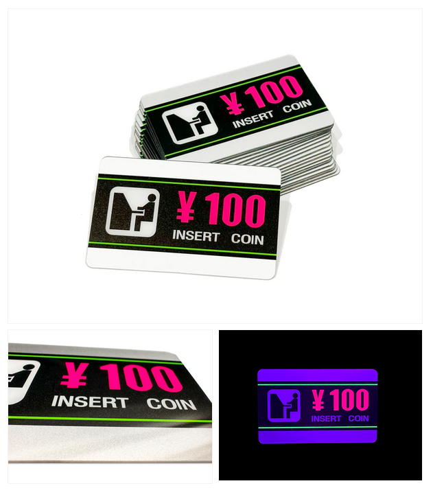

The other big plus of course is Hursit gets the designs right. For something as simple as a ¥100 sticker, which is small and basic, it's really incredible to me how many people fuck up the details. The font is wrong, the spacing is wrong, the little dude sitting at the cab isn't drawn right. It's frankly lazy and sloppy and also super common.

@dos the Screen Print process is really hard and very expensive method. I produced Egret II side arts, Astro City Side arts and 100 YEN stickers. But none of them dont cover the cost still.
So thats why i dont produce the others which i had some plans for others.
But it is fine for me. Im trying to do my best. I love this hobby and thats why i always want to reproduce as original .

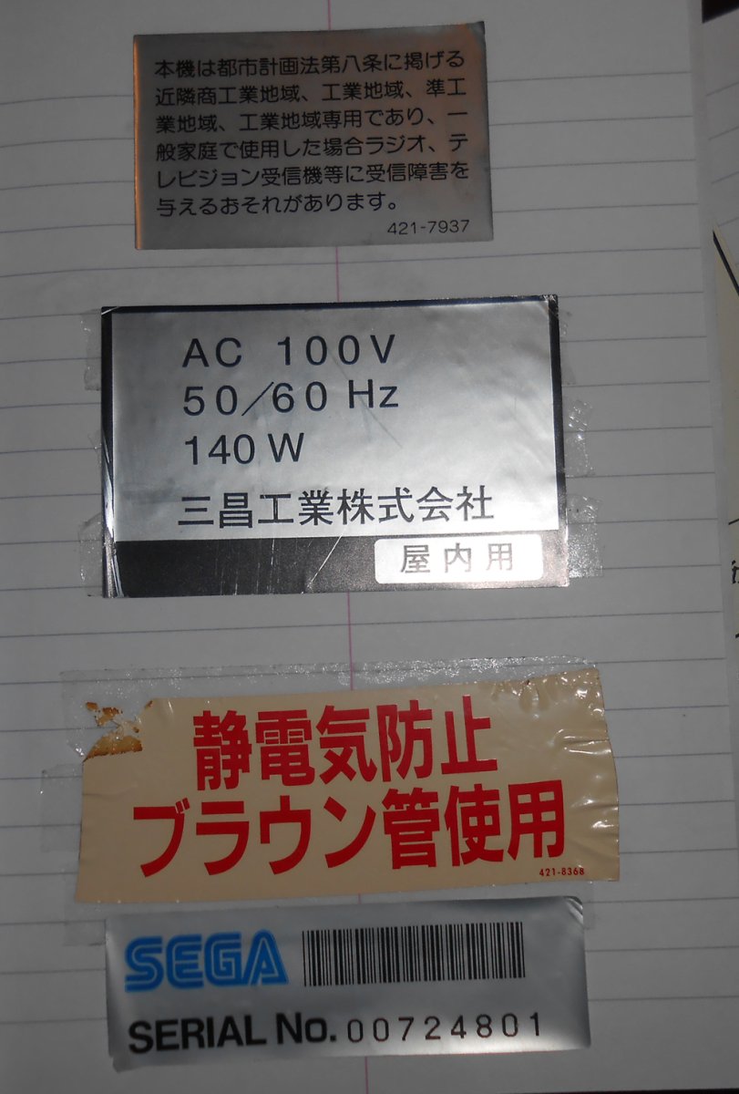

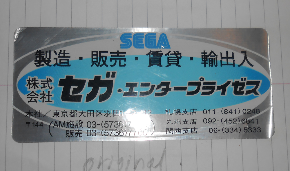

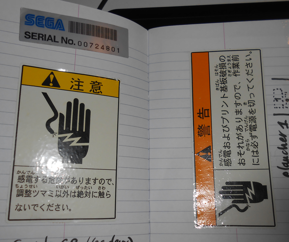

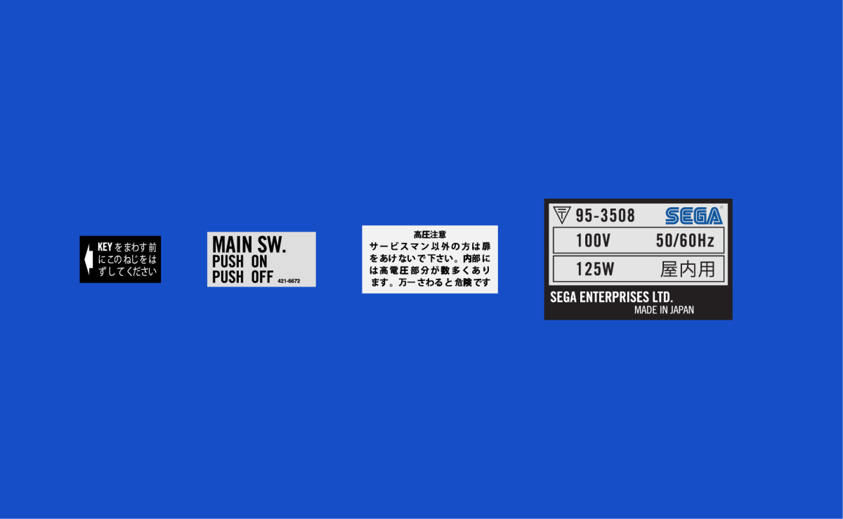

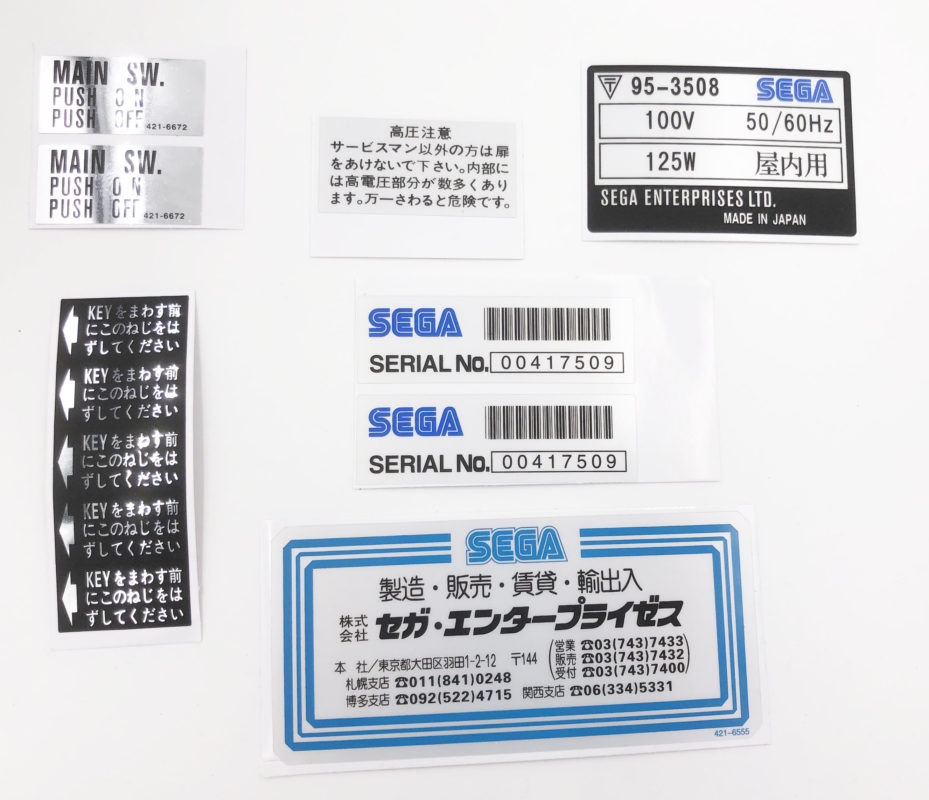

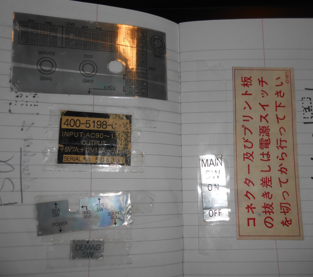

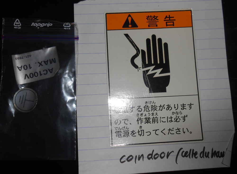

I have recently removed every single stickers from the New Astro, scanned them at 600dpi and restored the ones which was delicate to remove (eg. ''INPUT AC90'' from the PSU or ''CERTIFICATE''). I'm still looking for someone who could reproduce them. Hursit, maybe this job could be for you
Let me know.
Let me know.
Thats good, thanks for your Efffort.
If you can share it i can check what can i do on it ;)
hursit : thanks! 8) Let me know your email and I'll send you the .psd files.

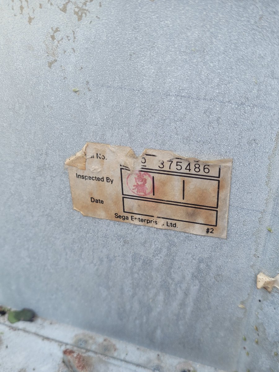

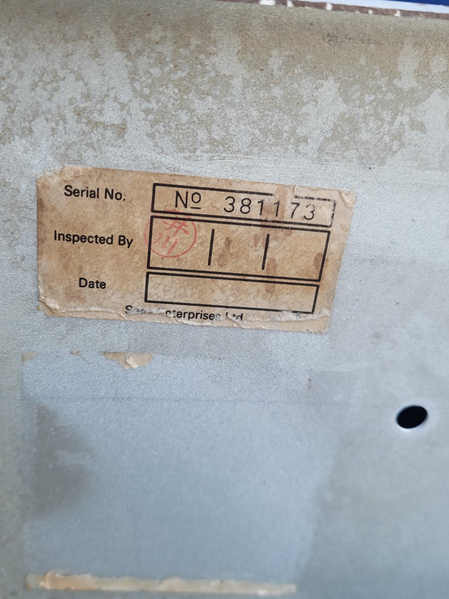

@hursit Or any other talented member, can anyone reproduce these or point me to where I can get them? I get no response from GateNinety
