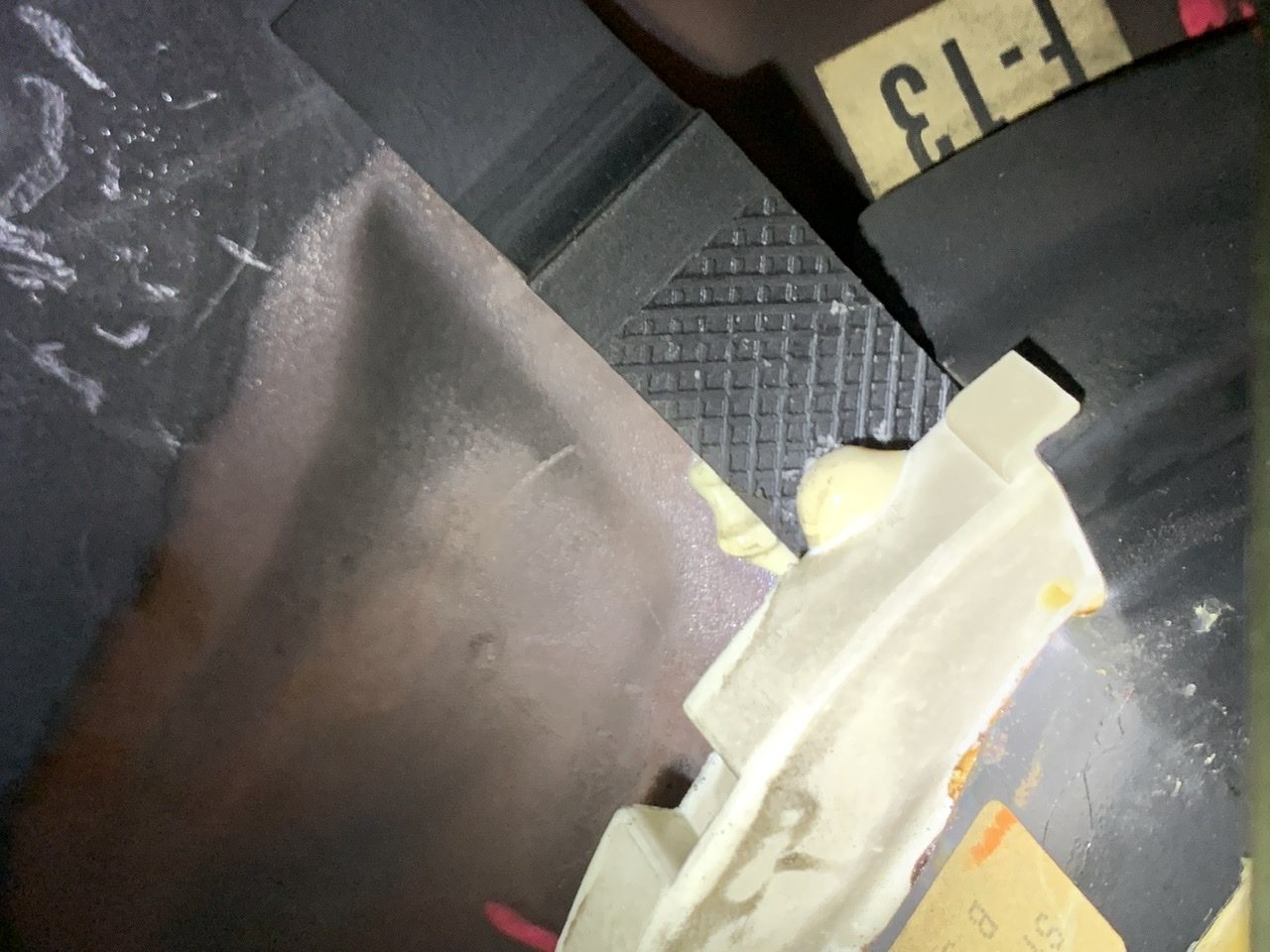

I can only see a small bit of the silicone or whatever it is so might be hard to reach to pick at.
Those are just the rubber wedges. That doesn't mean the yoke is bonded. Undo the screw at the base of the yoke and twist the yoke. If it's just silicone between the wedges and the yoke, the yoke will just come off.
Yeah that doesn't look bonded. Like nem said, loosen the screw, cut the silicone with a razor to separate the wedges and yoke, and then gently twist. Once it's loose, you should be able to pull it straight off.
You are right, sir!
I used a knife to cut into the silicone and twisted as you said. Worked perfectly! Thanks!
