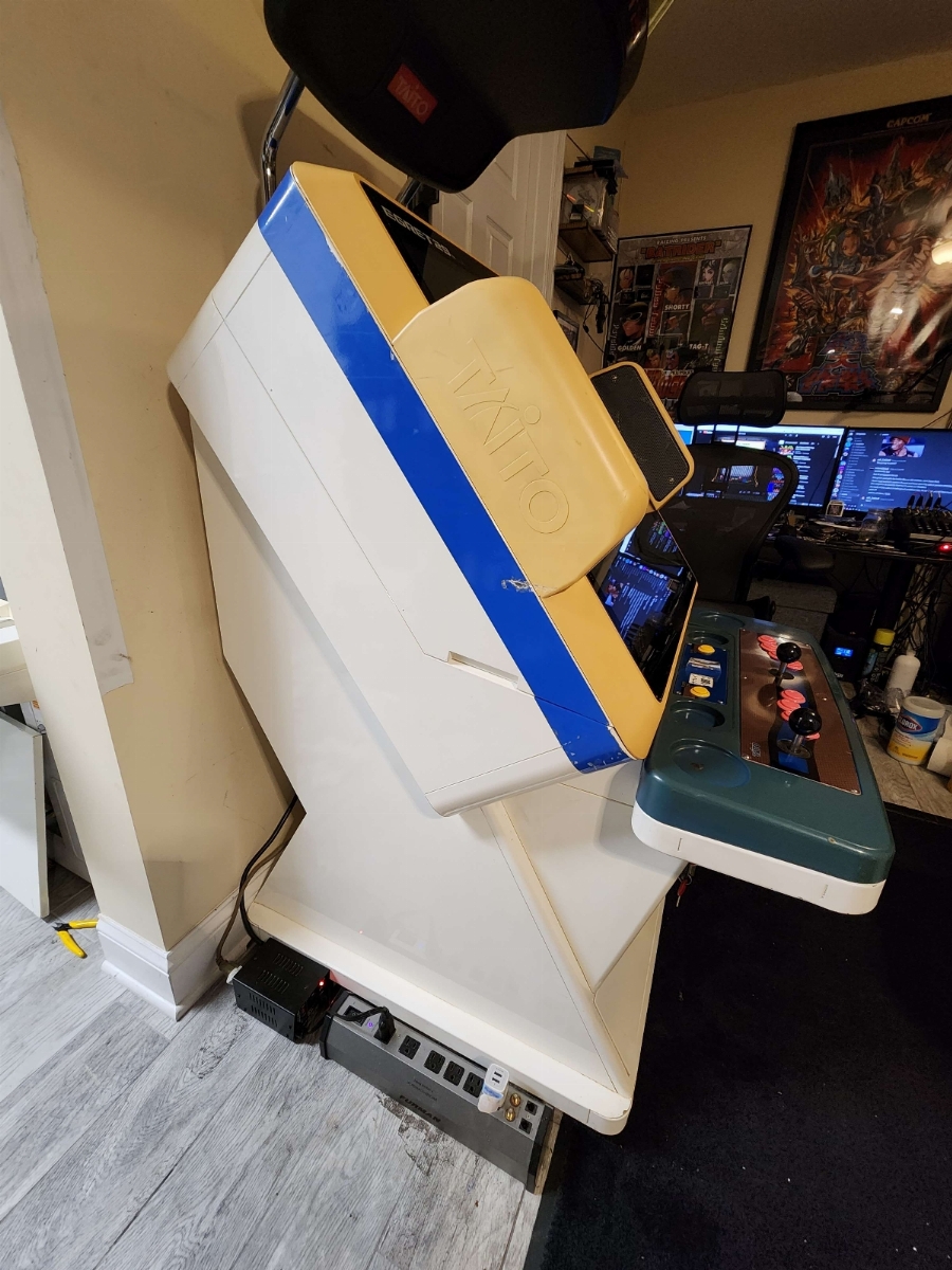

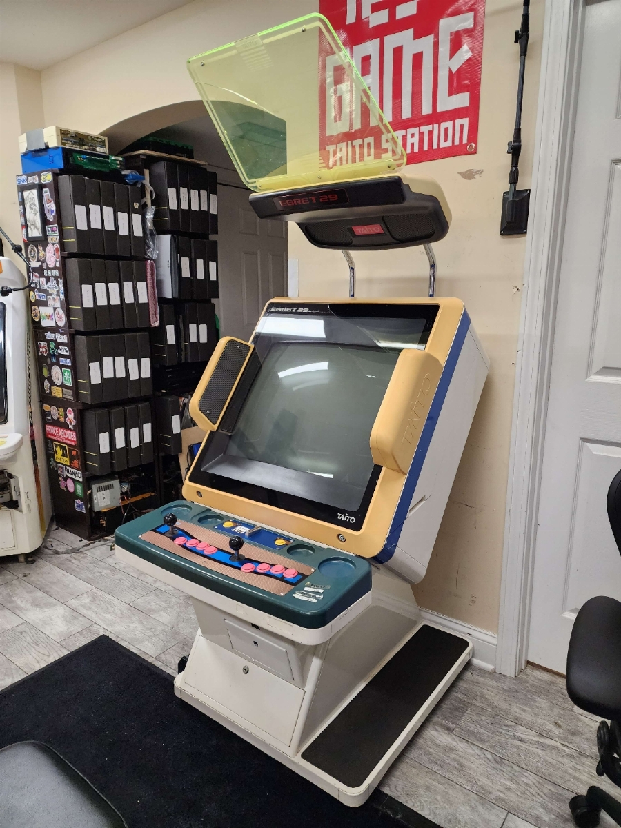

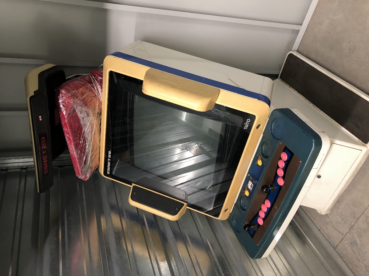

the first picture he sent me was the most recent pic he had of the cab, it had been in storage since 2017, and it was only 1 hour 10 minutes away from me! too good to be true? maybe, but i had to at least look at it. this is the pic.
i talked with him for about an hour and i learned a lot about the history of the cab and how it ended up in storage. he bought the cab in 2003 to play shmups on, then for whatever reason, had to sell his games and ended up putting the cab in storage in 2017. the movers who moved it ended up cracking the yellow marquee and banging up the bottom a bit. they also lost the key to the cab. at this point i hadnt seen the marquee yet but i wasnt gonna let a cracked marquee stop me from looking at the cab. he made it clear that he was very selective of who he would sell this cab to because he did not want it to get mame'd or something silly like paint it black or put an LCD in there. i assured him i will take good care of it, and that i plan on keeping it original and will fix the yellowing on the bezel and make the cp actually blue again. i told him i stream and plan on open up a private arcade for others to enjoy these cabs with me free of charge and i want to make it a place where ppl can enjoy these cabs with like-minded individuals (hopefully this year). he was very happy to hear that so we agreed to meet up on that weekend. in the meantime i decided to buy tubular lock picks so i can at least try and get this cab open . it was the next day after looking at the pics he sent of the cab that i realized that monitor inside is not mounted to the brackets like its supposed to be.... then the extreme anxiety set in... it was very difficult to concentrate on thngs cuz all i could think of was getting the front of the cab open, flipping up the bezel, and the monitor falling out. literal nightmare fuel. nothing i could do but wait and find out when i get there.

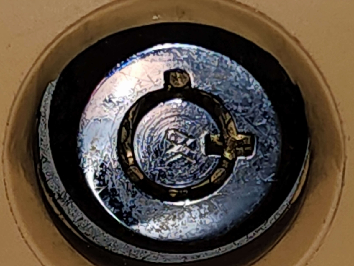

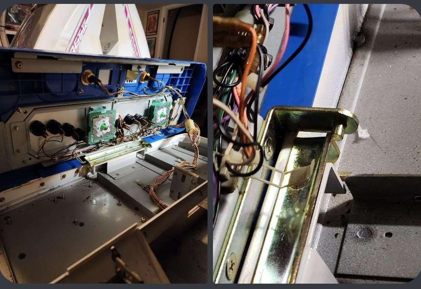

i made it to the storage unit on saturday afternoon, introduced myself and got to work cracking this cab. first issue i encountered was that these locks are not like typical tubular locks. they are 8 pin, which is a standard number of pins, but the 8th pin is centered where the guide notch is. they have the same spacing as a 7 pin lock, but there is an extra pin at the top of the lock. i dont know if a lock pick is designed for this style of lock. i had talked to TwistedSymphony and he told me they are alpha ly-0069 locks and they are 8 pin with the center pin, but i didnt see any picks like that so i bought what i could and hoped it would work. well it didnt. when i attempted to pick the lock i could see all the pins around the guide pin were obviously picked but the top pin was pushed in all the way, preventing the lock from turning. picking the locks myself was a no go. i am still determined and worst case scenario, i am willing to call a locksmith and pay to get it picked, and drill if one isnt available. i still have some options though. the coin door had no lock on it so i looked in there. pretty cramped so i moved on to the back
the back has a cover to access the chassis and neck rings, etc but also can be used to access the back of many of the other locks in the cab. i will go over that in more depth later in the restore thread. it is held in place with T20 star screws. i did not have any star bits, so i carefully used my channel locks to unscrew them enough to get them out with a screw driver. i have been a plumber for almost 20 years now and i am very good with a pair of channel locks on chrome. i did a good job unscrewing without fucking up the finish of the screws or the paint on the cab. once i had the back open, i could see the jamma harness was intact, and everything was there as it should be. the nanao ms8 29 looked like it never left the cab. was very clean tho. at this point i knew i could at least get a pcb in there and power it on. unfortunately due to the rotation mech, i could not get access to the front hood locks from there. so it was back to the front i go to try to get access to the back of the locks through the hole in the front from the coin door.
sadly i did not take any pictures while i was going thru this process, we were in the front lobby of the storage facility dissecting an egret 29, i was living in the moment.
i managed to get my arm up in there and got my hand on the back of the lock for the left side of the hood. i could probly get a small pliers in there if i had to, so there was some hope. i repositioned myself to get to the right side and it was basically undoable with anything in my hand, because of the coin chute getting in the way. "fuck. ill probly have to call a locksmith" is what im thinking right now. so i move back to the left side and try to feel how it connects to the cab to lock in place. i push up on it and i can see the hood raise about a half inch, which really makes me think this thing isnt locked at all.. the lock's guide part was pointed in what would typically be in the unlocked position, but this is a lock with 2 notches in it, so i dont know for sure its unlocked or not until now. i do the same thing on the other side of the hood. this hood is definitely not locked! awesome! i lift the hood and am SOOOO relieved to find the rotation mech is still intact! my suspicions were correct tho, that there were absolutlely no wing bolts holding this monitor in place and this tube had just been suspended by the rotation mech for around 5 and a half years. props to Taito for designing something so tough. there was no sag or nothing. i took the 2 wing bolts i borrowed from my egret 2s and fastened them together. i also took my jamma voltmeter and hooked it up to the jamma edge. i plugged in the cab to the stepdown transformer and plugged that into the wall outlet. i had the Seller power on the cab for me in the front (i wasnt aware of the power switch in the back yet cuz the bottom lip of the cab was so dirty the old worn sticker for the switch kinda just blended in with the grime. volt meter read 4.8 volts , should be safe to plug a board in, so i had him power it down. i plugged in the soul edge board i bought with me that i use for testing and had him power it on again... 5.18, i told him to power it off and before he did we heard audio and he said he saw a jumbled screen. i go back around to the front to look for the voltage adjustment pot on the power supply. i couldnt see it at first so i unscrewed the 1 screw that was holding it in place and pulled it out of the cab. once i located the pot behind the large connector on the psu, i reinstalled the power supply and adjusted the voltage down to 5.0 with the help of him rattling off the numbers as i adjusted on the fly. once i got it to 5v i looked up at the screen and it was just garbled shit. it looked like h hold issue, so i took my long pot adjustment tool and fiddled with the h hold adjustment on the remote board. a little change, not as bad, but still messed up. i increased the h size, and boom, came right in focus and everything, just a little small. i let it sit just playing for about 10 minutes as we talked and celebrated.

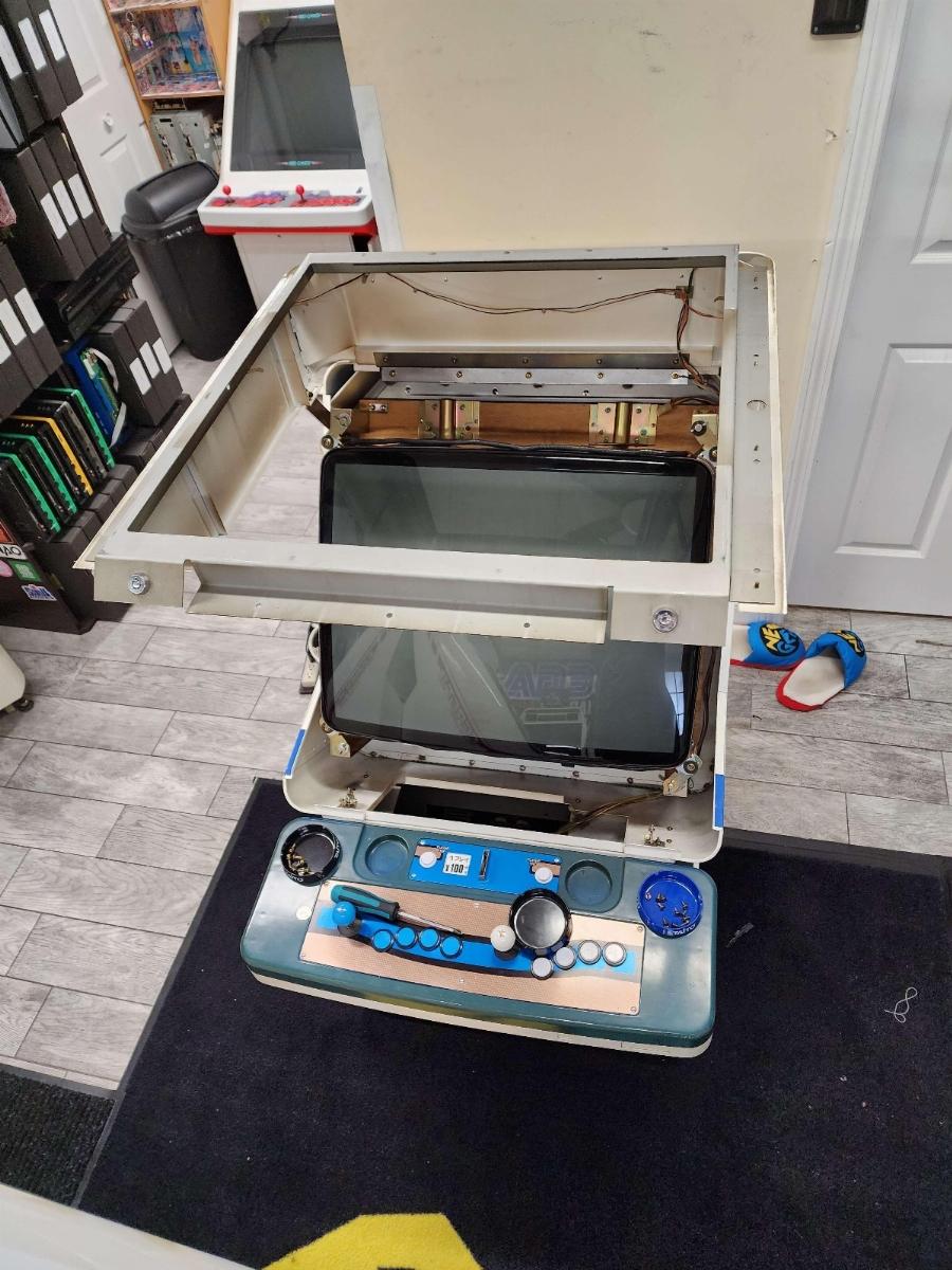

i didnt put the cab together right away from the topper-separated state it was in. i started with addressing the locks in the cab so i could more comfortably connect games and test the monitor. the tangs on most of the compartment locks just hold up against the lip of the space so you can just remove the nut that holds the tang in place and pop out the panel with the lock on it and remove it comfortably outside. i would like to get keys for these locks but its not a full complete set, so i will just buy my own locks and save the originals "just incase". for now i just placed some regular locks i have keys to to keep things accessible but still together. i havent addressed the hood locks, but dont feel an immediate need to at the moment. once i had access to all the compartments of the cab i got to work on replacing the chassis. i found it easier to get at the anode cap if i rotated the monitor to tate.

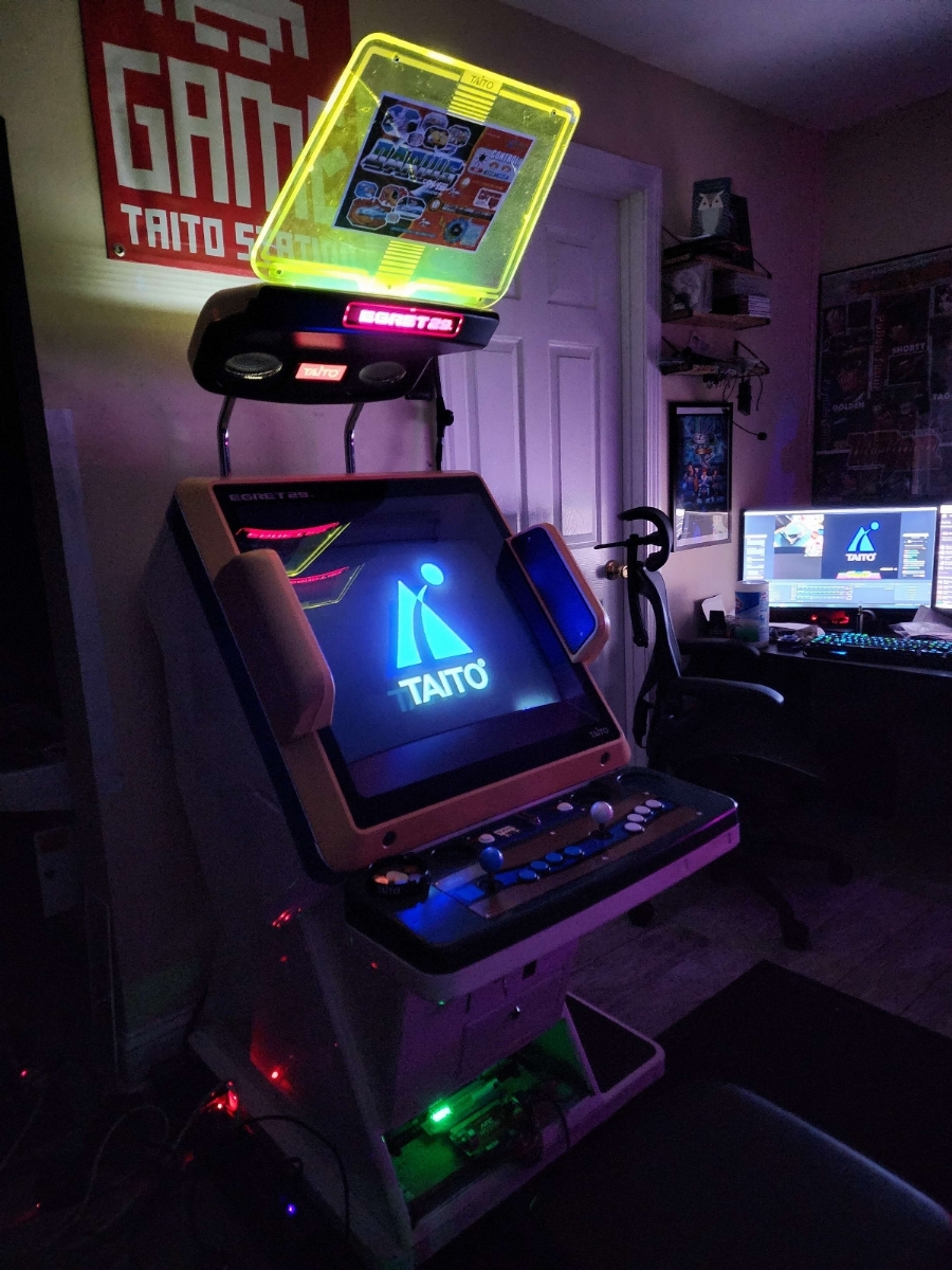

did some more work on sunday and monday. its a snow day today and i am going to enjoy some quality play time on it after building a snowman with my niece. here is a synopsis of what i did over the past 2 days:

next thing i had to do was seperate the CP assembly from the base of the cab. this is where i really started to realise the true craftsmanship of this cab. upon opening the hood, you will find a latch behind the control panel. slide that latch to the right and the cp assembly will disconnect itself. you can the npull it upward as if it were attached at a hinge and it will rest itself, freely, on a bar at the front lip of the bottom CP metal base. then i proceed to disconnect the wire harness connectors, p1 and 2 start, and a ground wire in order to fully release the CP assembly from the cabinet. it really is an assembly too. it has many parts to it and really is a marvel in engineering from both a mechanical and aesthetic standpoint. after swapping buttons and a little bit of cable management i was left with one slick looking panel setup.

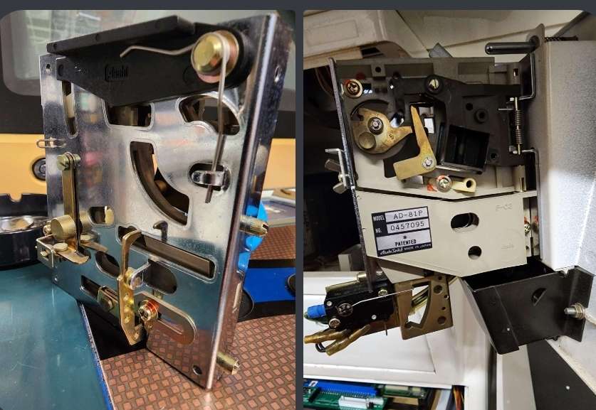

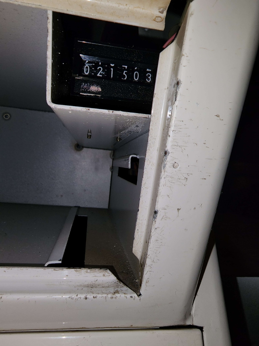

next thing i hadn't tried was the coin mechanism. would it work the first time? of course not. fortunately i know how to adjust them to take my tokens with relative ease. just like everything else on this cab, the coin mech is gorgeous and overbuilt. ill just let the picture speak for itself. the coin switch broke when i pulled one of the leads off so i had to replace that as well. upon testing the functionality, i was pleased to hear it has a very pleasant sounding trip down the chute and into the metal tray. and boy lemme tell you... this mech can inhale coins. i can send multiple coins down at a time like a slot machine and it recognizes every one. i bet it has something to do with that extra brass on the back of the mech and the one scalloped side of the coin entry.
while replacing the coin switch i use the coin drawer as a place to store the screws and nut for the mounting and ground wire respectively. i took that time to look at the coin counter and it had a little red sticker blocking the 100k and 10k digits. i pulled it off and saw a number that really wasnt worth hiding at all; 021503. id consider that low plays.

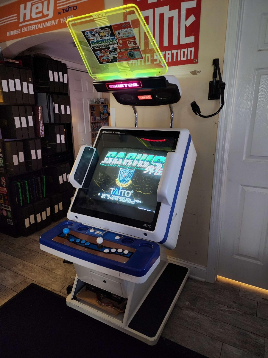

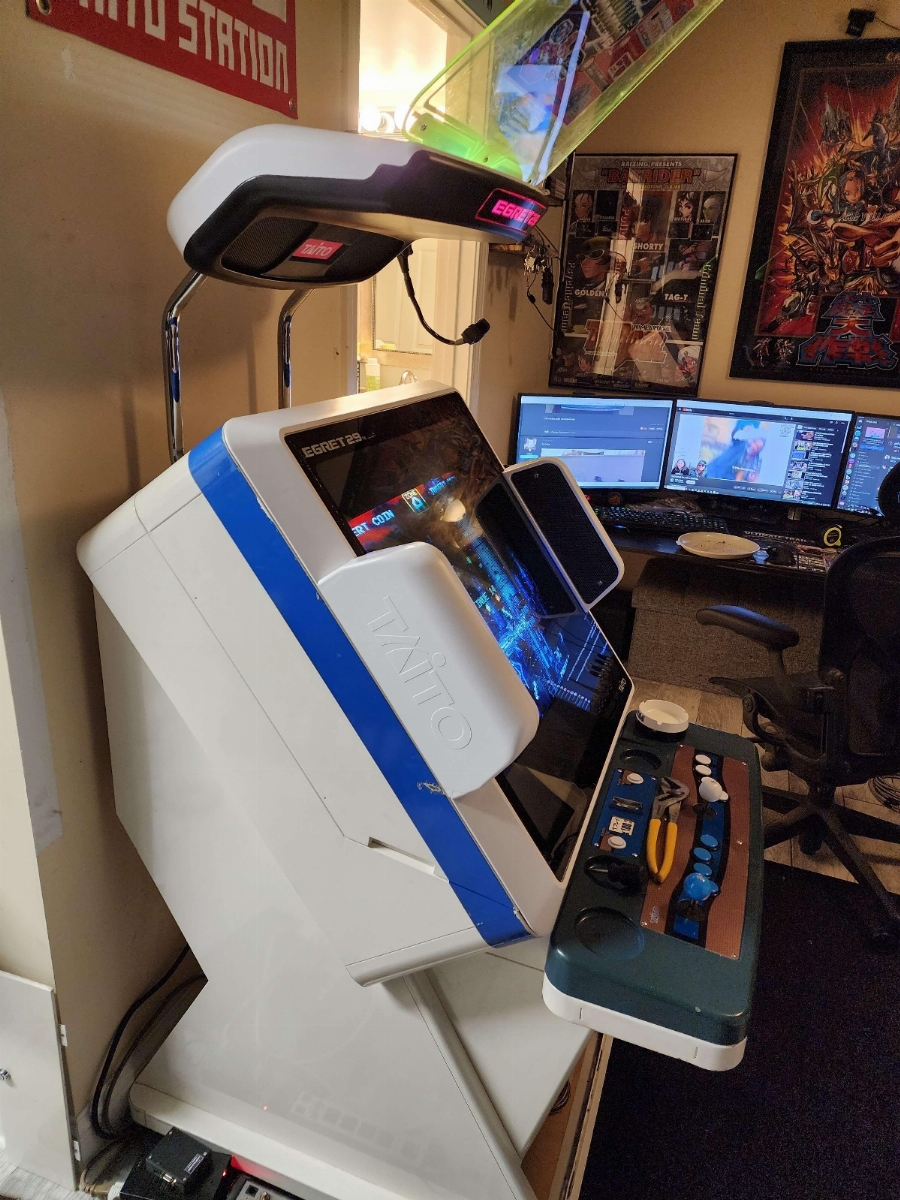

once i got it all back together, it slowly came back to life. that was easy! dear Lord, its gorgeous!
so now i have a 100% working Egret 29. i have spent a decent chunk of time on this cab now and i am starting to get consistently to H on Darius Gaiden. i have purchased wing screws and once they come in, i can take out the allen screws in it now and easily rotate my monitor. that will let me get at the anode cup more easily so i can hopefully smoothly make a video of how to swap a chassis in a cab and perform the recap of the psu and chassis on stream next weekend. hopefully a recap will solve the scrambled issue the original chassis had. if not, off to sharp it goes!
here she is all lit up..

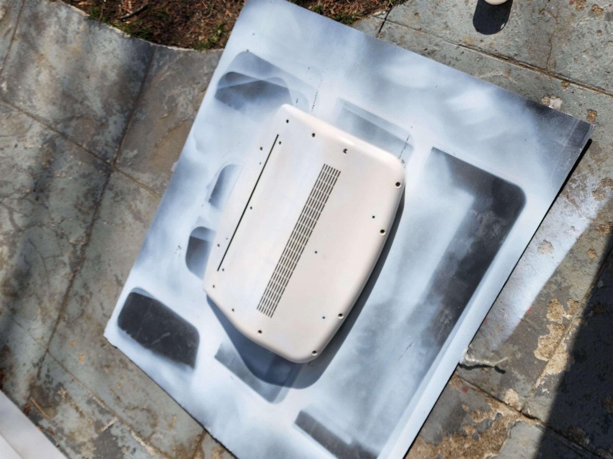

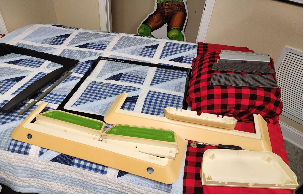

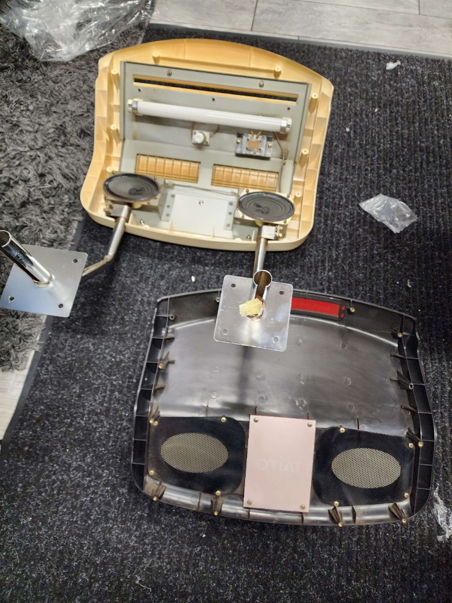

finally had a couple days where it was above 50f and less than 60% humidity. decided to paint the plastic pieces while i had the chance. i first started off with the yellow parts. they were pretty bad, but nothing some vinyl die couldnt handle. i followed in Twistedsymphony's footsteps and went with the duplicolor hvp105 https://www.amazon.com/dp/B00098PO22 . this stuff is very easy to use. follow the can instructions and have at it. took a good 3 coats to cover 100%. i used 3 full cans and a little extra out of a 4th to cover all the while plastic.
first, i had to disassemble everything and get it ready for paint. i noticed the inside was pretty dirty but i ran out of paper towels after prepping the plastic components for paint. i did what i could with just cleaning wipes, which did all the area under the plastic so i can tackle cleaning the inside better at a later time.
next i had to tape off around where the side speakers mount. they have black paper on them which i was not trying to replace, as well as threads for the screws that hold the speaker grille in palce. i used green painters tape to cover the area and carefully used an exacto knife to cut 2mm from the perimeter of the inside flat edge of the speaker mount face. i learned this after i did my first and second coat. it came out flawless afterward and the speaker grille hides it 100% no matter how close you look at it. i did an extra 2 coats to all the parts then carefully brought it inside 30 minutes after the last coat to let it fully dry. i didnt want any bugs or debris getting in the paint.
pics were taken after the 1st or 2nd coat.
after a few hours of letting it dry, i fit everything back together and was very impressed at the results. the finish is super durable and looks damn close to the original paint. for those wondering about the speckles on the control panel thats bits of dried paint from my arm and hand because i sprayed paint all over it while holding the parts to get coverage in the harder to reach spaces. it brushed right off.

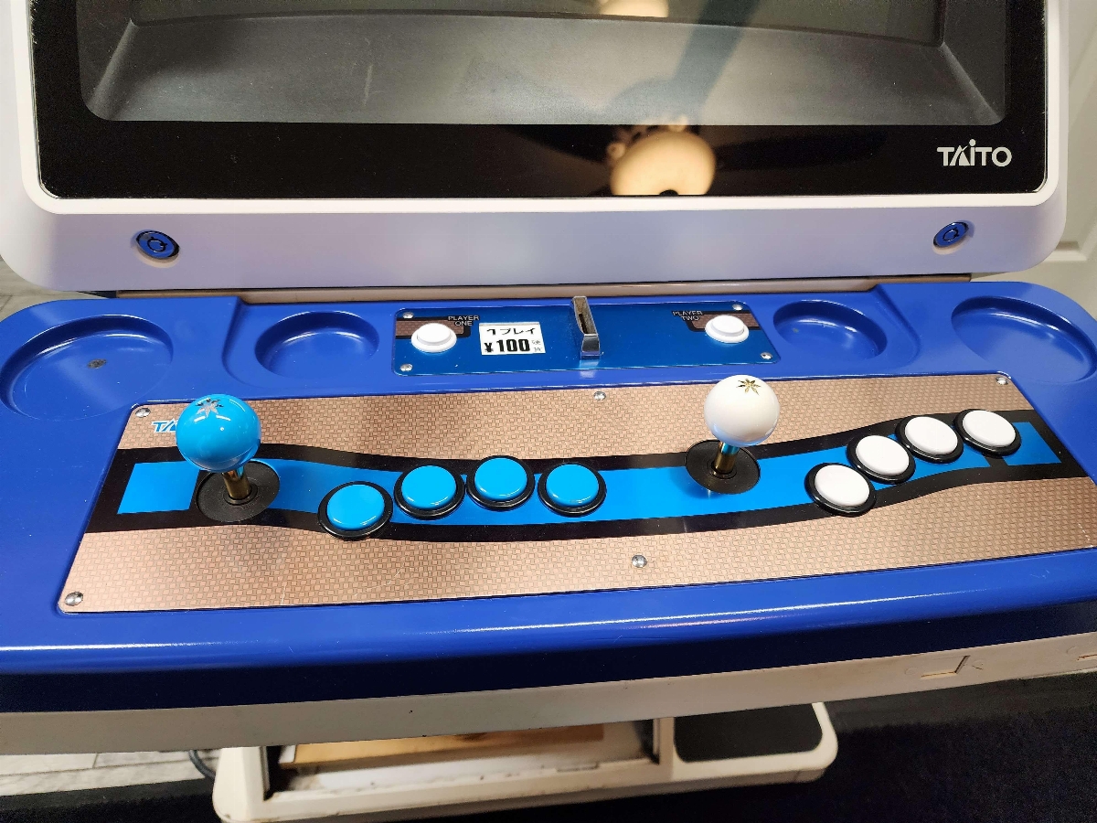

After seeing the cab so clean, i had to do the control panel as soon as i could. there was a short window i had where i could do the painting a few days after i got the white done. i used the same Rustoleum blue satin enamel as twistedsymphony did. it took longer to dry than i thought it would before reading the can but it is fully dry after the full 24 hours. im not 100% sold on the way it came out. the durability is not as strong as i had hoped, but it is by no means terrible. its good enough for now and i can easily sand it off and do it all over again a different way, with a different paint, or apply a clear coat of some sort. for now, i will run it thru a stream session and see how it holds up. yall might not like it, but i left the cigarette burn on it. i rather like it as it serves as a reminder of what this cab once was, and as a personal reminder of me quitting smoking cigarettes and eventually vaping. i consider it the little bit of ashes that the phoenix rises out of. its a beauty mark to me.

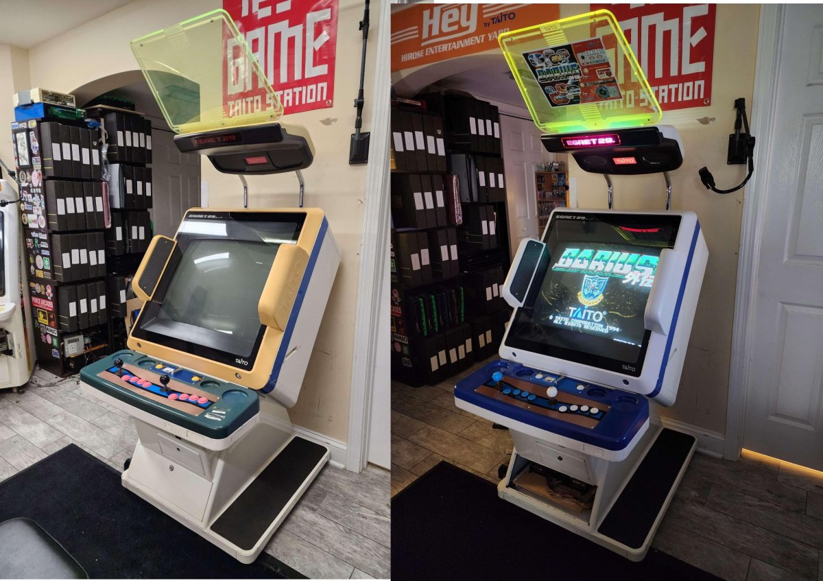

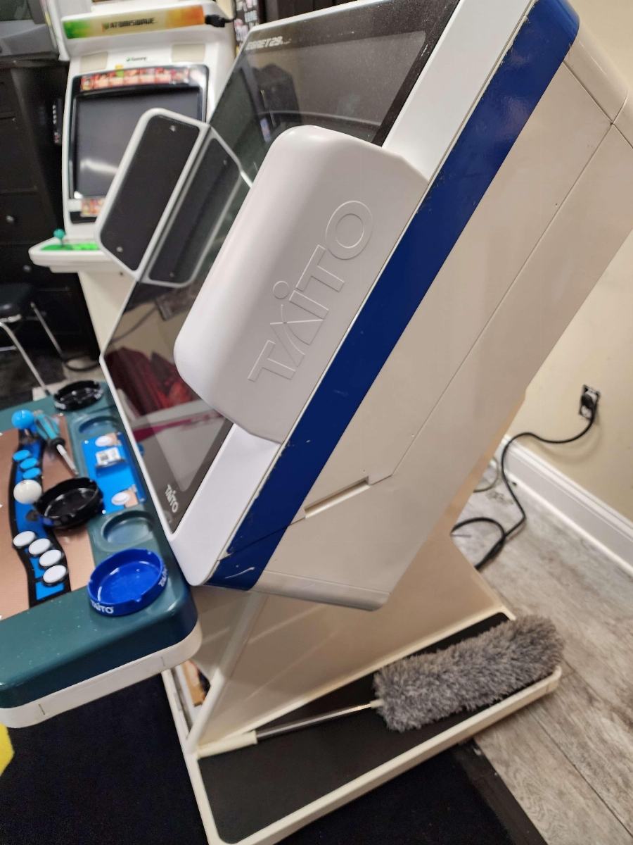

here is the journey from A to Z. this cab cleaned up real nice, and i am thrilled how it came out. the longer i look at it, this picture looks like one of those "can you spot the difference" pictures lol. (i still have the bottom panel, i just leave it off for better ventilation. these cabs are basically a hotbox)
i had to decompress that image down but i really wanted to do a side by side. here is the full scale pic of the finished cab.

congrats on getting a great and weird cabinet. since LY0069 locks and keys are very hard to find a close suggestion is to use LY1153 locks, taito's set that they deployed on the Egret II. They'll even sell you new ones.
