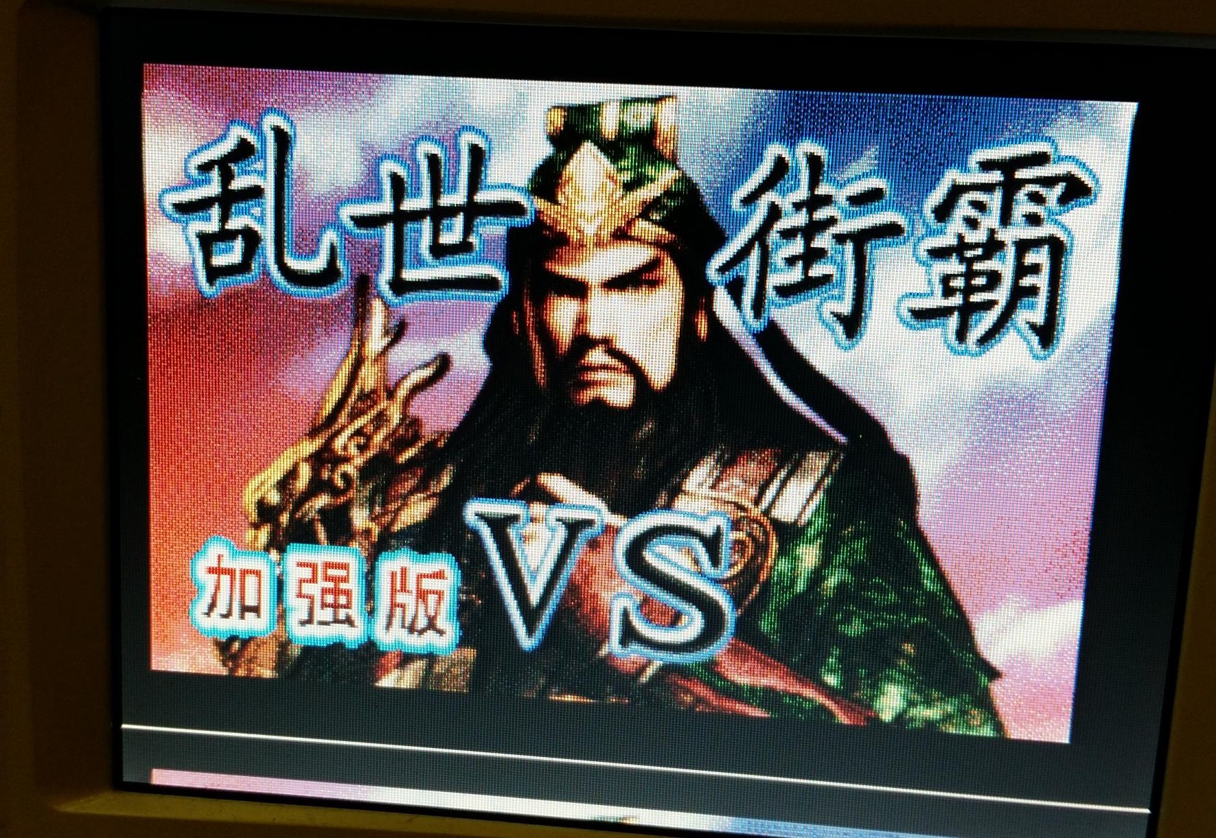

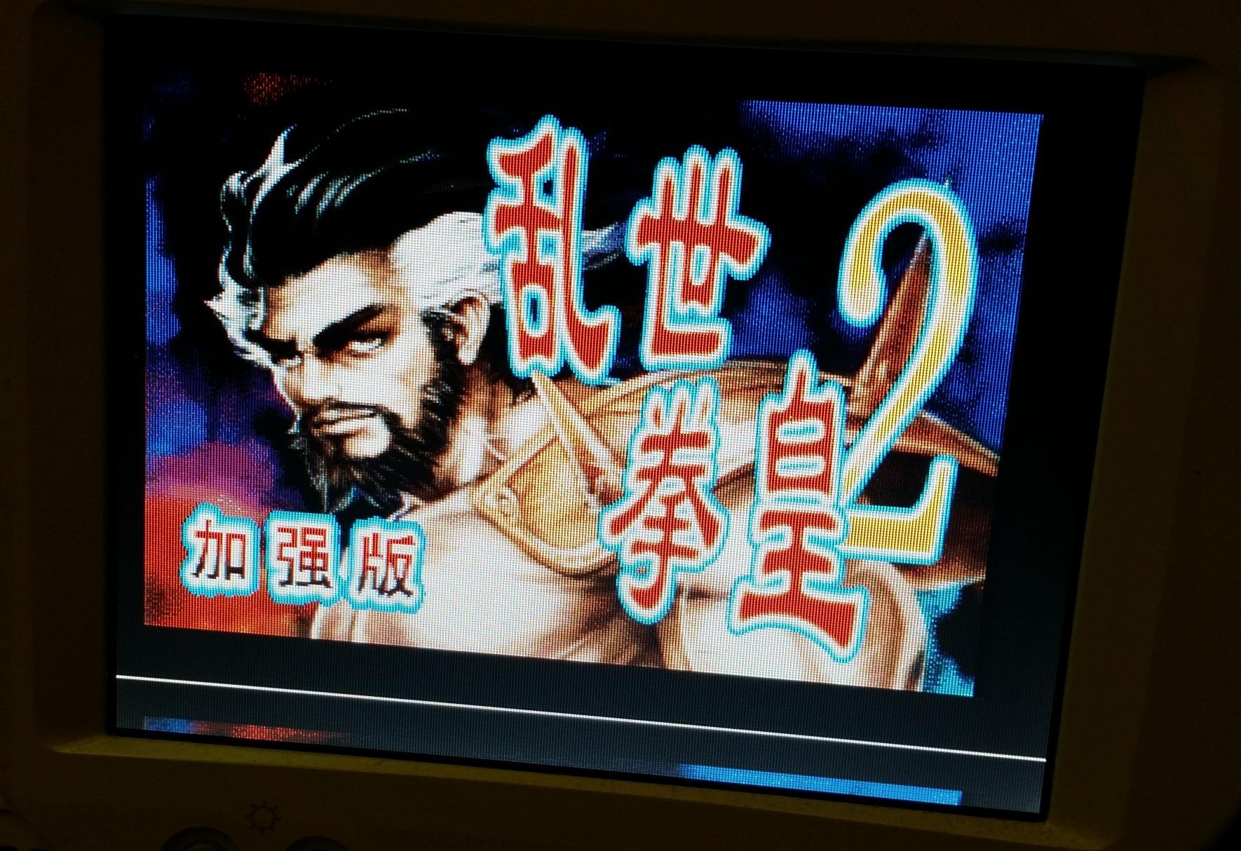

Hey All,
Can anyone help with a english tranlation on these 2 screens???
Thanks,
D.

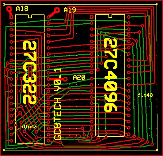

Hey mate,
What software are you using for PCB design?
Looks like MS Paint?
=O
I ask because there's a few free options out there which will auto route for you and do a very nice job too.
Frank has been usind easy EDA and I've been using Eagle. You just need to make a simple schematic and it pretty much does the rest of the work for you.
I wasn't meaning to be rude. Just wanted to check if it were a serious post or not.
With trace routing you need to be using straight lines and 45 / 90 degree angles. I'm very surprised that PCB passed fabrication audit, even more surprised if it works.
If you need help, yell out. :)
I was trying to be funny :/ -- no offense intended @GC8TECH
None taken.. its free software.... BUT i had to buy a file converter to be able to get the right gerbers out to get the pcbs made.... It IS very MS Paint like.. BUT its easy and simple and fast.. I do enjoy hand routing PCBs...
T.
For High Speed PCBs.. i would aggree with you!!.. But stuff like this will be fine... I've made quite a few chip converters.. and they all worked :-).
I never post jokes like that... I was hoping for more positive feedback though :-P
D.
If you gave another software a go you could get a way more professional/neat looking PCB.
My first PCB was designed in Eagle with no prior knowledge of the software and it turned out great. It's very user friendly but I'm still learning as I go.
I think the biggest question here is Why the hell not?
If you're happy, I'm happy. :)
But... If you want to improve your results there are people here willing to help.
Great.. I would apeate any help you can give :-) @oneleaf86 Is eagle free?? Sounds a good choice if its easy to use.... :-)
If you both want to hep with V2 of the PCB.. That would be great.. as i'm sure there will be somthing not quite right... May hit PGM cart plastics as well.... Need to do all that testing.. then i can do the next revision :-)
T.
