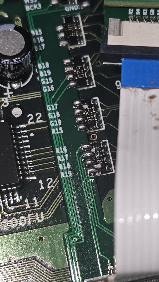

If you could also send a picture of the QSB install - with as much detail as you can get, that would be helpful.

I snapped a quick picture of the qsb - I got to thinking. If there's a short right here On the qsb and resistor network, wouldn't the color issue be present without the ribbon cable attaching itself to the FPGA board?
Right now with the QSB board on here, the color is fine through JAMMA. The moment I connect it to the FPGA board the color issue shows up. Does that mean the short is somewhere else down the line?

Yes, the short is at the resistor networks, unplugging the ribbon won't make any difference on the analog output. The short is not at the fpga side. Use continuity setting on your meter and test each connection to the one right next to it, none of them should be shorted. I would start on the red connections.

Just to be clear, when the ribbon cable is connected, the analog output gets the color errors. When the ribbon cable is not connected, the analog output is totally fine. if the short is at the resistor network, wouldn't the analog be having color issues as long as the short is present?
I will be checking each for shorts thoroughly. Thank you!
You didn't mention that part, in that case the short is on the cps2digitalav color connectors. Can you take a picture of the digital av?
