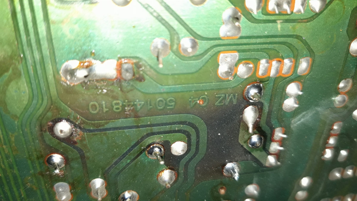

Hi to all, the screen of my arcade has been damaged and unfortunately, I didn't take photos of the board beforehand. As a result, now there's a burnt resistor on the neckboard, and I can't identify it. I downloaded a manual from the web, but it doesn't describe the same model I have, and the resistor is missing. Does anyone happen to have the same model to tell me which resistor is R212, or to take a photo?
My model is the following:
Chassis: Hantarex MTC 9000
Board: MZ 04 50144810
Neckboard: ZG 04 50144840

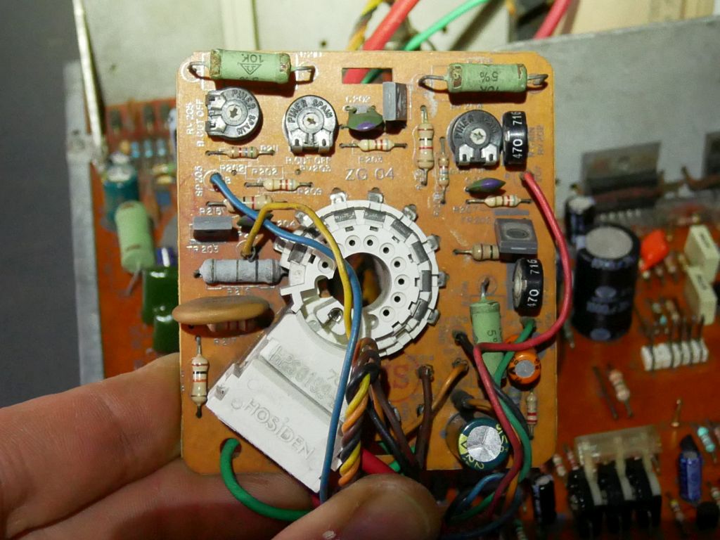

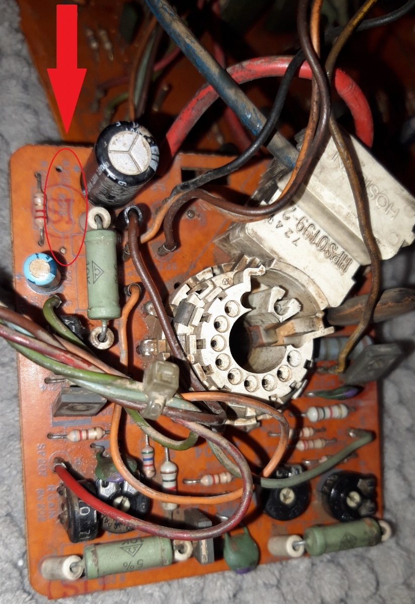

Can you take a picture of the neck board? I can look through my chassis later this week to see if I have a similar one.
This is the back of the neckboard:
This is the board:
And this is the model of the main board:
Thank you very much for your time. I have searched a lot across the internet and I cannot find it. I believe it is made in Italy.
Thank you! Now I can continue the restoration. Of course, I still have a way to go, but the important thing is that I've unstacked. At the end of the journey, I will update with the result in the present thread. Thank you again.

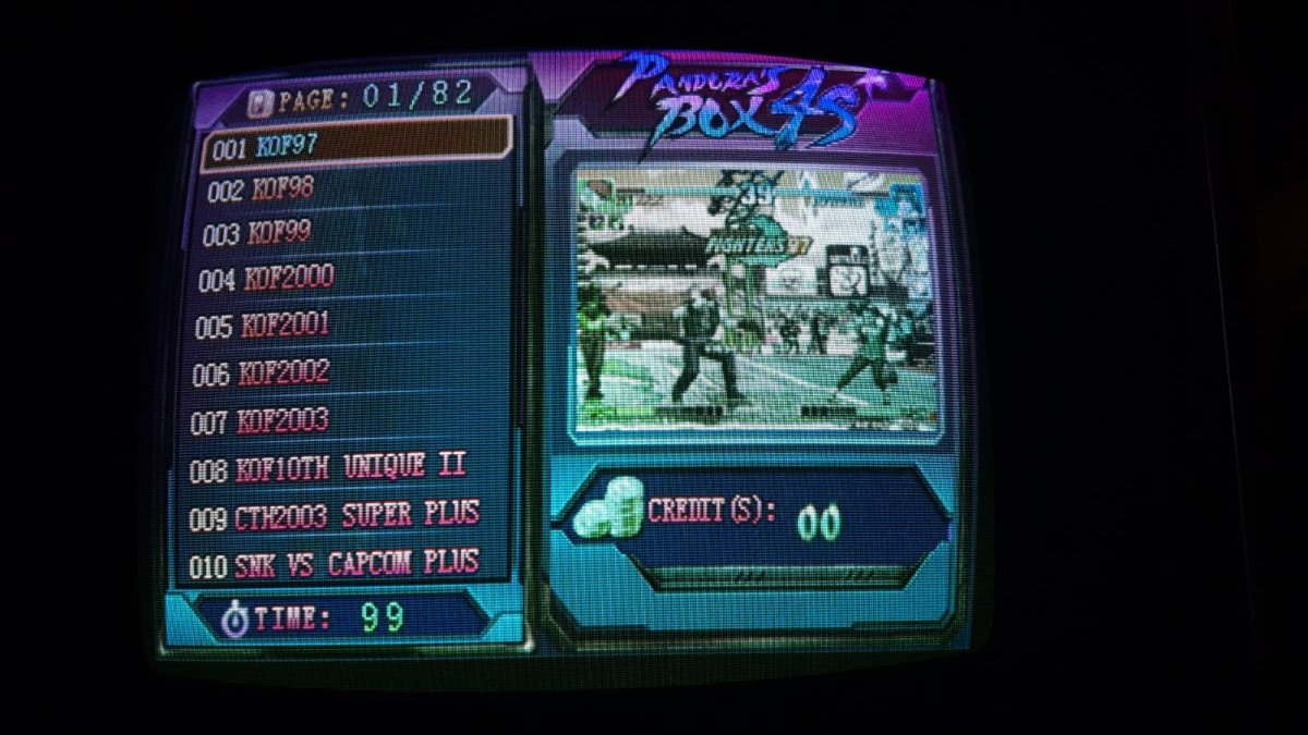

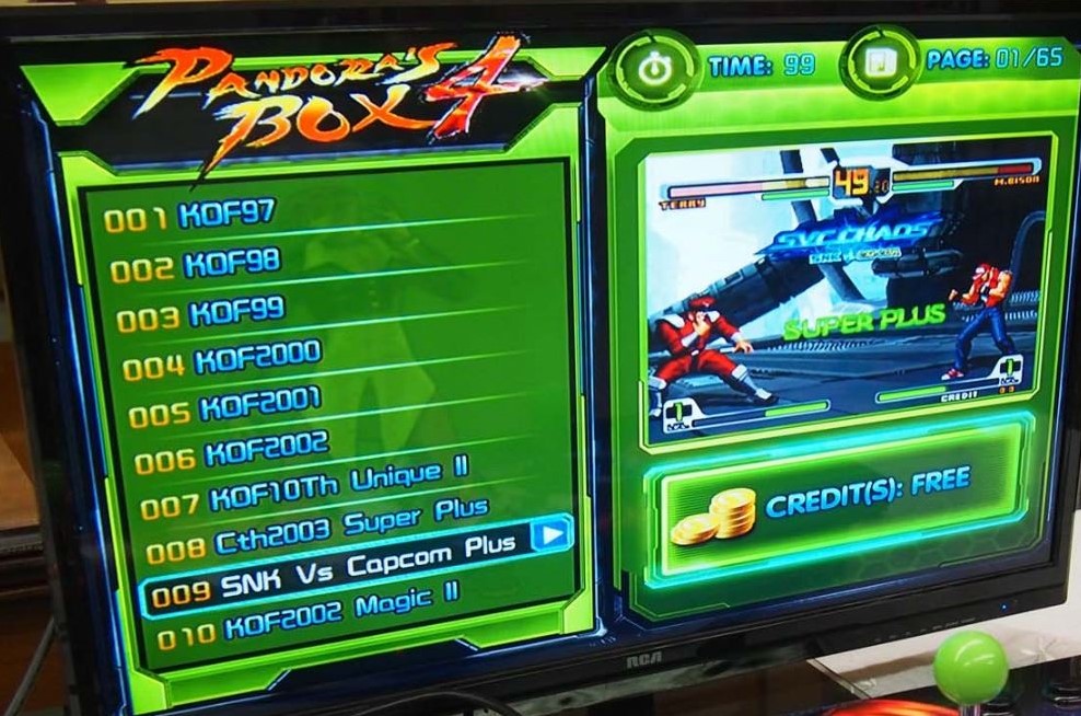

I installed the resistor and it worked, but the colors are completely wrong. My problem now is that no matter how much I turn the color potentiometers, the change is minimal or none at all. I am sending a picture of how the colors should be and how they are now.
Has anyone encountered this before? Turning the potentiometers and they don't work?
I am also sending two pictures, showing how it is and how it should be.
Can you pull up a color bar test screen from one of the games?
Does the screen demagnetization / degauss work?
Theoretically, it demagnetizes. I hear it every time it turns on. I also did it manually, but it still doesn't help. However, you're right. That's the problem because I tried with a speaker from the stereo and the bottom part fixed. I need a degaussing coil, and logically everything will be fixed. Thank you again.
