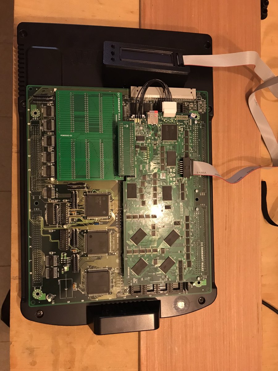

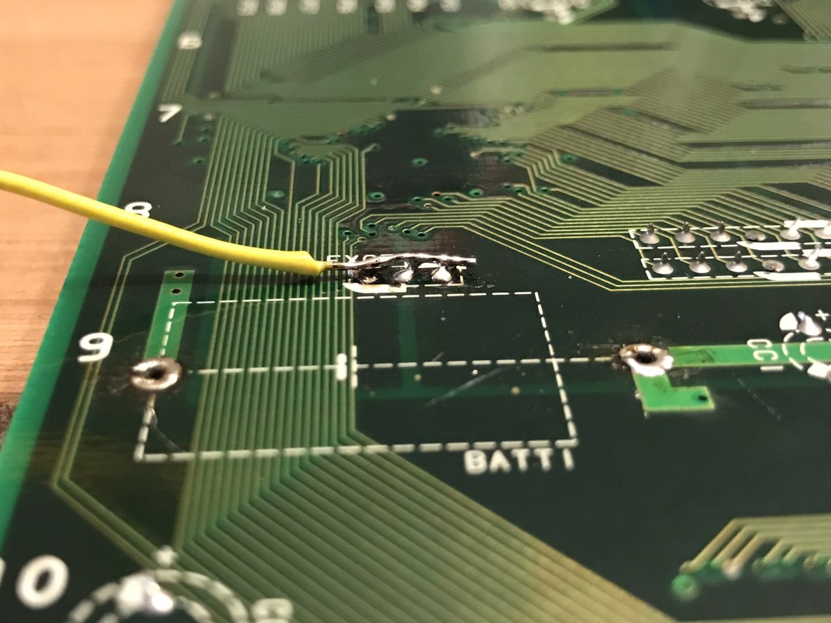

I forgot to mention but 2 weeks ago I was able to seamlessly install the Darksoft CPS2 Multi (version 2) on my SFA2 B-Board (that I had to suicide after proper and complete testing by simply desoldering the battery as well as making a shortcut on the EXC5 3-pins to make sure that the security key was flushed out) without any issue. And the CPS2 system directly worked :)
Worth mentioning that I also used a 32Go SHDC from Samsung (cheapest and smallest SHDC option I could find on Amazon in 2023 from a well-known brand - about 7EUR with Prime Amazon) and there was no issue with this SD Card either. I used the "guiformat.exe" program to properly format the SD Card in FAT32 (that's the program I have been using for the past 15 years or so to format any of my SHDC cards that I use for my various other consoles e.g. NDS, N3DSXL, SNES/SFC etc). I simply drag and drop the base package with all ENCRYPTED roms because I wanted to be able to play the Punisher game (CPS1.5) which was ported onto the CPS2 system (I really wanted that specific game also because I knew it was leveraging the QSOUND technology).

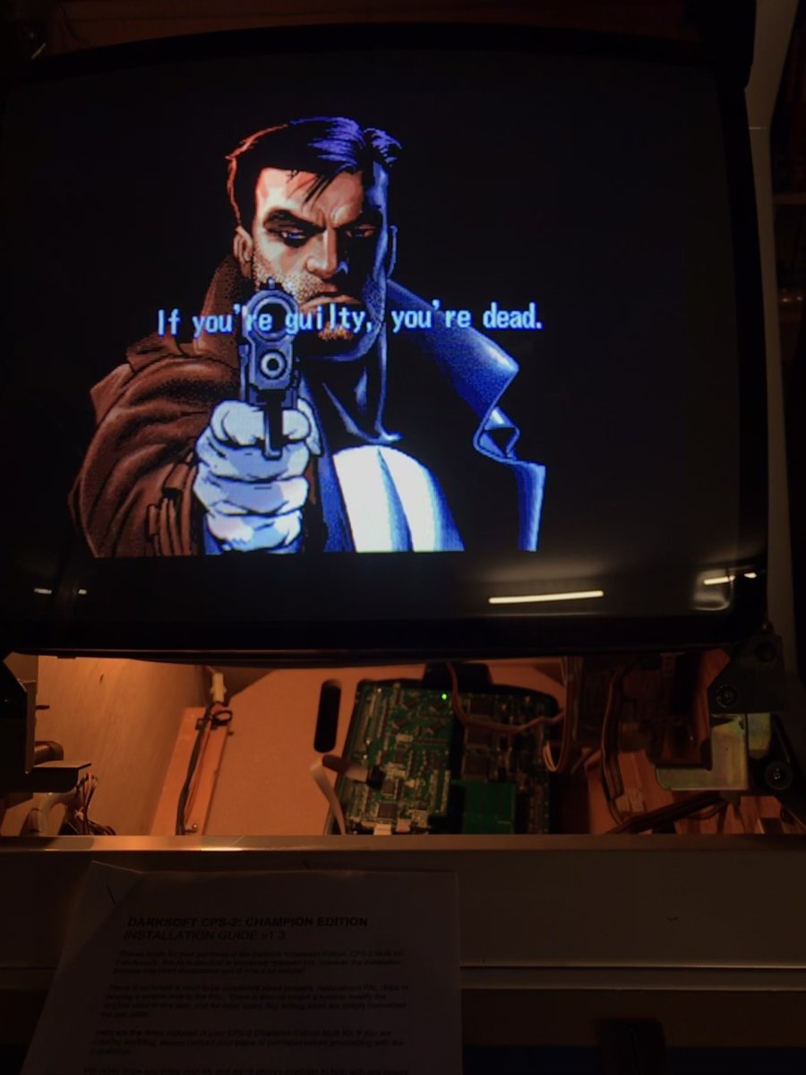

Last but no least... I just wanted to mention that when the system booted for the first time the cabinet screen was completely blank and the remote controller was completely blue with no text showing whatsoever... and I thought it was not working... then I touched the buttons on the remote controller and after a couple of seconds (circa 10 or 20 seconds), a game was launched and fully functional... so I thought it was not properly working initially ; I actually thought that the extended cable was at least badly mounted or not properly manufactured (I read some posts about this specific issue), but the actually "problem" was simply that the potentiometer on the Darksoft CPS2 Multi board just needed to be adjusted to show on the remote controller the actual game list... I believe it was completely turned on a extreme position. So if you have the same symptoms, do not panic, it may just be that the brightness of your remote controller needs to be adjusted.
