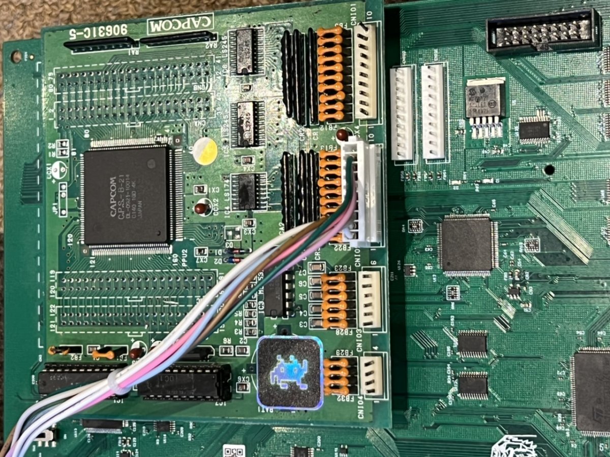

So question/problem re addons. I want to buy the kick filter board and kick extension cables, but have an issue due to c board I used. It is very hard to plug in cables as c board is right up against the connector. I currently run my kick harness off the c board. Can I still run from c board to filter board and also the player 4 harness from c board to filter board. Please see photo, hopefully it will demonstrate what I mean
I'm pretty sure you can just use the ones on the multi as well.
