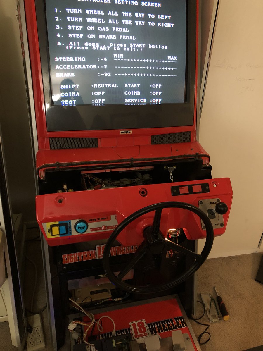

A calibration note: For the OR2 wheel, I get better results in FTS if I don't calibrate all the way to the extremes. If I just fill up about 4 bars on either side, I get much more responsive steering.
I did note when trying to calibrate for more sensitive braking, that my car did brake automatically without my foot on the pedal. I don't know if that was due to actual analog jumps or if it's related to the reported analog issue. When I calibrate brake all the way to the extreme, I don't get this behavior in-game.

I noticed after setting free play, I could hard reboot (don't have battery backup so have to netboot again) and the configuration stays in memory. In this scenario the automatic calibration screen at first boot does not come up and I can play. It might be worth a shot to see if that gets you playable. So first boot, set up calibration, maybe put on free play, hard reboot (netboot again if needed) and maybe it will be playable.
For me what I think I'm observing is that no inputs except service/test work in-game after exiting the test menu.
This aligns with your findings because you're going to test menu to verify inputs are working. I don't know what to make of your initial unresponsive inputs, though, as I don't have that issue anymore and was blaming it on a missing coin meter.

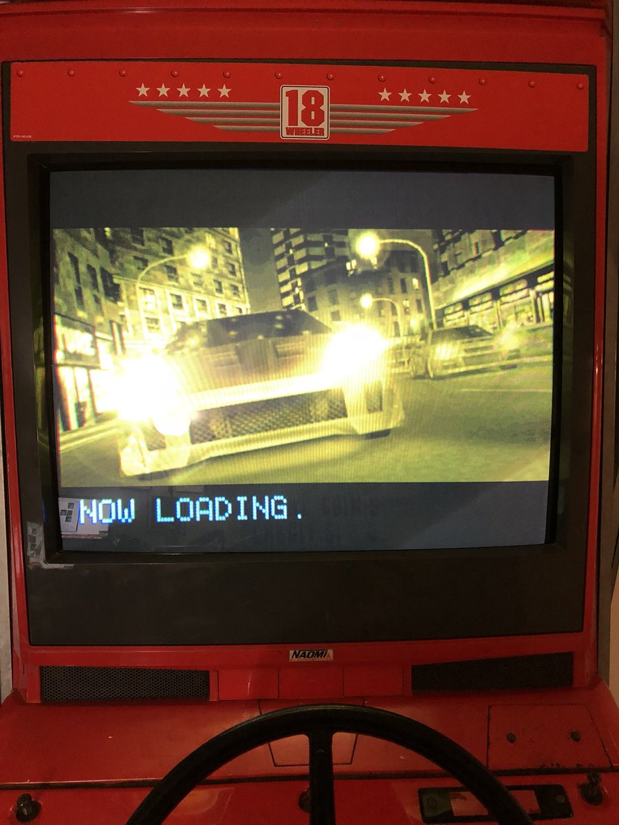

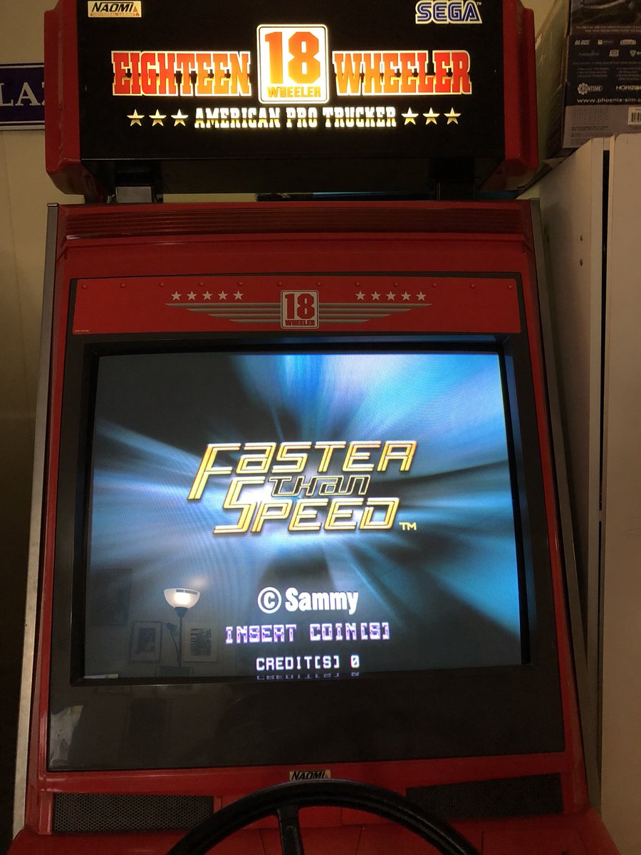

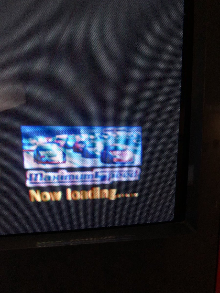

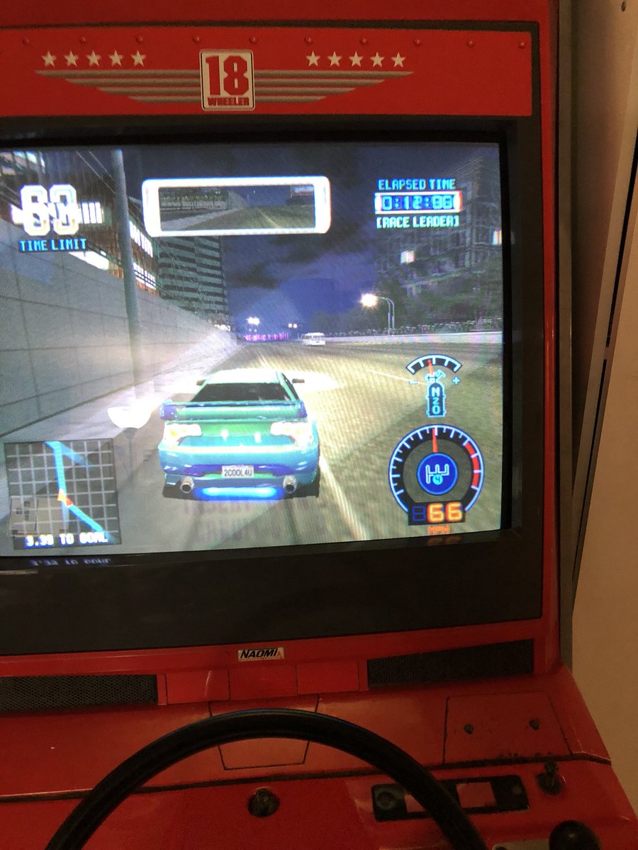

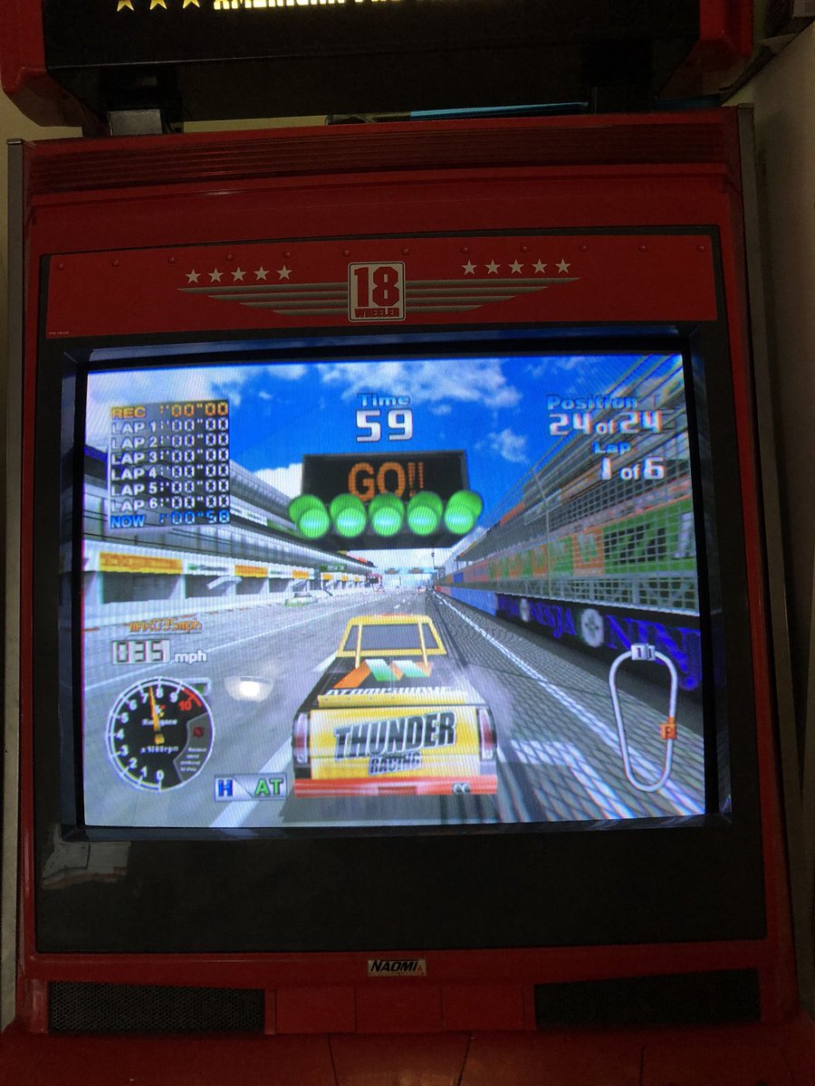

I've got both maxspeed and ftspeed booting at least, and I got the configuration screen for the IO, but didn't seem to have any input on FTSpeed (one version no steering / pedal IO, and one version I can't get buttons working outside the test menus and black screen after the intro), but MaxSpeed seems to work!
It is surprisingly playable too.
