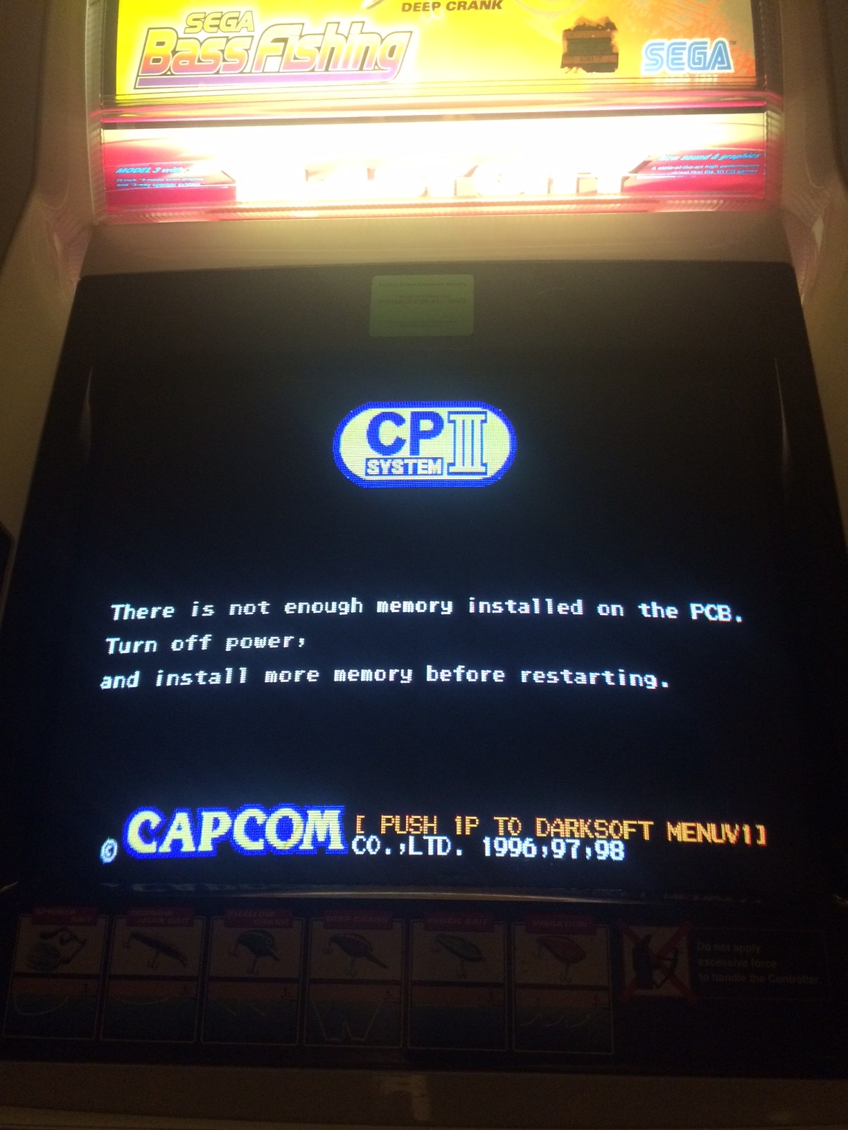

Hey there so I have a cps3 setup with a standard sh2 and a superbios. Yesterday it locked up when playing 3rd strike(a) usa.
I am currently attempting to troubleshoot the thing
-I tried running the japan version and it locked up after a minute or two, then at some point it also threw a ram error
-earlier I tried to reinstall 3s and at about 60 percent completion it threw up "error 12"
Tomorrow I plan on trying to install some games that require less ram to hopefully further isolate the problem, but I just wanted to post this here to see if anyone could reassure me that error 12 is indeed associated with the RAM.
After that I am going to try and reseat the ram and see what happens, because it seems like that is where my problem is stemming from.
I have done a little bit of searching and have not found anything about that error in particular, any info would be appreciated.
Thanks in advance for any responses; sorry if this is not the appropriate board for troubleshooting like this and I will try and keep this thread updated if I do find a solution.
