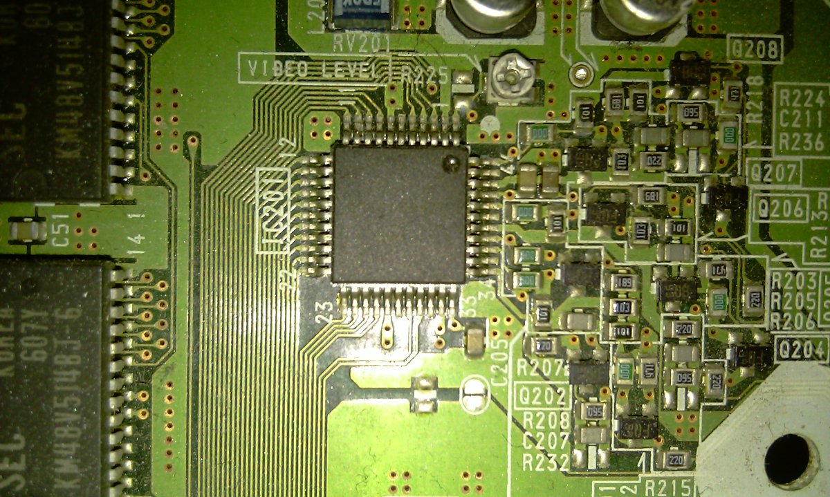

Try adjusting this, be careful and use a plastic adjustment tool.

That pot did turn up the brightness levels within the game, but it was still having sync and contrast issues. I contacted the seller on eBay and I'm hoping that I can get a refund..
