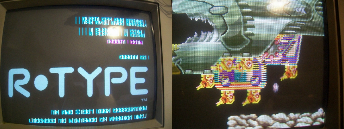

Board was faulty, it was stuck on this static screen:

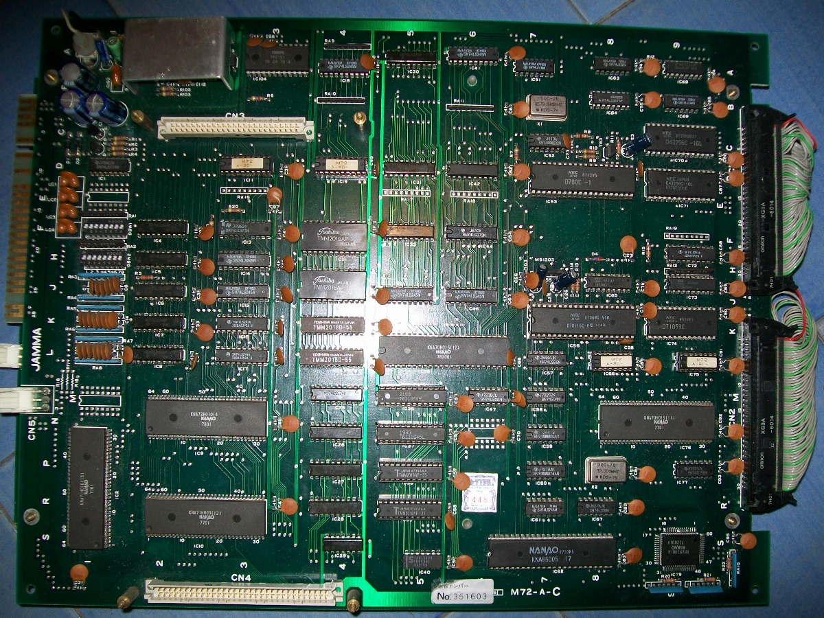

System is made of three boards:

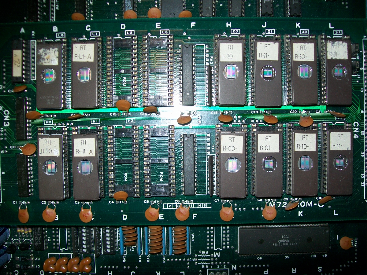

ROM board
CPU board
Video Board:

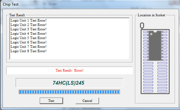

Swapping all the boards with a good set I could figure out that none of mine was properly working.So I started to troubleshoot the ROM board since it’s the most simple.The program ROMs were dumped as good but I found a bad 74LS245 @1A:

I pulled it :
It failed the out-of-circuit testing:

All the other issues concerned the graphics.Some examples:
Honestly it would take too long to explain in details what I did (and maybe I even lost track of it…) before the board worked fine again :

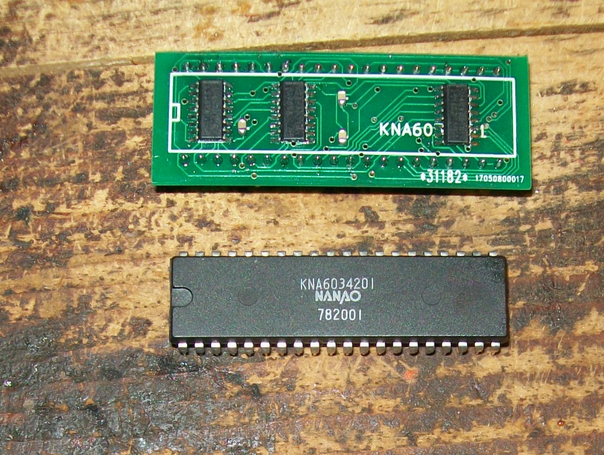

Looking at this PCB I noticed that the other custom ‘KNA6034201’;
was replaced by a little sub-board:
Technically speaking the custom acts like a big shift register, it can take up to 24 bit of data from tiles or sprites ROMs, here’s snippet from R-Type schematics;:
As you can see in the sub-board picture above the custom functions have been reproduced using six 74LS166 with common shift load and clock signals.So I wondered myself : why not reproduce it in a more modern way?I fired up my CAD and drawn schematics :
Routed them to a PCB layout :
I sent files to manufacturer and after some time I got the bare PCBs:
Here is the final result compared to orginal custom:
Luckily I made no design mistake and testing was 100% successful.Another board repaired and another custom IC delivered to eternity!
