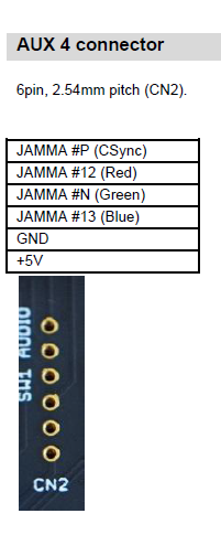

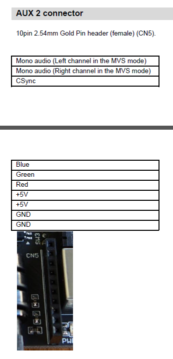

I wonder if it is possible to connect a proper CRT arcade monitor to the HAS Supergun?
I found two potential input indicated in the manual:
Arcade monitor connector has just R. G, B, CSync, and GND so I don't need +5v (?)
I just would like to know if it is possible and if anyone ever tried it. In case of positive answer I would like to try it. Tx
Yes. the best way would be to solder a 6-pin header. It can be a simple goldpin header, but I recommend a keyed type of connector, the JST XH or NH series. You can ignore the +5V pin because your monitor doesn't require it.

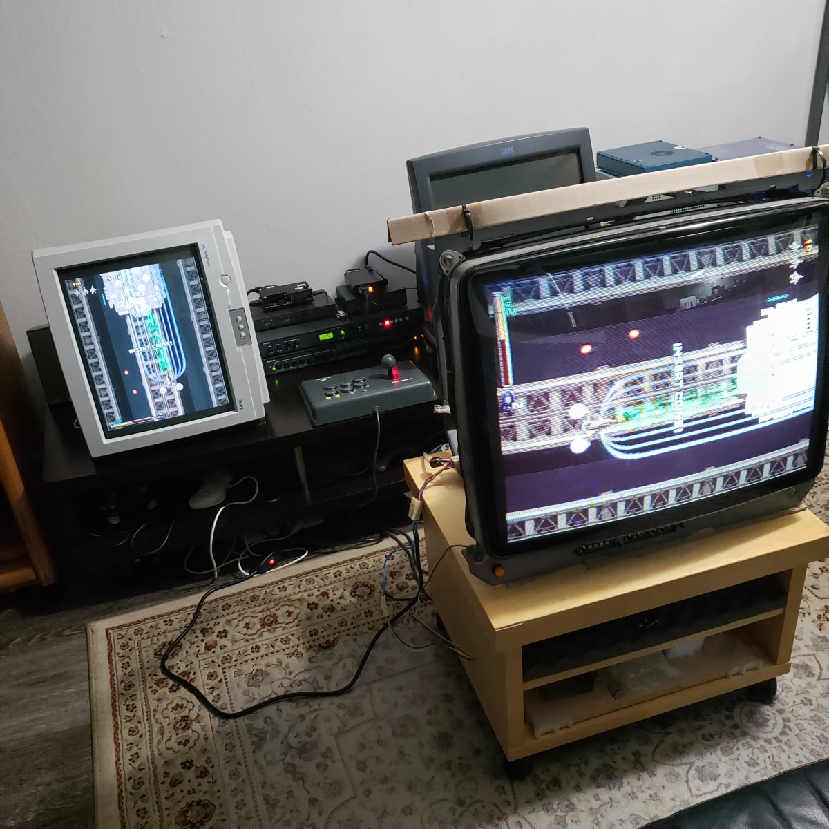

Just a test bench for when I work on the monitors out of the machine. From a few months back. Fucked my neck up and haven't been able to get much of anything done with screens.

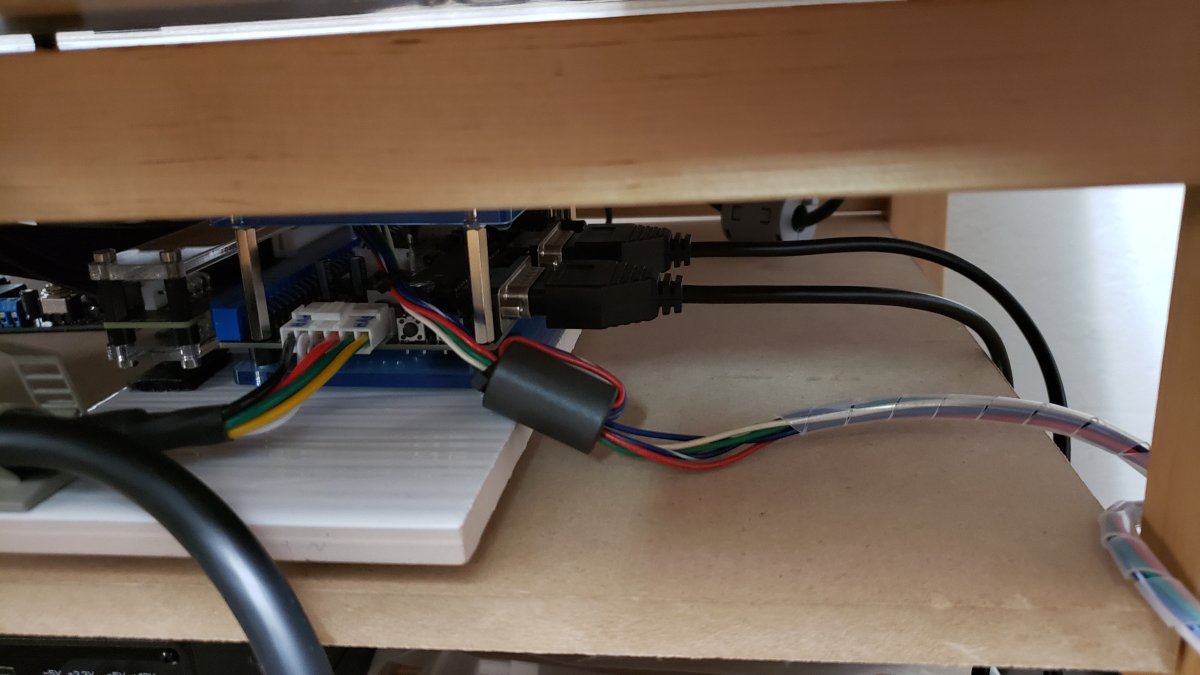

The JST connector is very cheap to purchase. Make sure you get a male and female set. You can find ones pre-crimped and just build an adapter and AMP UP connectors. I had a spare SEGA cable lying around, so I just adapter it.

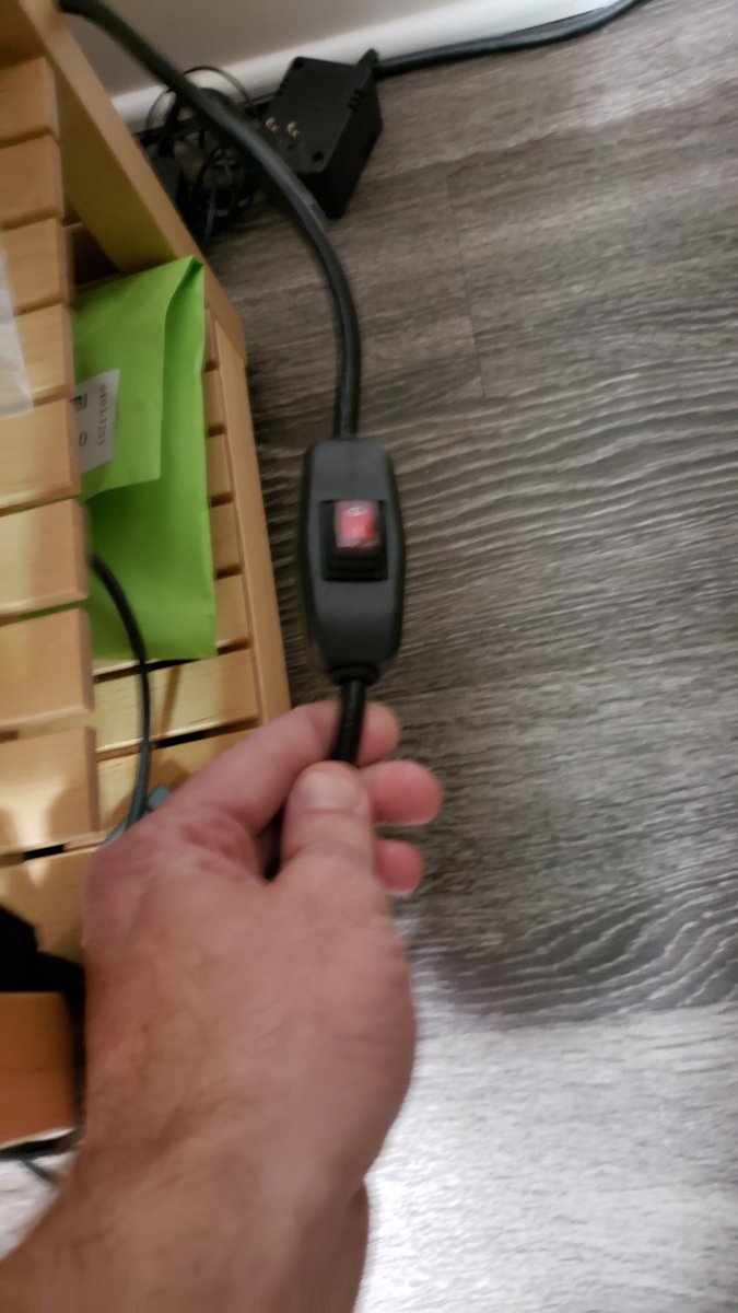

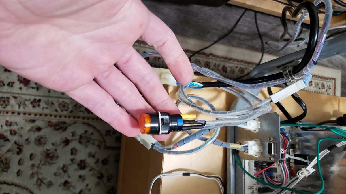

Is the second picture a power on/off switch for the monitor? That is a good idea!
Second photo is a degauss switch. Third is the power switch which terminates to the AMP UP connector on monitor.
Nice option the degauss switch. I will have the Degauss disconnected as I will mount an arcade chassis on a consumer tube… probably I will for a degauser wand, but it would be cool if I could wire my pending cables to a switch+degauser
It's actually the correct size for the mounting holes in the monitor frame. I have one that could work as an illuminated power switch as well. Degauss is just a momentary switch.
