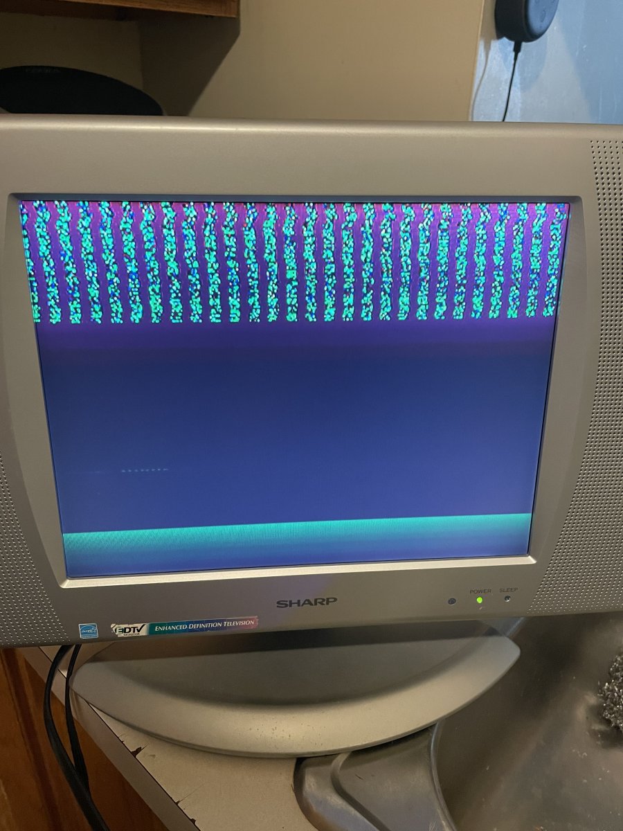

I have an older version of Darksoft complete with 5 ram sticks. I put them on, and I get this screen below. I removed all the ram and I do get a picture of the cps3 telling me that ram is needed on the pcb. Now, could it be bad ram? what I did is add a stick of ram once and then turn on and got the same there is not enough ram on the pcb. When I added the final one, I get the picture seen below. I did mix up some ram with the original and the darksoft but still got a screen similar to the one below. Any help here? I cleaned contacts, dedusted the board and such. I am stumped.

The SIMMs aren't RAM on CPS3 - they're flash storage. Capcom designed the CPS3 such that the game data is copied from the game CDROM to the flash SIMMs. After the SIMMs are successfully flashed, the CDROM is only checked briefly at boot and then the game runs entirely out of flash from that point forward.
In your situation, the Darksoft BIOS checks to see if it has all the flash SIMMs it needs to run a game. If the SIMMs are detected, the BIOS boots whatever is currently flashed to the SIMMs. I expect your SIMMs haven't been flashed with a game, so the system crashes with the garbage on your screen.
Your next step is to flash a game from the CDROM to the SIMMs. Depending on which Darksoft BIOS you're using, you should be able to press Start at power on to get into a menu that will let you flash a game image to the SIMMs.

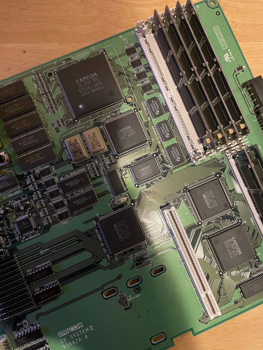

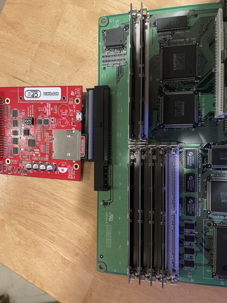

Doesn't matter if it's Darksoft repro or a real Capcom SIMM, as long as you have six SIMMs, you're good. Should be x2 64MB (4 chips on 1 side) in Slot 1 & 2 and x4 128MB (4 chips on both sides) in Slots 3-6. Check to confirm that roughly matches up with what you have currently. If not, you may need additional SIMMs.

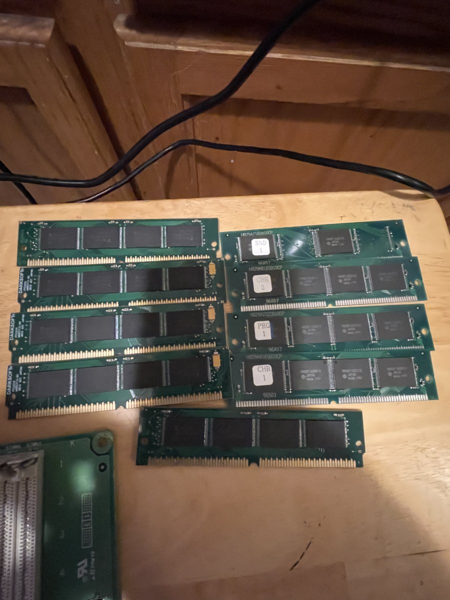

this is all the sticks I have

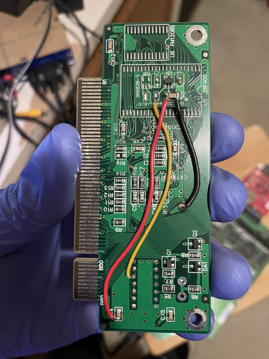

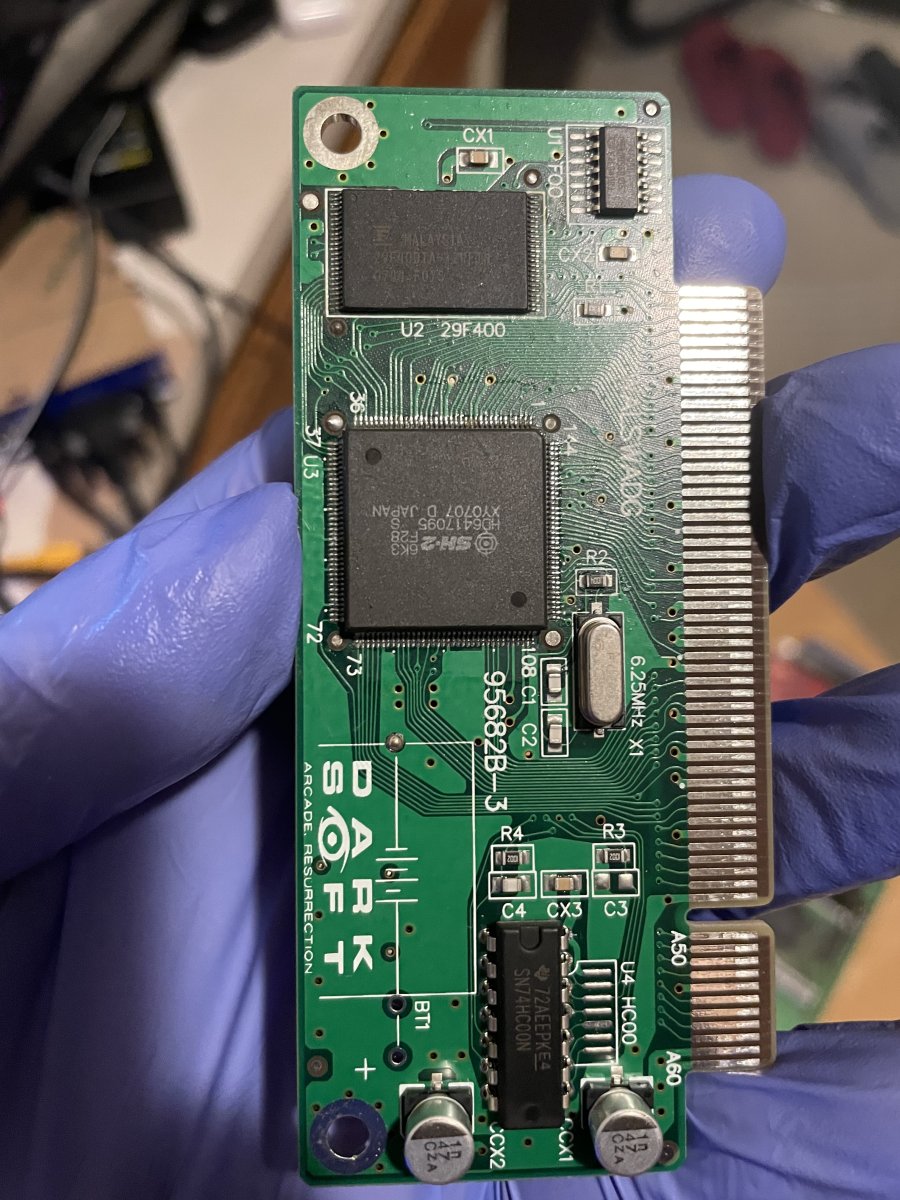

Which cartridge do you have? You're probably using the wrong image. If you can, please open the cartridge and show pictures of the board.

I can't tell from the angles you took the photos at, but if you only have 1 64, that's definitely part of the issue.
The cart you have is a "Standard" SH2, so you need to use the Standard disc image, not the "Custom" image.

Something else just occurred to me - you can use the wrong image and load data, it just won't boot. So if you're getting an "invalid CD-ROM" error, it means your drive emulator probably isn't setup correctly, or you didn't write the image properly. One of the two.
How are you writing the image to the SD card? There's a guide here.
