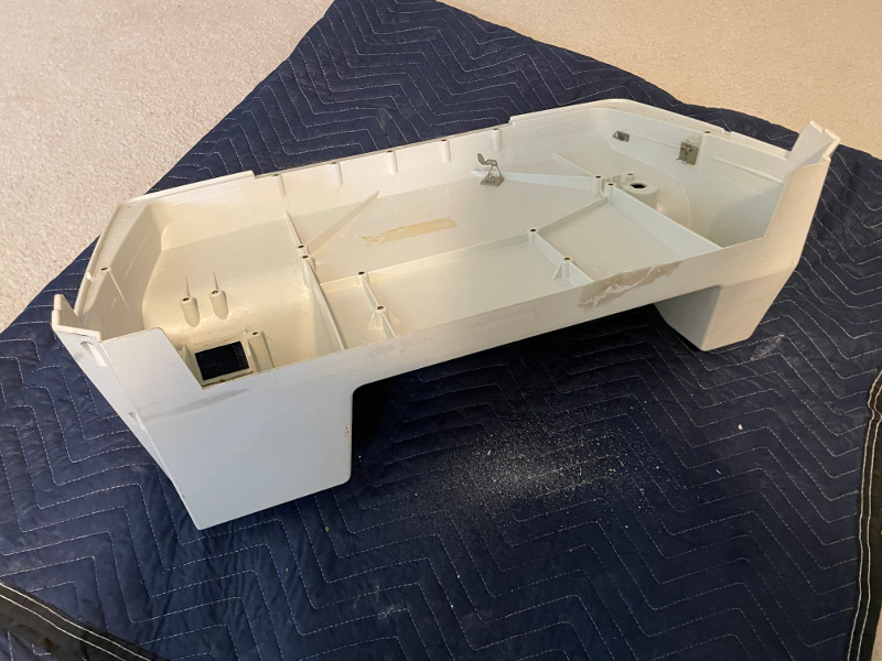

Hey guys,
I have some damage on an NNC cp lower half which I'd like to repair with bondo and seal with paint to prevent further damage.
My question is, should I use a general purpose bondo putty like this?
https://www.homedepot.com/p/3M-Bondo-Home-Solutions-1-qt-All-Purpose-Putty-20052/202077805
Or should I go for a fiberglass specific Bondo, they have a couple of options which seem suitable:
https://www.homedepot.com/p/3M-Bondo-1-qt-All-Purpose-Fiberglass-Resin-20122/202077790
https://www.homedepot.com/p/3M-Bondo-41-oz-Short-Strand-Fiberglass-Filler-272/202077784
Any pro tips would be appreciated, thanks!
Here's a couple pictures of what I'm dealing with:

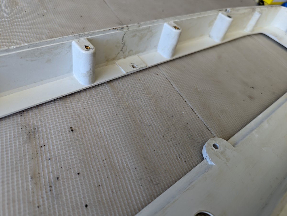

Since that is plastic I recommend a plastic glue such as Super Glue Plastic Fusion, which can be sanded and painted once dry.
Maybe something like this would be more appropriate?
J-B Weld 8237 PlasticWeld Plastic Repair Epoxy Putty - 2 oz. https://a.co/d/9n4kdKD

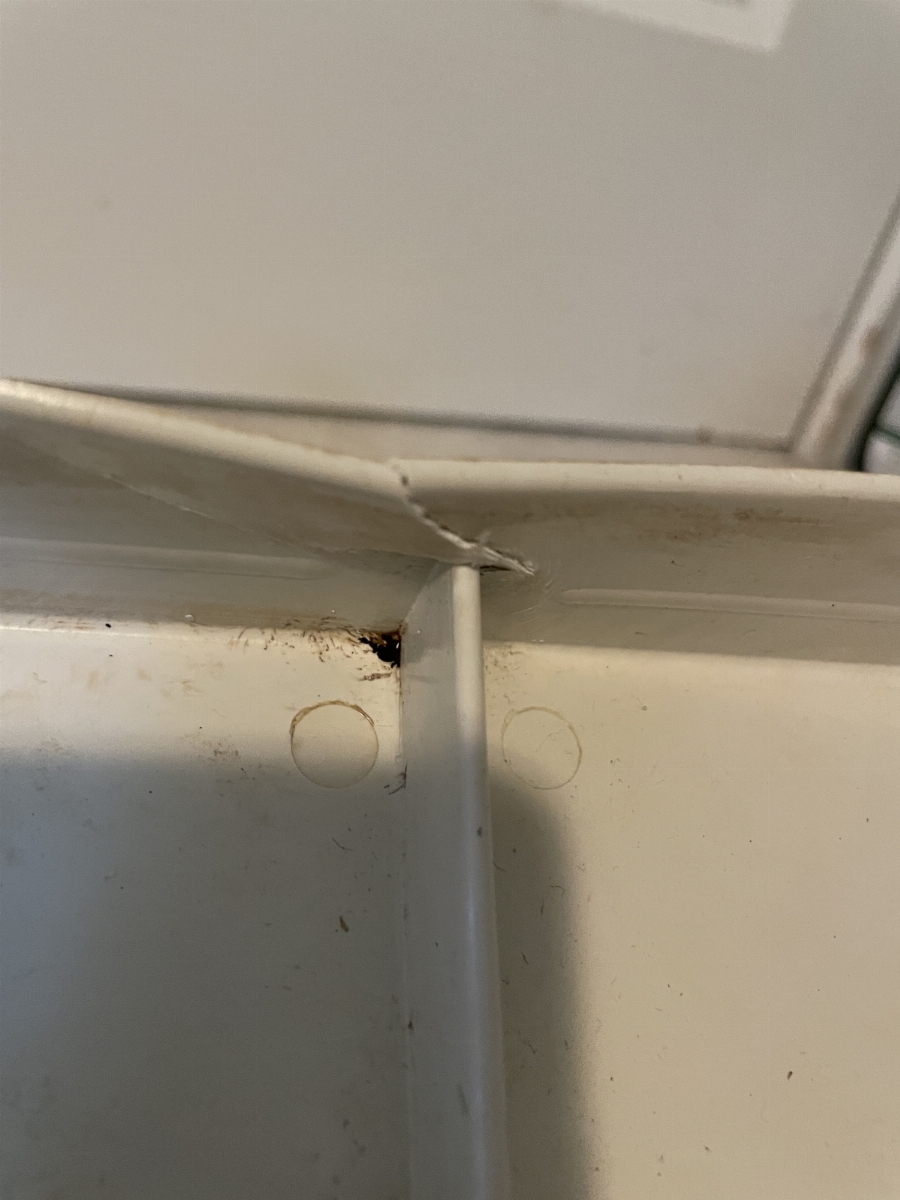

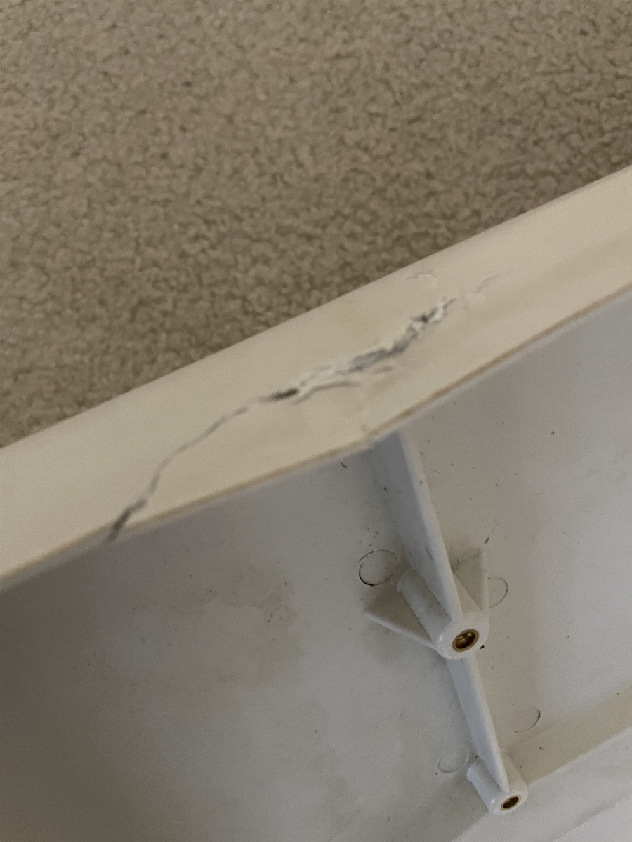

The control panel is dented/cracked but not broken apart completely so I think a putty that can fill in and improve strength might be best?
Edit: Hmm or maybe just some clear epoxy suitable for plastics like this: https://www.homedepot.com/p/J-B-Weld-25-ml-ClearWeld-Quick-Set-Epoxy-Syringe-50112/204986141
That should work too. It's the same thing. Either can be used to fill in the cracks then sand flat. Add extra over the cracks on the inside of the panel and it should be strong. I successfully used Plastic Fusion on a coin entry surround so I know it's compatible with that type of plastic. The part you're working on could be a different type but the glue/putty should still stick if the plastic is clean and sanded first.

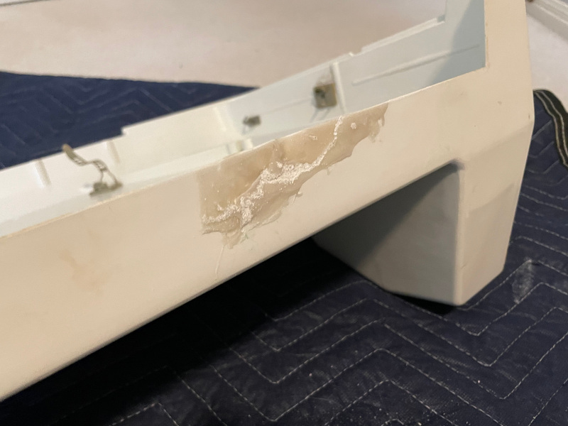

I just repaired my NAC control panel with this exact Plastic Bonder (from Home Depot as well :) )
Worked surprisingly well and as Thomas mentions, once dry it sands down nicely.
I ended up wet sanding with 600 -> 800 -> 1200 grit sandpaper to get it smooth and flush.

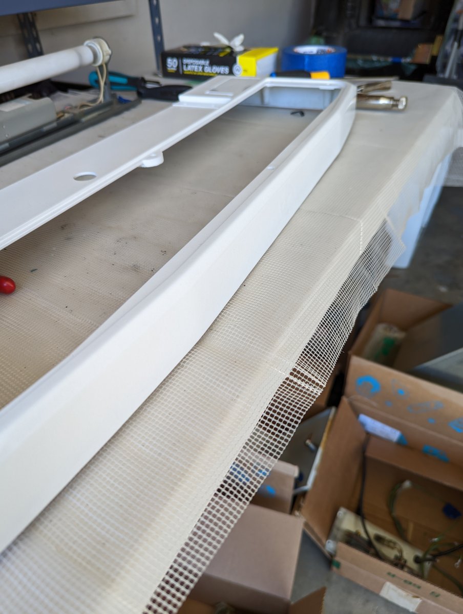

Great stuff, thanks for the info and confirmation!
Still working on the panel as we speak (a bit more sanding + top coat needed)
but here's the inside sanded down and outside with some primer and paint added.
Note I didn't sand down the inside completely flat as I got tired of sanding but may follow up on it in the future.
Plastic Bonder did the trick! It sort of bubbled out/into the cracks and filled any gaps when it cured.
I've sanded off the excess, so it's got a flat finish and is in solid shape again.

Just reporting back that the JB Weld bonder worked on my NAC. I didn't sand down the glue all the way to base but got it close and painted over. Really my main concern was just repairing the cracks and this looks like it worked.
