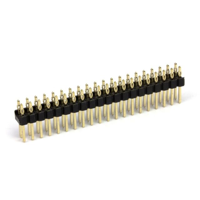

why would you cut the connector?!
next time simply plug that in to make the job a lot easier?
https://www.pishop.ca/product/hammer-header-male-solderless-raspberry-pi-connector/
