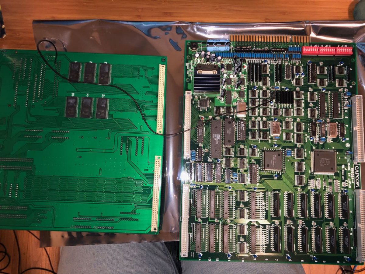

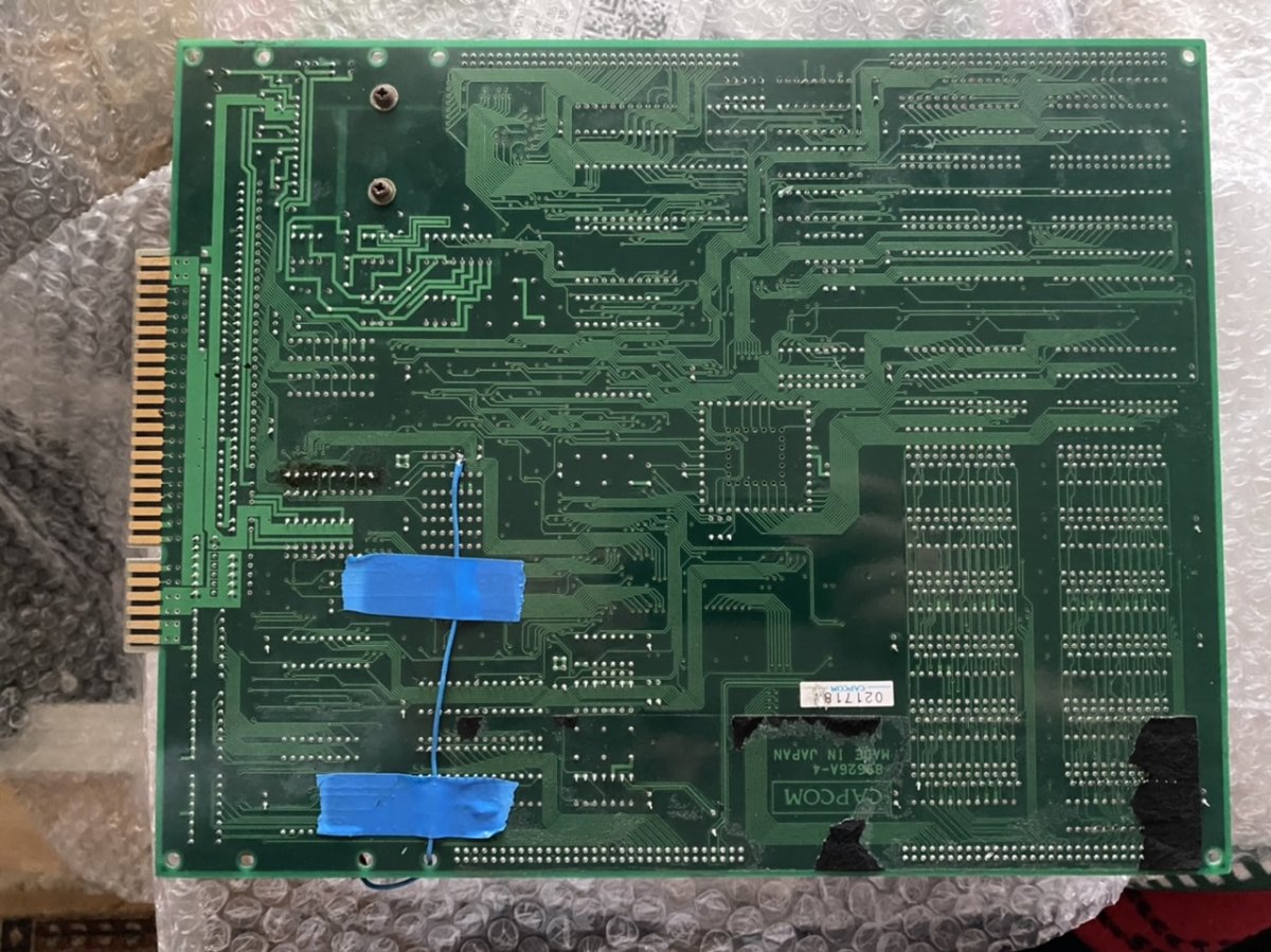

Looking to move my sketchy CPS1 multi board to a new 'A' PCB due to the old one being bad. Anyone know what modifications if any are required? It looks like it just uses a single reset wire, but with all the iffy repairs that are on my current 'A' board I'm not sure if any of them are related to the multi.

The story so far. Many years ago, when I was young and foolish I picked up a CPS1 32-in-1 board from China. It frankly worked really well for quite some time. But recently it started to have audio issues (thinking it's the z80). I pulled it apart, and found a large number of questionable repairs, but nothing that looked too out of place. It was a 10mhz board that had been upgraded to 12mhz by having the crystal swapped, most of the capacitors had been replaced (poorly and not sure with new capacitors) and there's a weird diode replacement job (see pic). I also had a clean SF2 WW board set, so my thoughts were to use it as a diagnostics platform. When I connect the board, it boots and runs (with audio thus showing the audio issues were on the old A board and not the B+C multiboard). But with heavy graphics corruption. I thought that MIGHT be related to the 10mhz crystal, but after swapping those I'm still seeing the same issues. I did confirm that the pin shown here earlier does reset the board. So that's one mystery down.
Really not sure what the deal is. What other than the crystal could have been changed out that would cause graphics issues if it were missing?

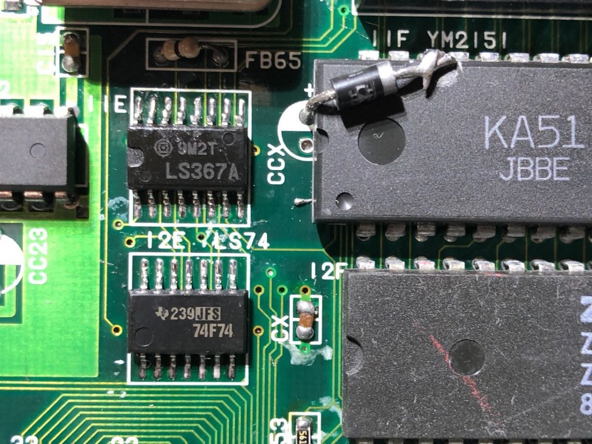

(diode weirdness - and note that the crystal shown here has no markings so can't be sure it wasn't replaced)
Edit: Chip is a rebranded YM2151. Diode is running to pin 22 which is +5v (vdd). So while weird looking, it seems to be right.

Could also be the line driver (LS367A) it's clearly been replaced, poorly, at some point. Lot's of nasty flux residue and the pins are not properly lined up. I don't see anything under my lil' inspection scope. But that doesn't mean the pins are making proper contact.

I am increasingly flummoxed by the diode on the Yamaha clone. It's where a capacitor should be according to the screen and it drops the voltage to the 5v pin down to close to 4. I just don't understand what it's doing there... looking over the diagrams, shows neither capacitor nor diode. The more I look at it, the more it seems to be a factory install, but I really can't figure out what it's doing. Big problem is it's in the way so I cant piggyback a new chip to see if it works.
Edit: So this seems to be common with the Chinese "build a working board from whatever is in the bin" method. But I really have no idea why it's wired up this way. But I'll keep it as is, pulling power from the capacitor pad, and drop in a socket for a replacement chip.

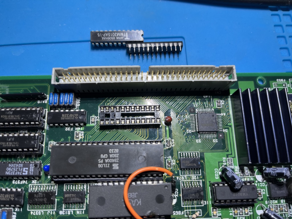

On a whim I did go ahead and socket/replace the SRAM chip @duffcon spoke about in their thread, but no effect. Did have a moment of elevated expectations when it turned out the chip that was in there had a bad leg (can see the shortened leg pictured here. Left most pin, shown next to its replacement), but nada.
