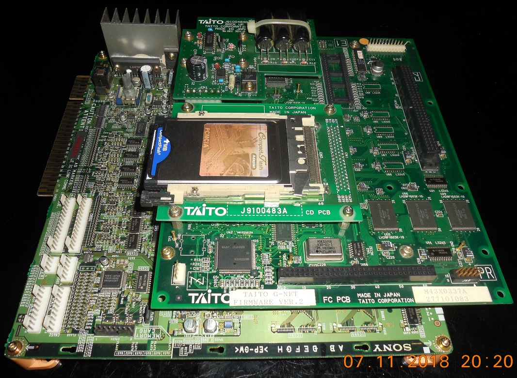

So I'm having issues and hoping someone can help me diagnose.
I got a motherboard from YAJ. Flashed it with the 2011 modbios burned by @skate323k137 -- waited through the multiple status bars (despite not being able to read what it's saying), made sure that it was totally done (I must have watched that last screen for 20 minutes easy). Got me a CF to PCMCIA adapter -- https://www.amazon.com/gp/product/B0009M069Y/ref=oh_aui_search_detailpage?ie=UTF8&psc=1 -- and copied some games from ikotsu's blog to cards with CHDMAN. Nothing, just a black screen. Same deal using @twistedsymphony 's converter tool and win32diskimager. Okay, I figure I have bad cards (bought them from @Darksoft who said they didn't work for CF booting his Naomi/Chihiro so okay). Today I got in a Transcend 1 gig card -- https://www.newegg.com/Product/Product.aspx?Item=9SIA31U1HN0933 -- from a US seller so I'm reasonably certain it's not bootleg, same issue. Black screen.
Any idea what might be going on? Anyone able to send me a known working CF card and/or CF to PCMCIA adapter so I can test that? (I have no actual game cards) I'm worried that something might have happened to the motherboard somehow and I have no way to test it.
I advise finding a (real) cheap game card to check. If you can, find one, then you can send me a PM and I can send you information to back up and test your work, to rule out CF or adapter woes.
