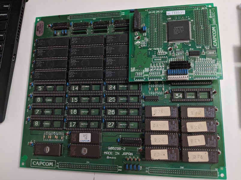

Hi all,
I purchased a CPS1 Street Fighter 2 World Warrior PCB a year ago and wasn't realized it's a hacked Thunder version. It plays like this: https://www.youtube.com/watch?v=T1nf0a2tcFM.
I'm thinking to restore to its original version. I would like to see if replacing all EPROMs marked with "SF" will restore it. Is there anyone can help me burning EPROMs that I circled on the attached B board picture and how much does it cost to burn them? I also attached the A board in case it's needed to know which files to burn.

From looking at Mame, it looks like you just need to replace the 8 eproms on the right (28-31 & 35-38).

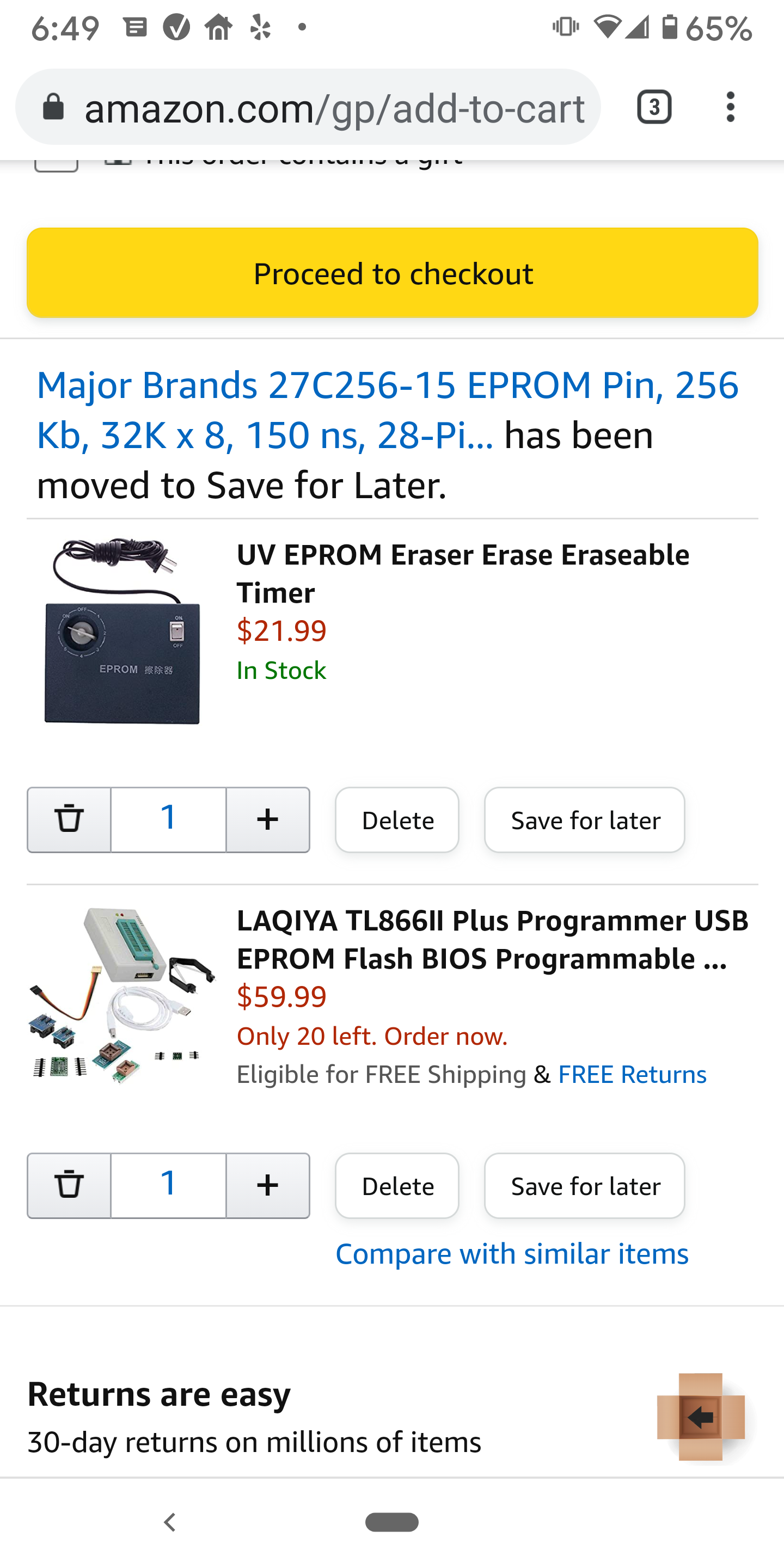

You could get a cheap TL866 programmer and EPROM eraser and do it yourself? It's like a $60 investment.
Thanks for replying Nem. Yeah, looks like left-side eproms are still original.
Which ones are using? Will the ones on attached screenshot work?
Those look fine. The programmer comes with some extra accessories you will possibly never use (the IC puller, adapters for SMD chips). You can grab the programmer $10-15 cheaper without them.
the pal next to the roms with hand labels may need to be replaced as well. Can't tell from the picture if it's original.
You're going to need to make sure you burn the roms from a set that matches the c board custom you have - CPS-b-17.

Thank you for spotting them. Is the PAL next to hand label roms should have "IOB1" text printed on it? On ArcadeOtaku site based on my Capcom chip on C board, it says the B board PALs are STF29 & IOB1. I only found one with STF29 printed on it.
Can I program these PALs as well?

yes, it should have IOB1 printed on it like all other gal's have their designation printed on them.
