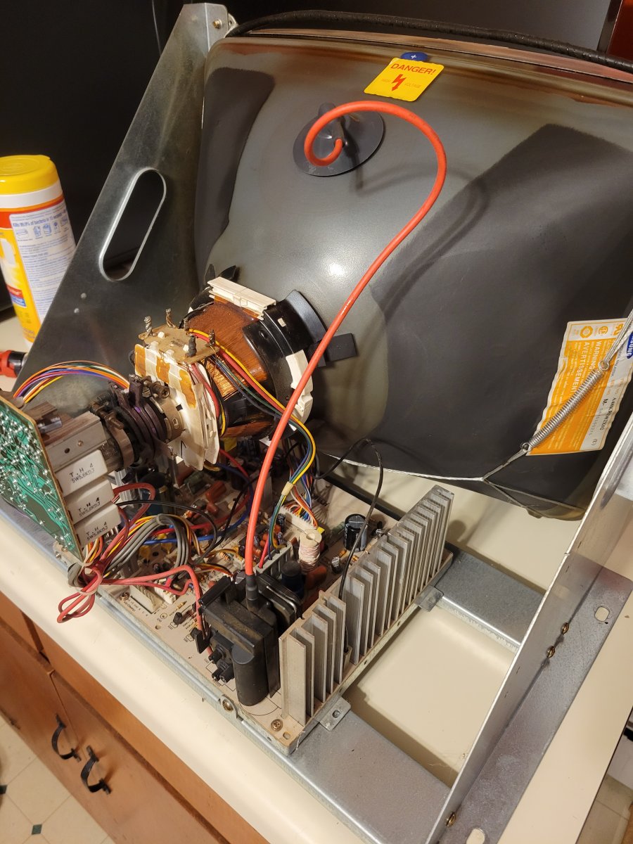

I picked up a pair of Bestech btm-19cm chassis listed as not working. I'm aware of the negative sentiment about these, and I am sure it has been earned, but the price was right for a couple of project pieces to learn on.
I recapped one chassis with the exception of a few caps on the neckboard that I had no replacements for.
I hooked it all up, got neck glow and a picture. But the image was not stable. I adjusted the v-hold and h-hold and managed to get it steady.
The image was bright and the color was good, but the horizontal width was too large. I adjusted h-size to the smallest I could get on the pot, but it was still slightly too large. I did not adjust the coil.
Suddenly the picture and neck glow stopped and I was greeted with a clicking noise. I believe that this is a protection circuit? Subsequent attempts to turn the monitor on have been met with the same clicking.
Does anyone have documentation on this monitor? In my reading it looks like this may be related to a bad flyback or Horizontal Output Transistor. I have not had much luck searching the part number for this flyback. How would one go about finding a compatible replacement?
Tested the other chassis without a recap. No noticable neck glow, but a very faint picture with an occasional cracking noise (arcing?).
Swapped the c5298 transistor (HOT?) and horizontal width coil into the chassis making the clicking noise. No change.

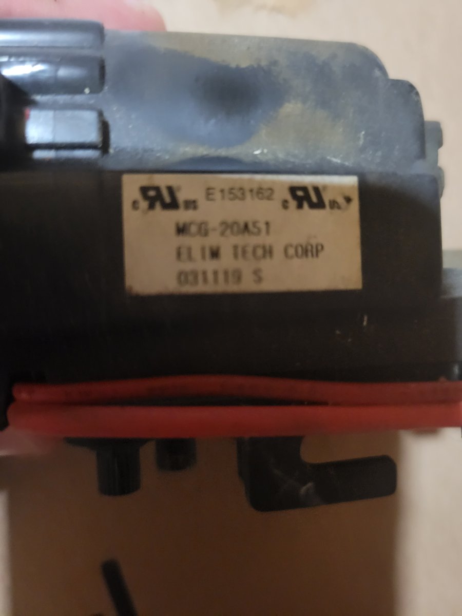

Swapped the flyback. No change.
Tried the other chassis. Heard the monitor pop on. No picture. Tried adjusting brightness, then the monitor shut off and started making a chirping/clicking noise. Shut down and retried and it now makes this noise whenever it gets power.
Looking for any direction into what to possibly test next. Flybacks seem impossible to source, so hoping to rule put every other possibility before giving up and shelving these. The tubes are really clean and the one had a great looking picture in the seconds it ran. Would be a shame to have them wasted.

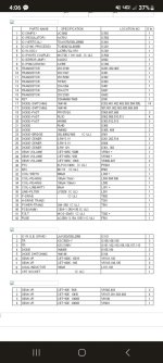

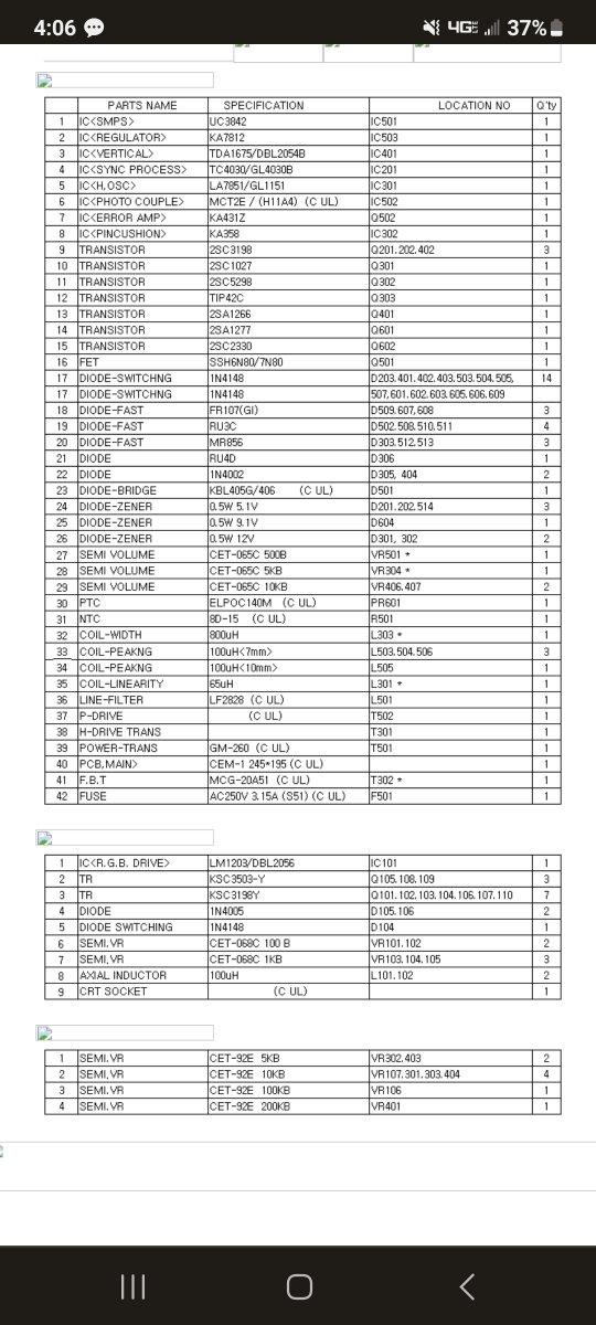

Found this in archives of the Bestech website today looking for more information on the Bestech chassis. Haven't seen this part list posted anywhere else, so i'm leaving it here in case it is useful to anyone else.

Installed the new flyback and the screen still shows no picture unless the focus is adjusted. It stays on longer and is brighter, but still fades out gradually after the adjustment is made.
