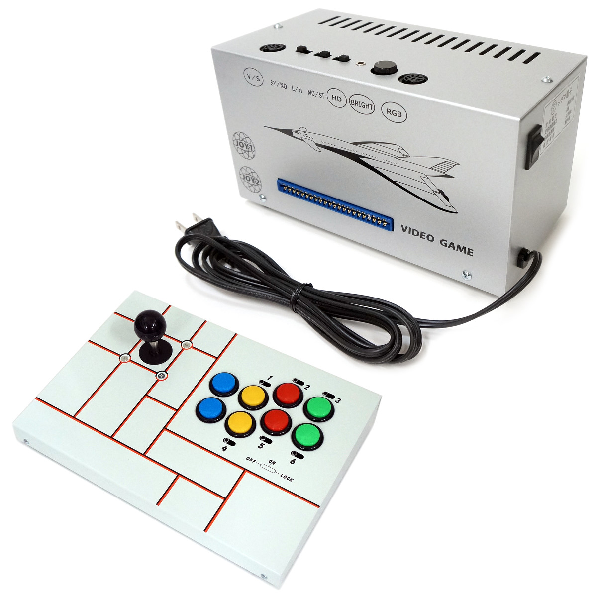

The Sigma Σ1AV control box from Japan with Σ3TB stick which is coincidentally compatible with the JJ-CBOX

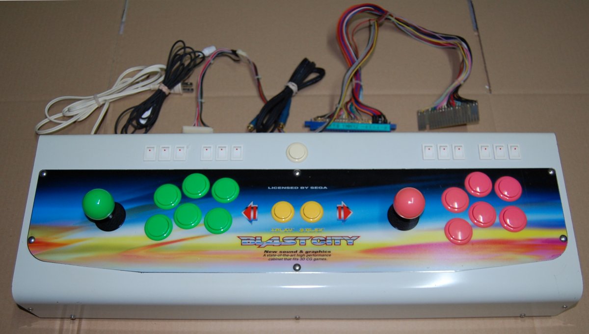

Most other control boxes from Japan are fully enclosed devices that also include 2 sets of sticks and buttons with a host of features depending on the model. The companies who manufactured these units included Pana, Kic's, Vega, Combo AV, etc. I had briefly owned a control box from Japan called "The Boardmaster" which was beautifully built, however the RGB signal out of it was atrociously bad, bright and at dangerous levels for consumer grade equipment, after experiencing all of that first hand, I moved the unit along.
The Boardmaster control box from Japan. Beautiful build quality, but lacking in the quality and safety of its video output

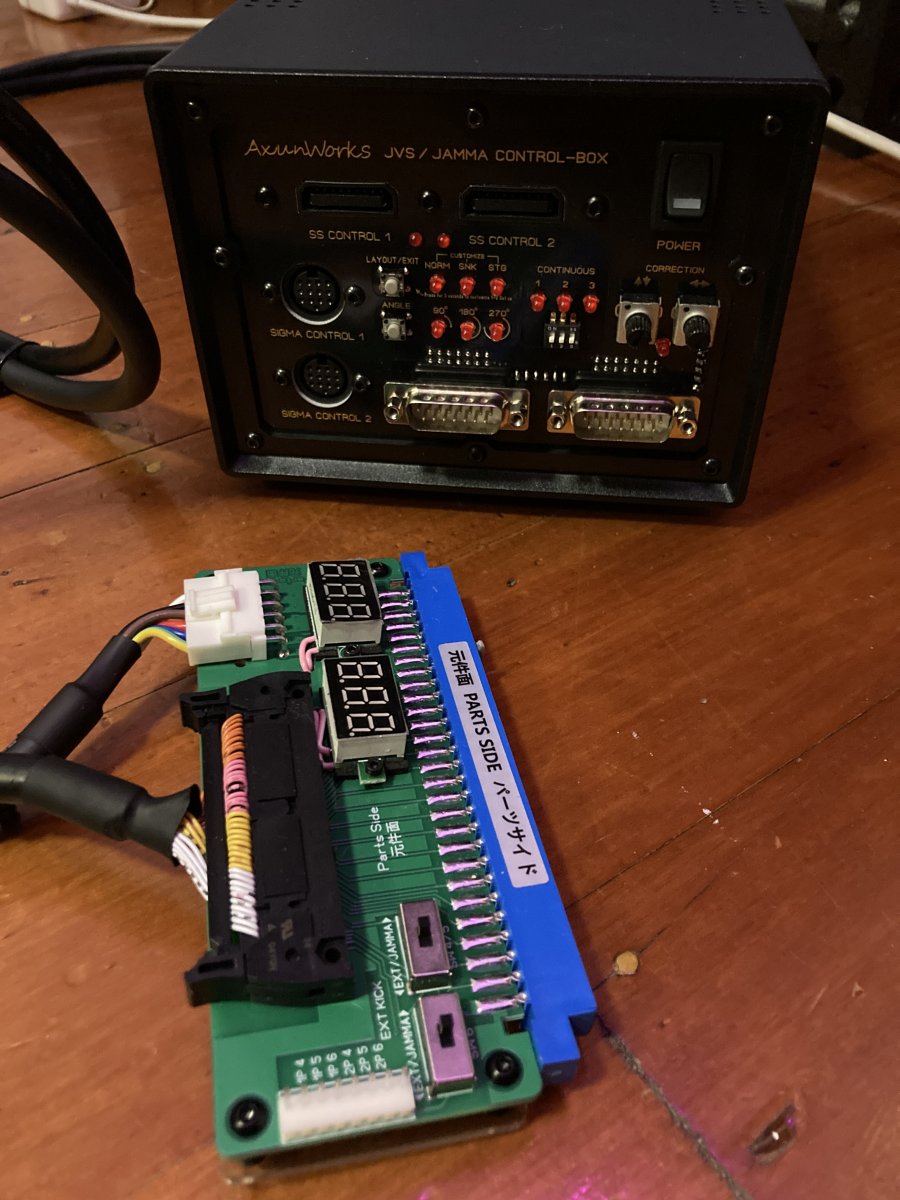

There are 5v and 3.3v adjustment pots on the back of the unit. You can adjust these with a little screwdriver. I suggest grabbing a set of ceramic screwdrivers for this task. There's DB15 (RGBS) and RCA audio outputs that I won't use and haven't tested, but I'm certain they would prove useful for a different user’s setup. The large potentiometer on the back of the unit is used to adjust the RGB brightness level. I have only used this to make minor adjustments thus far, but it's nice to have that functionality to dial up/down brighter/duller games.

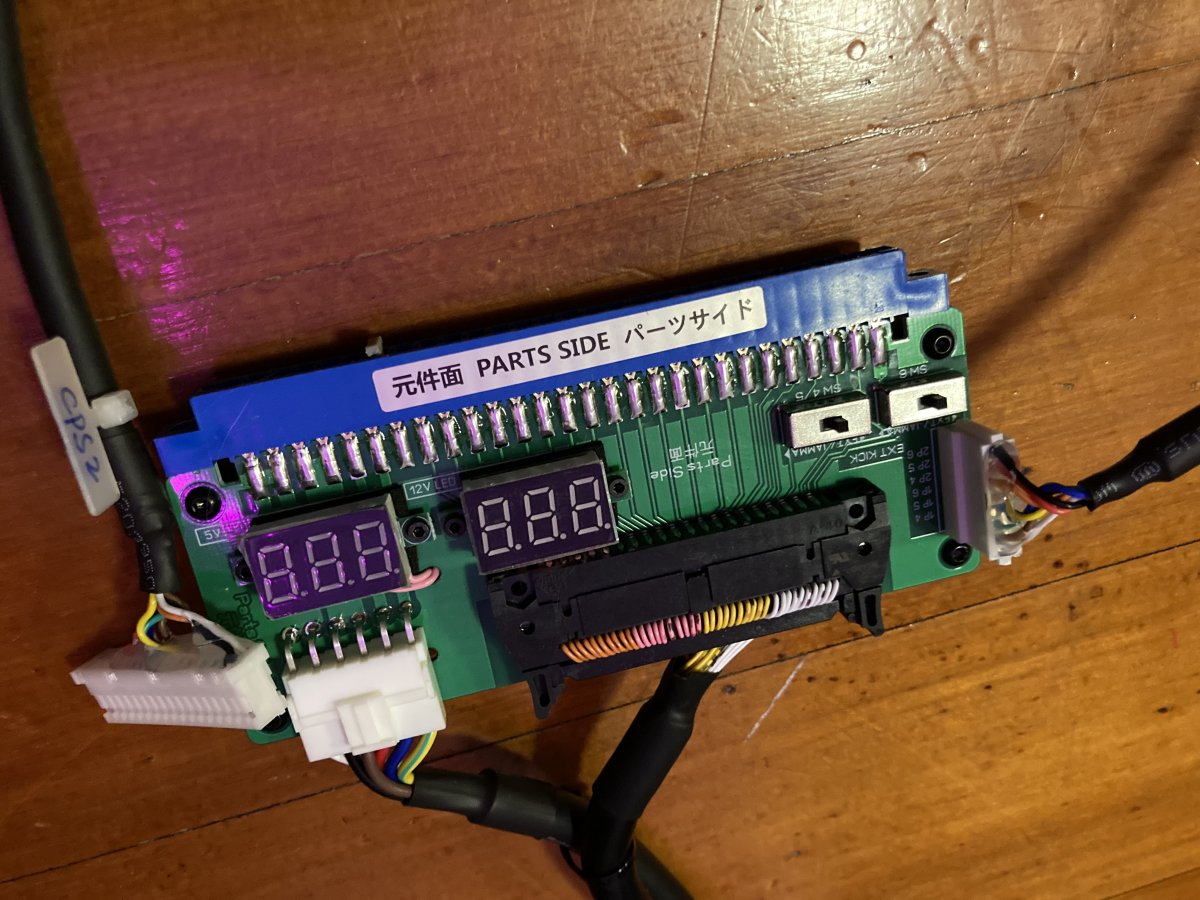

Kick harness functionality is simple, plug the harness onto the header directly on the CBOX or extension PCB and then flick the two little switches for buttons 5 & 6 to "EXT". I've tested CPS-1 and CPS-2/3 with no issues. The cables bought from Axunworks were of the highest build quality and reasonably priced too. They were also hand labelled, yet another nice little touch for those who have boxes of random cables and struggle to find the right ones :)
Using a kick harness with the JJ-CBOX is an easy task
The ability to use Saturn pads and Sigma sticks alongside the standard DB15 ports is very welcoming. It was handy to be able to grab any variety of sticks or adapters to use with the unit. I’m currently using a MD2NEO adapter with a wireless 8bitdo 2.4GHz M30 pad for Player 1 and an original Saturn pad for Player 2.
There are 3 DIP switches on the unit to toggle continuous fire of B1/2/3. I found this feature very useful whilst using the "STG" control mode where B1/2/3 are mapped to B4/5/6 and then by flipping the DIP switches B1/2/3 are rapid fire whilst retaining the original timings on B4/5/6. There’s also a SNK control mode layout to use with Neo Geo and a button remapping feature that I haven’t had the need to use yet.
3 modes of control rotation can be selected by a switch and indicated by a LED. My setup consists of linked side-by-side TATE and YOKO monitors, I enjoyed this feature a lot more than I anticipated. I played Ikaruga horizontally and Border Down vertically for shits and giggles, but this is more-so a useful addition for those with only a horizontal setup who want to get a few vertical STG games in without having to rotate their monitor.
The "Correction" pots are handy for PCBs that are a little off centre. Simply flick the switch on the back of the unit titled "Correction" and then alter the screen position with the H or V pots on the front of the unit. Flicking the switch back to "H/W Direct" returns it back to standard output.
As standard, there's Test and Service buttons on the back of the unit. After a little bit of time, I've learned where these are and can reach them with no issues with the front of the unit facing me.
The front of the unit with handy features for quick access
The back of the unit, with lots of adjustments and ports for a wide variety of arcade functionality

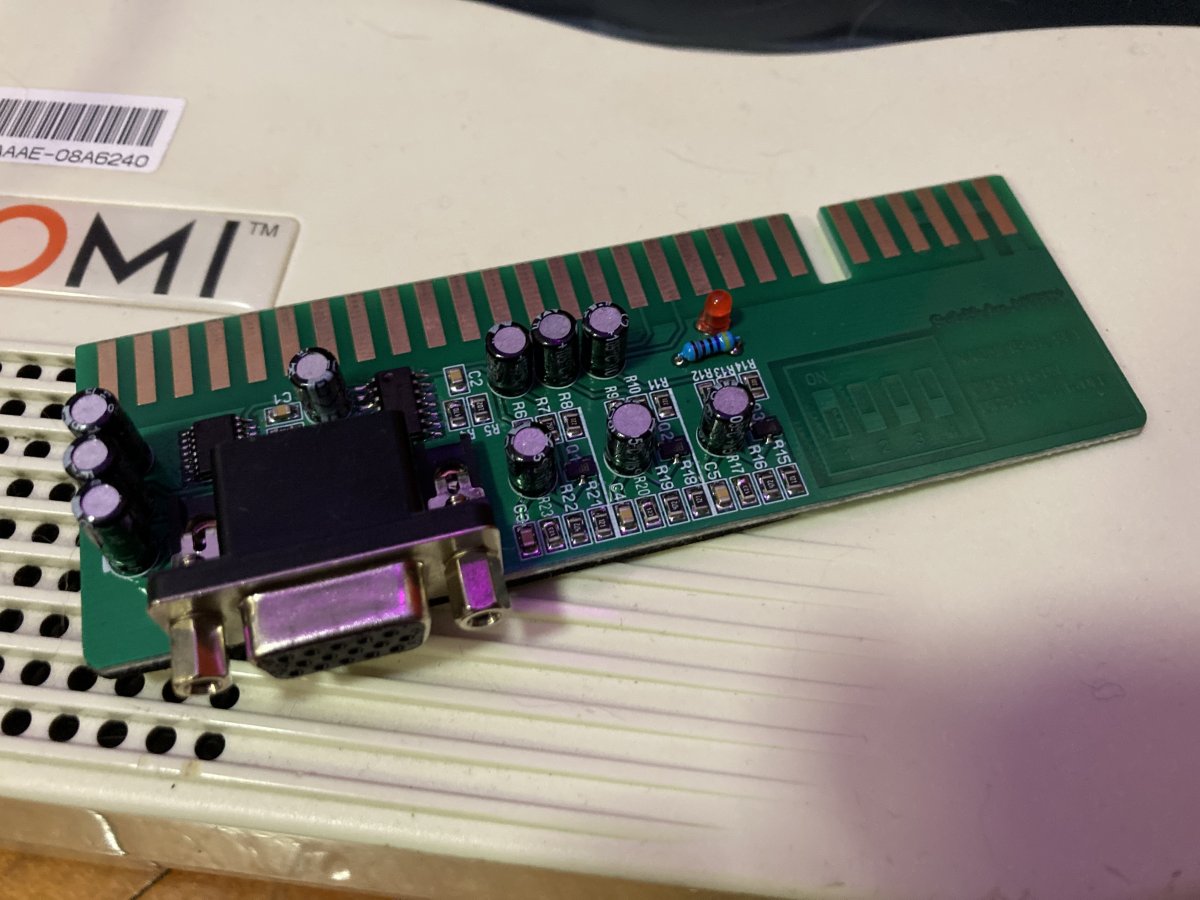

Axunworks custom Naomi 15KHz pass through PCB

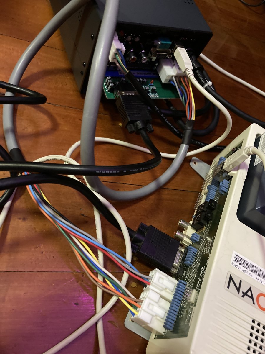

After setting everything up and netbooting a game I got the error, "I/O BD Not Connected". So I went ahead and tried a couple of other USB cables with no luck, and down a testing rabbit hole I went to see if there was anything wrong with my Naomi setups. After trying them both again with my own JVS PCBs, I realised this was an issue with the JJ-CBOX itself.
Honestly, I was a little disappointed. I hit up drfunk2k, and instantly he was onto it. Within a day, I had a direct line to Axun who straight off the bat assured me that regardless of the issue, he would pay for shipping back to China or do whatever to make me happy with the device the way I wanted. He sat with me patiently walking me through tearing down the device, screw by screw, until we figured it out. A cable had come loose during shipping. I soldered it back onto the I/O, put the unit back together and I was in business. JVS works great! I've only got the Naomi to test with, but it runs both Netbooting and 15KHz just fine. I look forward to exploring the JVS world more in the near future thanks to this device.
The Naomi 1 all hooked up. I didn't make the wires look pretty for the photo, but it's definitely a lot less of a rats nest than a conventional setup.
