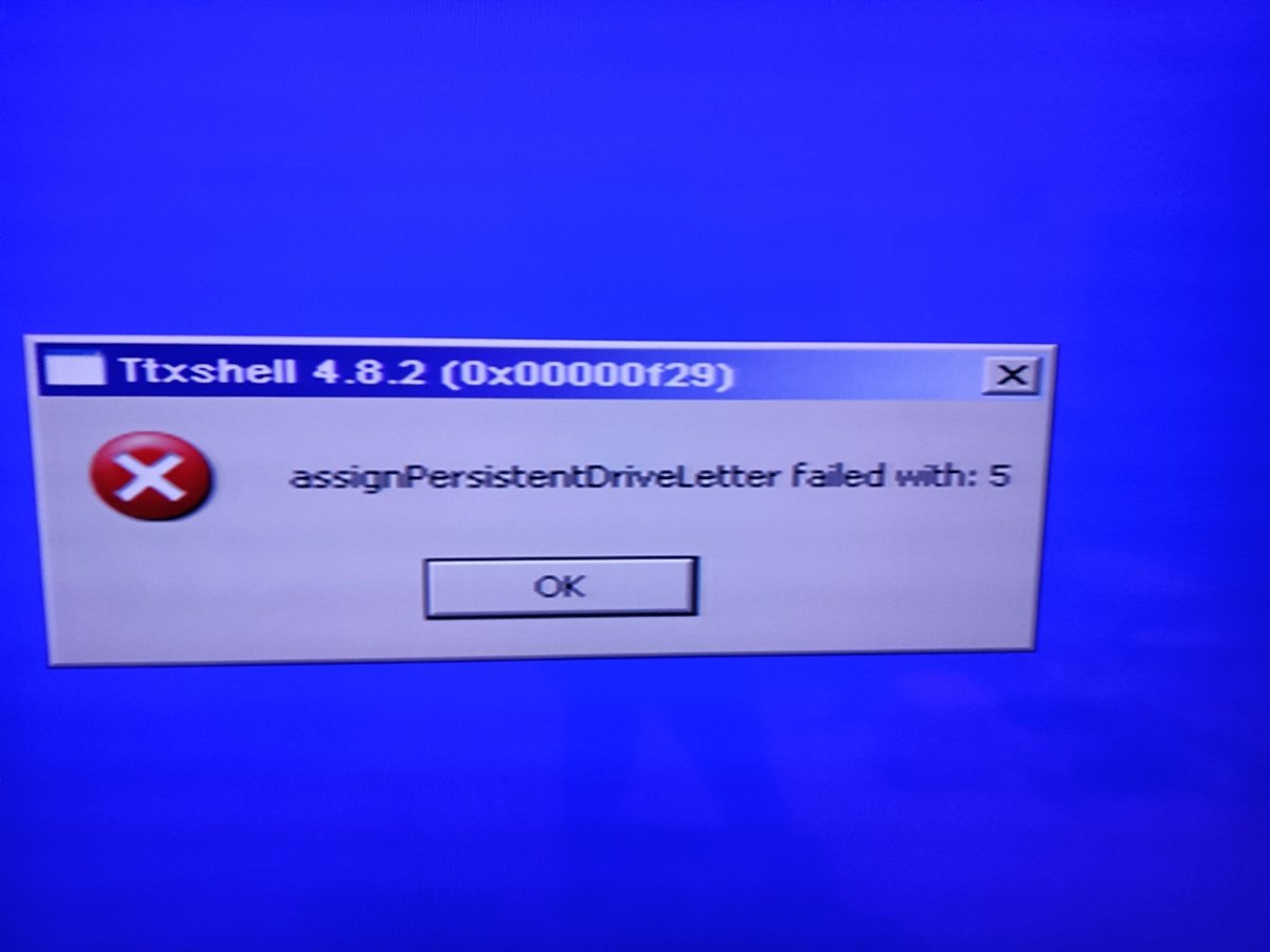

Why Only TGM3 has this problem,when I boot it twice,it will give me error massage at the second time,see attachment.
but when I push the reboot button on type x,it will be working again.also will give me error massage at the fourth time(Repeated errors),5th time working,6th time error.
I think something is wrong with the original HDD image, I am researching other ways of doing this.

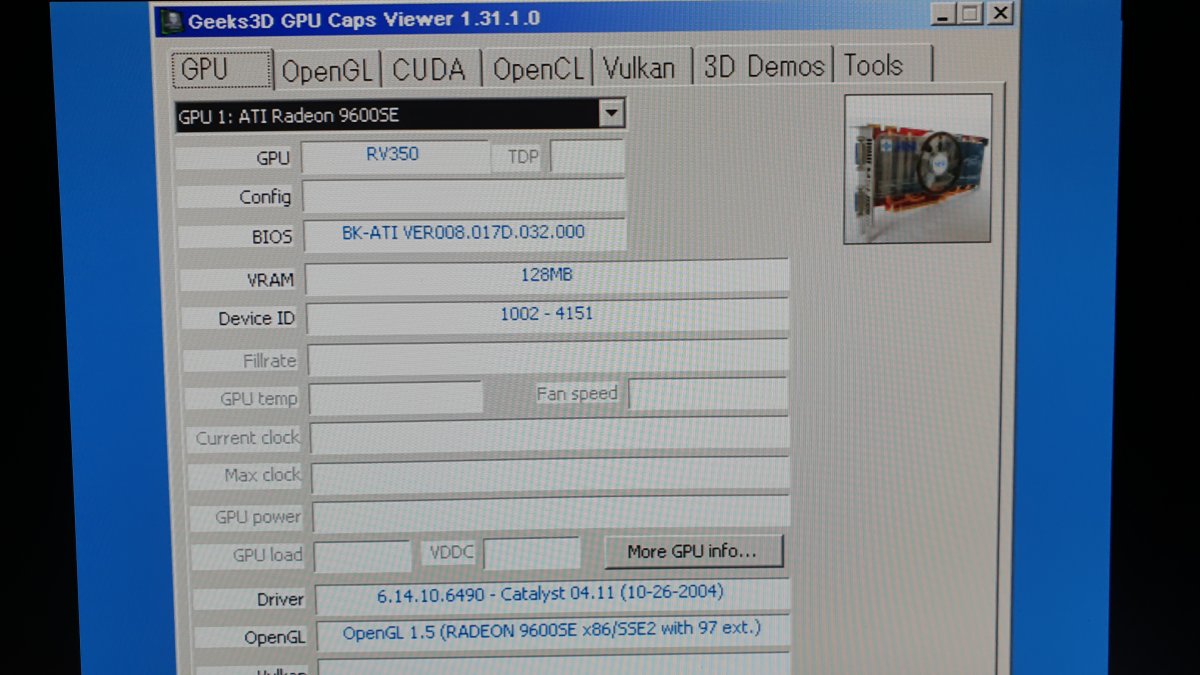

  • Connect it to your TTX and power on
  • You should now have a game called: _gpu_test_

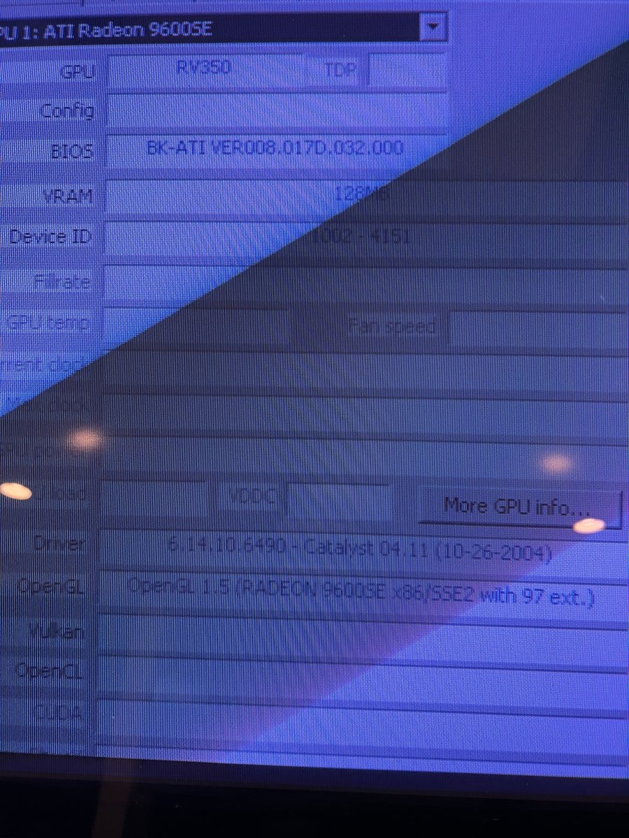

  • Start _gpu_test_ and take a picture
Here is mine:

I would check the GPU BIOS version on your Type X first.

Ok I will post my video card bios version shortly.
I tried a sync combiner and it didn't have any effect :(
That is the correct BIOS.

Tetris is 480P. If you do not get graphics try to determine which BIOS version you have by installing the GPU info game, linked above.
This . @notsonic
Search few posts from previous pages to see how i fixed the tetris in my ttx1 unit . Is all about your bios graphic card .
You need to run a tool provided to see what is the version your graphic card have first .
BK-ATI VER008.017D.032.000 - is the winner bios version for all games to work on TTX1
