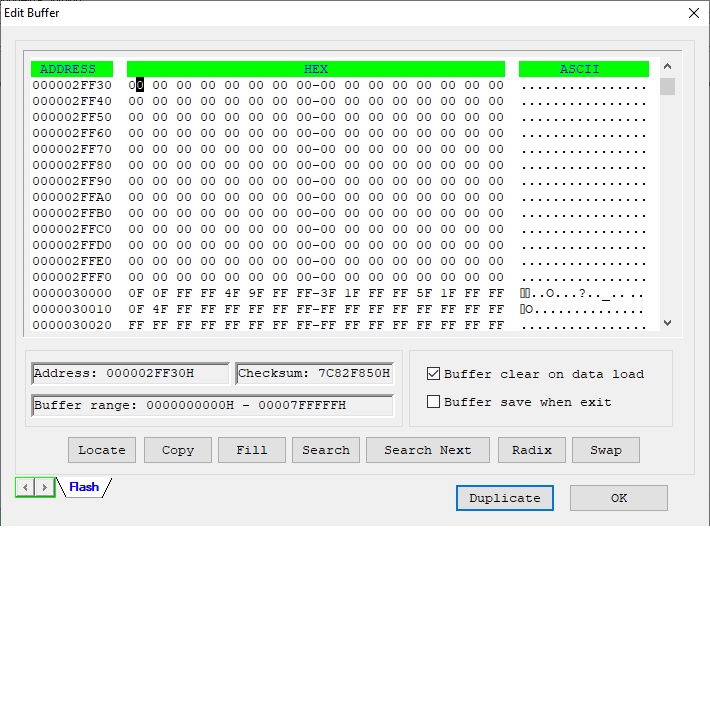

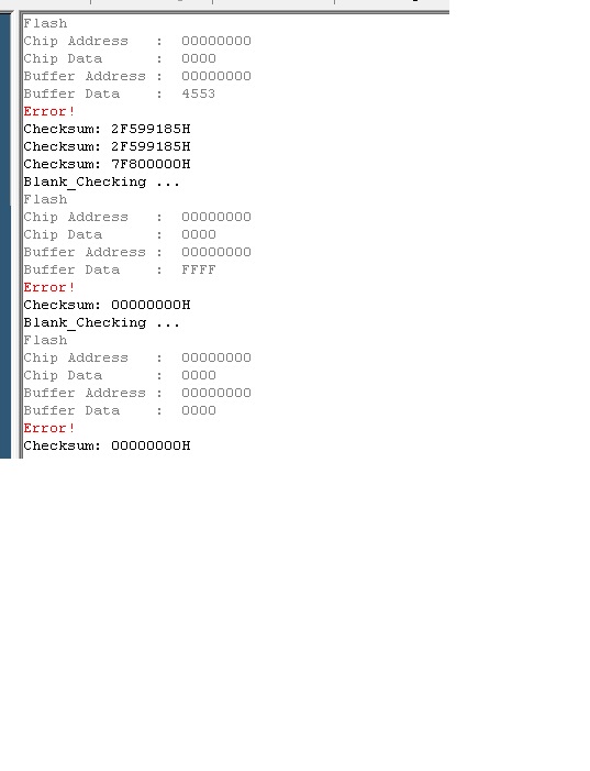

Here are some print screens of what I got on screen
I'm used with T48 and GQ-4X programmers but not with Xeltek
I'm I doing something wrong ?

The 4th 26L6420 in this batch seems OK 🧐
Blank check : ok
Erase : ok
Programming : ok
So problem is with the quality of the chips that I got from Aliexpress
Thanks for the heads up 😌🙏🏻
  • Like
Reactions: nem
Just to let you know, I got no chance, 9 out of 10 IC's were bad.
I received new IC's and tested them : everything works great.
So the adapter is good I just wasn't lucky I got a bad batch of new 26L6420
