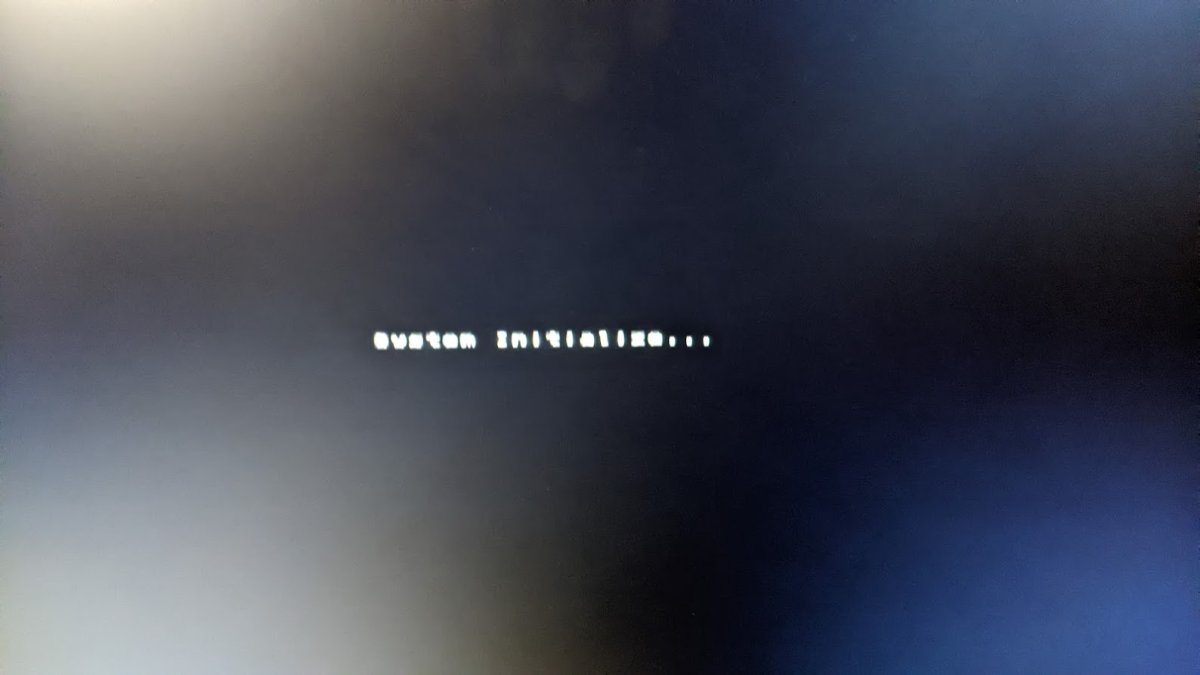

Hi,
I got following message when I try to boot Virtua Striker 3:
System initialize...
Is there anything I could try to get the game to work?
Thx,
N2
Could be a power related issue.
What are you running the Naomi 2 in? Do you have any other Naomi 2 games to test?
can you go into test and clear the settings ram?
I have exept VT3 only Naomi 1 games - but these work....
I can test this in the next few days....
Thx a lot for help,
N2
Unfortunately not. By the way: Before the message "System initialize..." appears, I get the message "Clearing Backup Data".
