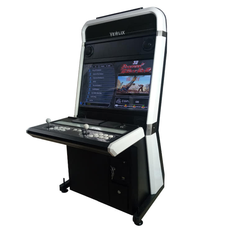

So I decided to purchase the 1:1 clone with the caveat that it comes wired for Chamma with a junk Pandora EX2 4300-in-1 box. I heard it's not built as strong as the ones I'm used to but this is for a residential environment. I upgraded the monitor to 1080p w/ HDMI. It also comes with Sanwa buttons&sticks and this encoder for PC play but I'm not expecting it to be awesome
This is the color scheme I ended up ordering
It was $1,500 + $45 payment fee to Alibaba to have the cabinet shipped directly to my door. They use the "Trade Assurance" program which provides some protection and if that fails, my credit card should help. The cab is being built/assembled and should be here in 50-70 days.

That documentation looks like what I was provided from Chino Chan, a user that operates out of the Vewlix/Chewlix Facebook groups. The company name appeared to be something along the lines of "Guangzhou Animation" or something similar.
If it's the same seller I can definitely vouch for the product as I just received two last month.
As home use units the quality is fantastic, I'd trust these to last a lifetime with minimal maintenance.
You are correct. This is from Chino and I found him on Facebook. My Alibaba order points me to this model. These are the upgrades I ordered along side the cab:

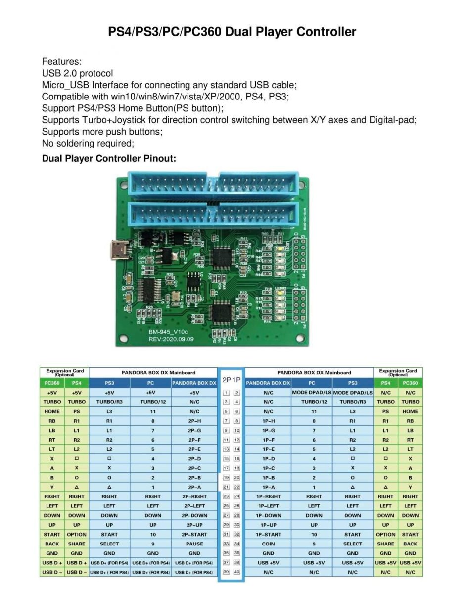

There's even an easy version with screw terminals. Do these show up as xbox gamepads under Windows? I see the "Home" terminal is listed as "XBOX" in the PC column. One reason I was interested in the iPac is for the "shift" function it provides. For example, I can hold the P1 start button and press Button 1 to pause the game.
Yes, these have x-input support, so they will be recognized as a Xbox gamepad in Windows. This is pretty important if you want to play steam games since a lot of them are x-input only nowadays.
As for hotkeys/shortcuts, most of the software has that ability already. You can set hotkey scripts in launchbox, RetroArch, mame, etc.

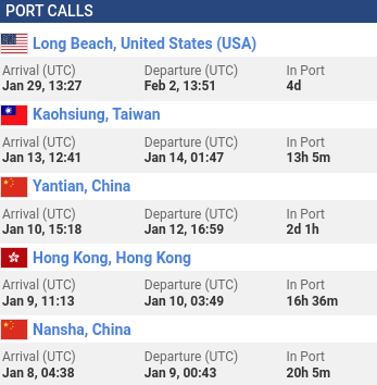

The cabinet should be unloaded on US soil now! For those who like stats, it took a 20 day trip across the Pacific across the "Cosco Englang" container ship.
I believe it was loaded at the Yantian port. Since the boat has already left the US, I assume it was unloaded and it's now waiting for customs.After customs, it will go to a warehouse for people and freight companies to pick the individual crates. I should have a crate in my garage in 10 days.
That's an awesome feeling man, your wait is almost over, I'm psyched to see the updates once you've got it cracked open!
