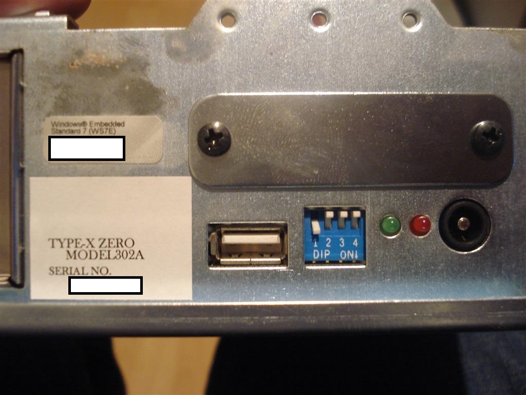

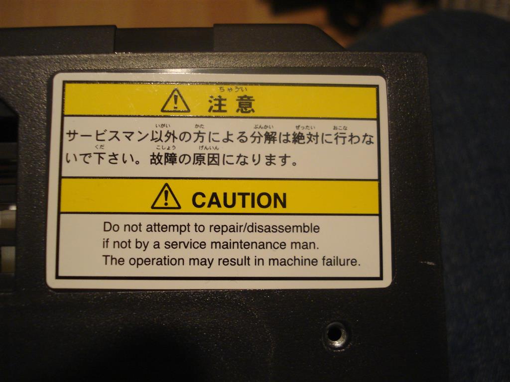

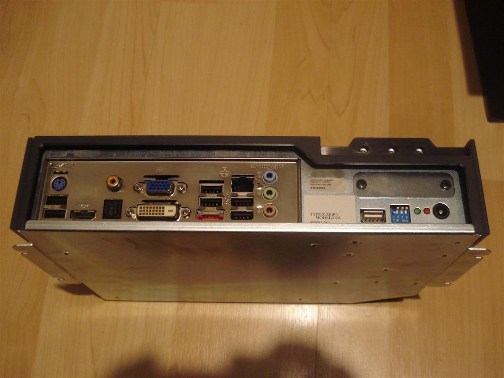

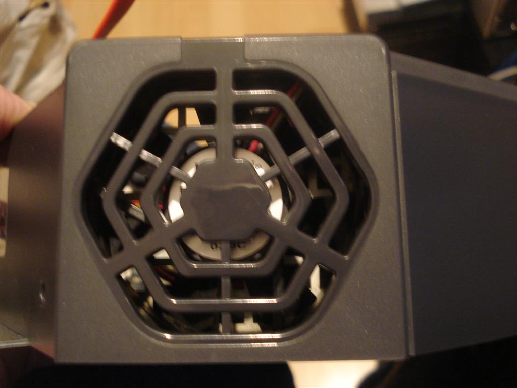

Picked one of these up to have a play with - it was only 3000 Yen so worth it for the case, pity it didn't have the hard drive with it...
Quick tour of the outside.

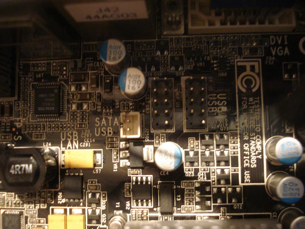

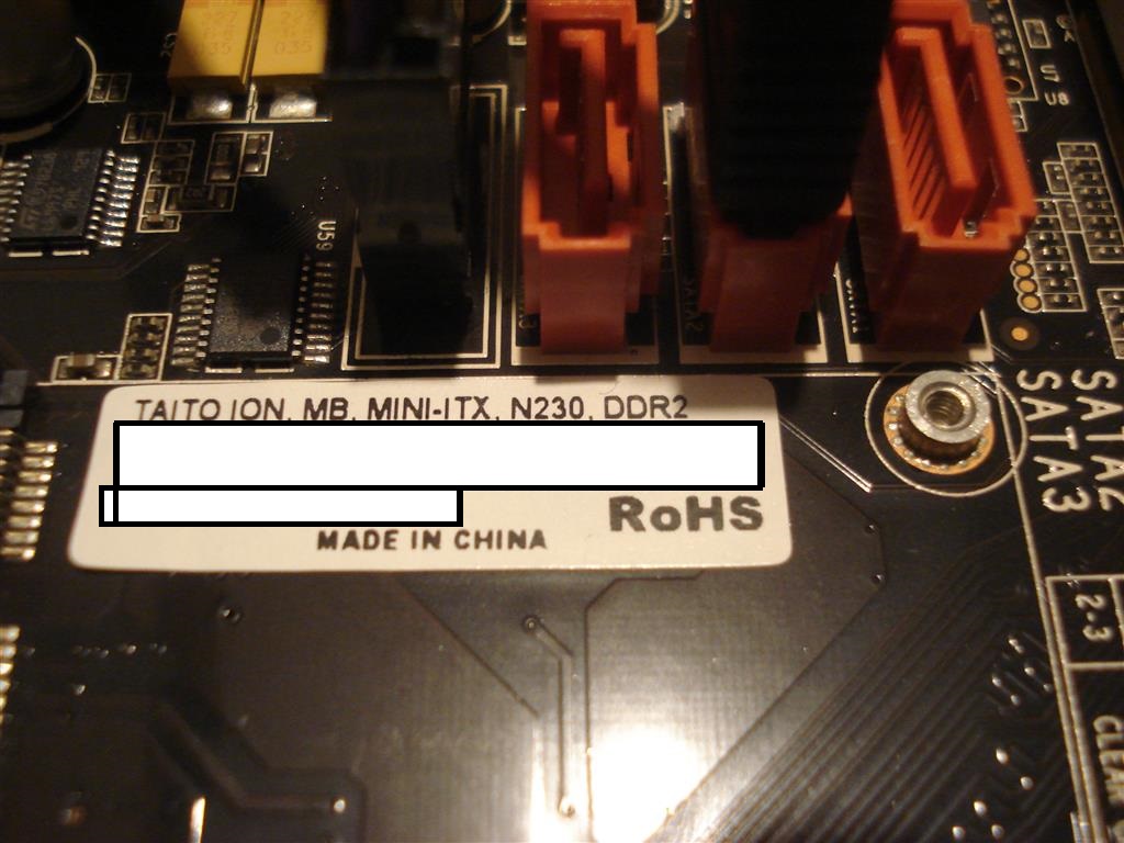

Quick tour of the inside reveals its a M-ITX PCB and a JVS board that looks like it works the same as the JVS-IO PCB in the other TTX units.

I'm going to have a play with it to see what I can do but currently don't have the PSU for it. I'm pretty sure it's a 12V 4A but haven't been able to find a decent picture of the PSU where you can make out what voltage it is and the polarity.
There isn't anything on TTX0 I'm interested in but I think a standard M-itx PCB and a Pico PSU could be a nice option for running MAME in the Vewlix (If I can get the JVS PCB running under windows 7).

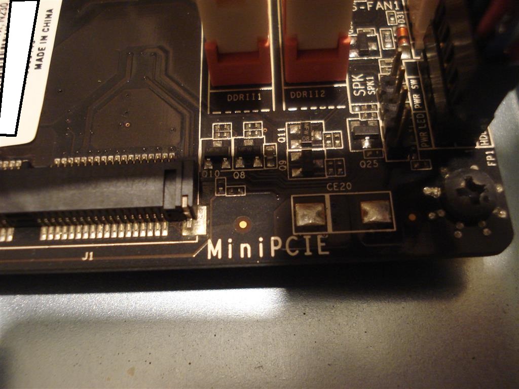

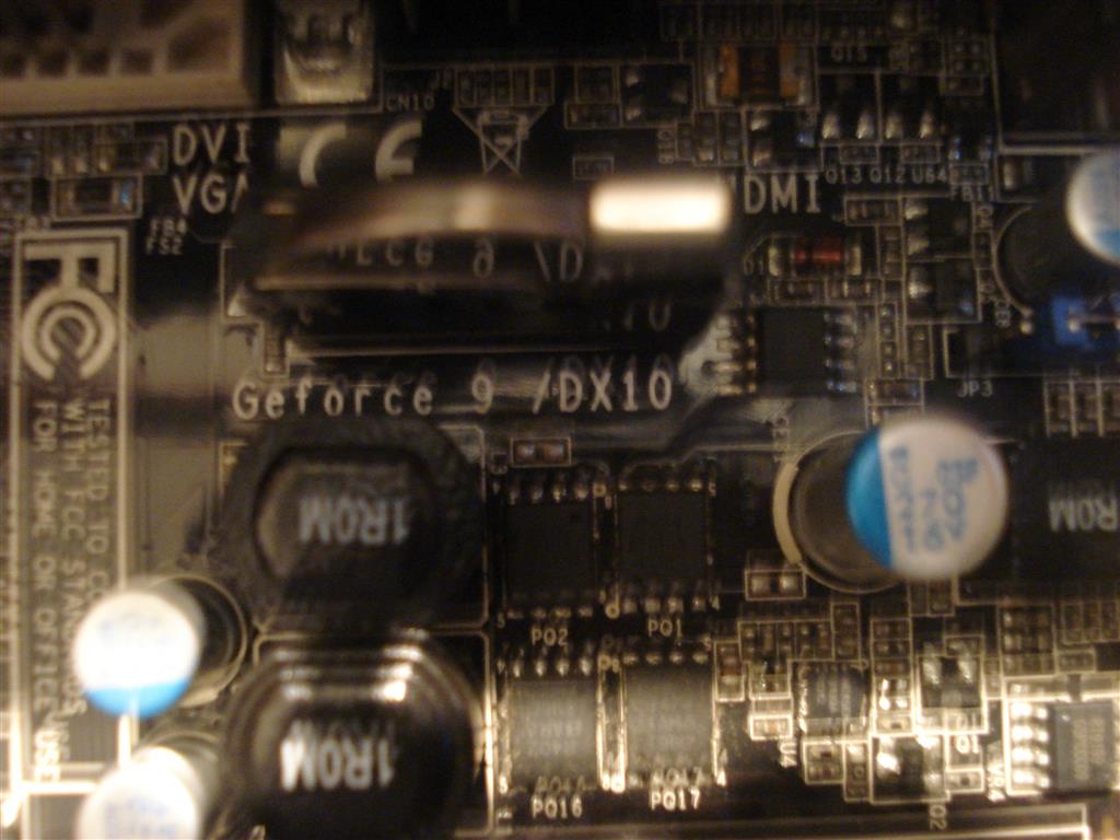

I don't suppose anyone has any ideas what some of the empty connectors are for?

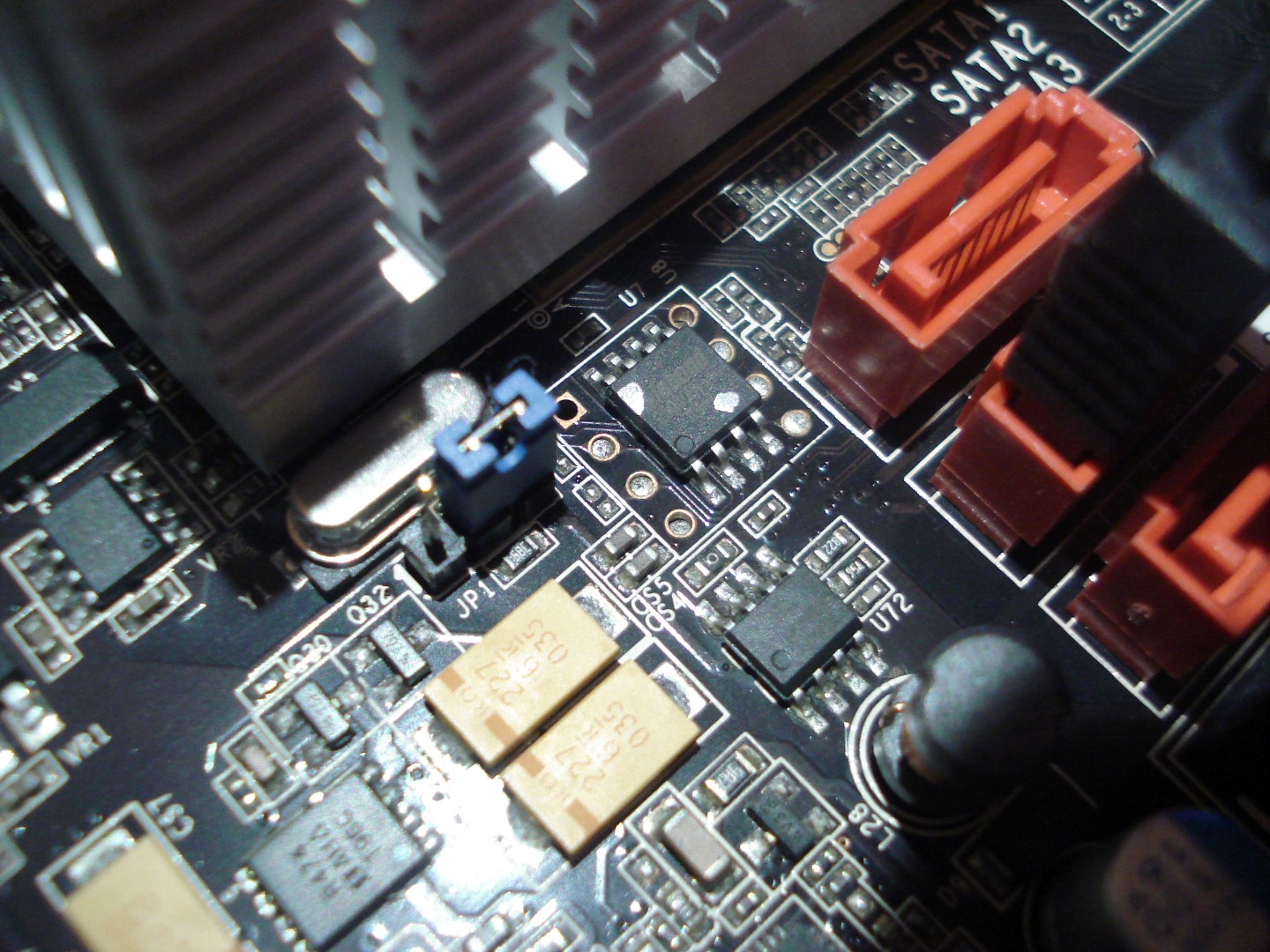

Failing that - can you swap the bios chip for a standard one?
I'm thinking, desolder the top right chip, install a 8-pin DIP socket, then a standard bios and see if it boots.
Any ideas on how I program a standard bios chip - I have the flash program and the rom file, but what chip do I need and how do I program it when I don't have a booting PC?

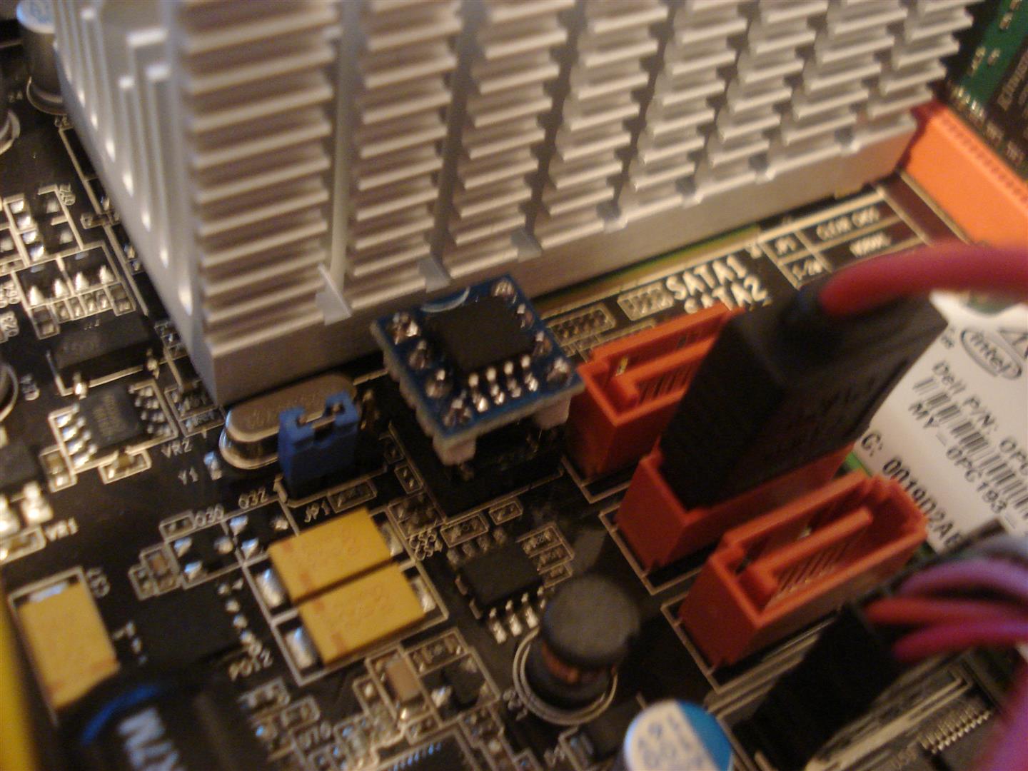

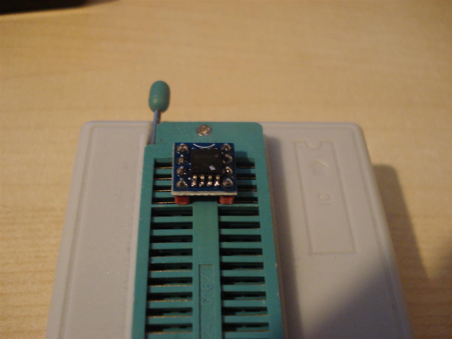

I've desoldered the bios chip - its a Windbond 25Q80BVSIG and replaced it with a dip-8 socket - now I need to source some Windbond 25X80VA1Z which are the dip equivalent.
I've also located the OEM BIOS file.
Once I've sourced some chips I'll clone the TTX0 onto a dip-8 and also burn an OEM bios and see how far I get...
Right - after waiting ages for the chips & adapters to arrive from China I finally have the bits.
I found the OEM bios buried in the zotac website and used my trusty minipro 866CS to write it to a blank chip - I extracted the .ROM file from the P108.zip package and burnt it the same as a normal rom/bin file from MAME.

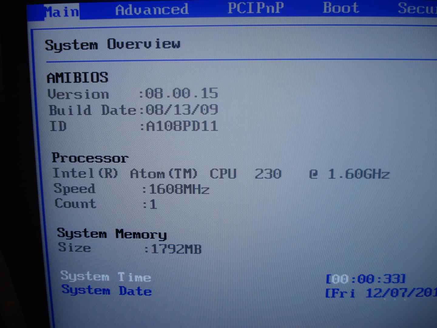

Swapped the TTX0 custom bios for the OEM one and success - the motherboard boots as normal and I can get into the bios using "Del" and change settings (no passwords for anything) so it looks like theres no TPM implemented..
I'll try installing an OS onto a flash-drive tonight to see if I can get it to work as a normal PC.
The JVS pcb still reboots the PC if you leave it in the bios for long enough so I'm pretty sure that's working as it should.
