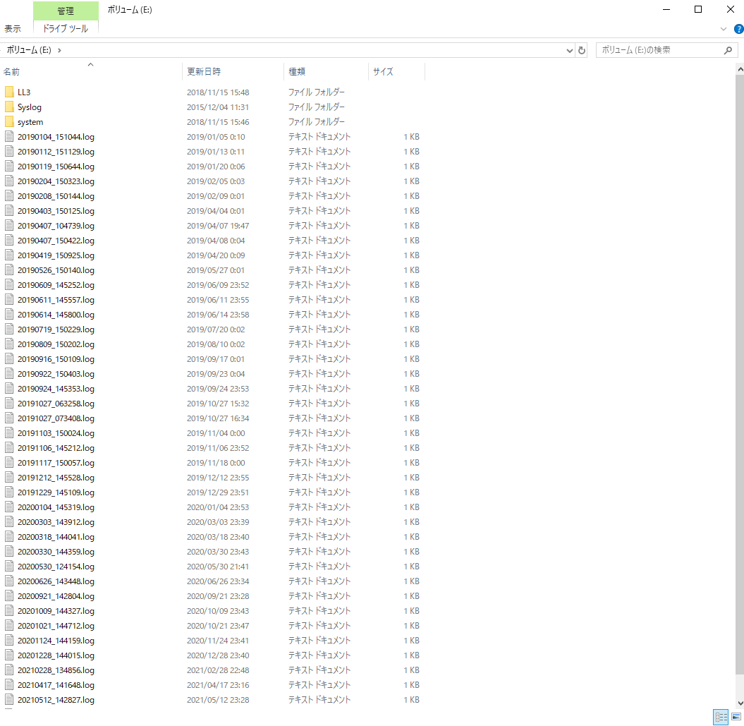

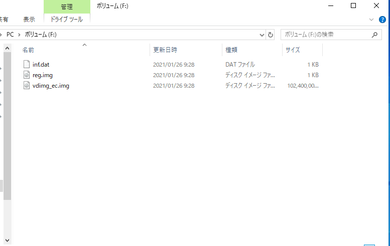

Step 2: Now that you can see all the files on the drive, one of the drives will have a \system\service\ folder in it and you will see a file in there named NesysService.exe. Just rename this file, call it NesysService.exe.old or anything like that.
Step 3. Now shut down your pc cleanly, disconnect the Love Live HDD and reconnect it to your TTX4 and put it all back together and boot it. VOILA, your cab should now boot and it will bypass that fear striking Nesica access error and now you can tap/fap away until your hearts content to your virtual girls grooves.

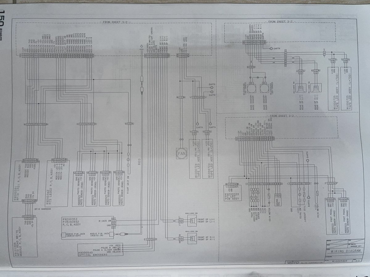

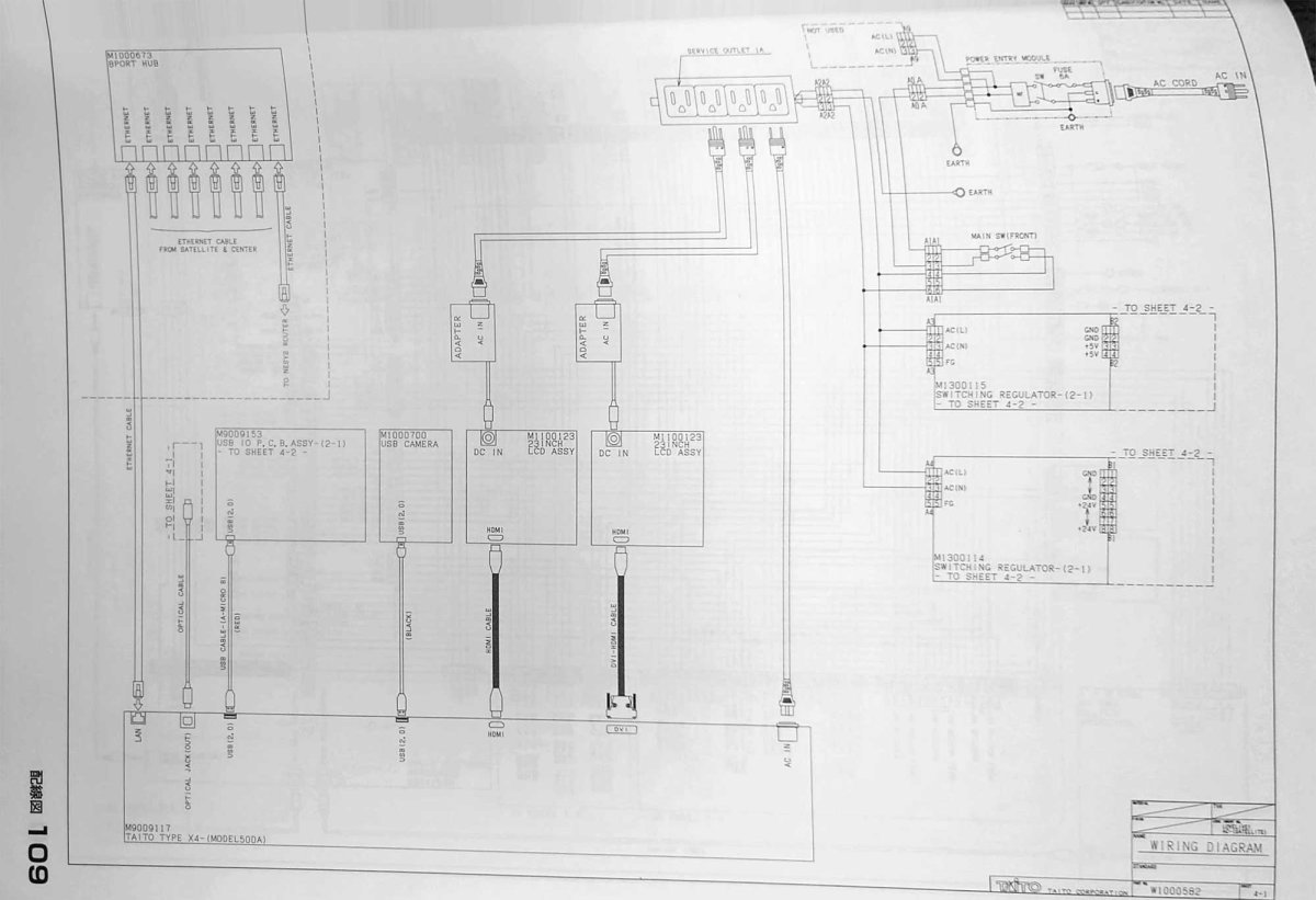

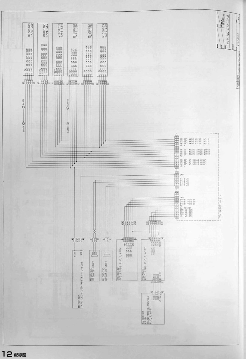

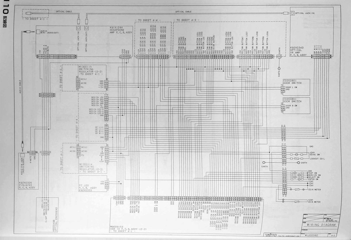

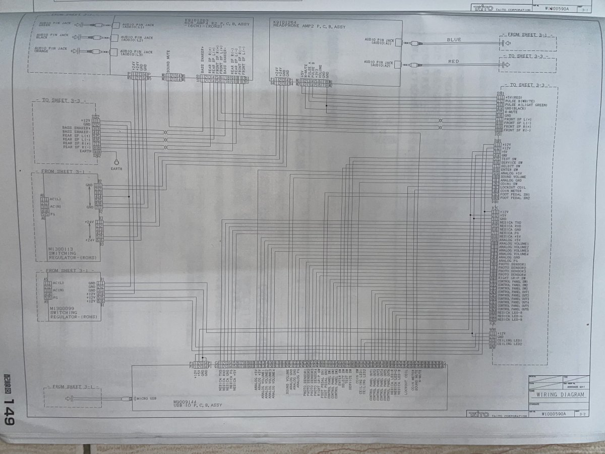

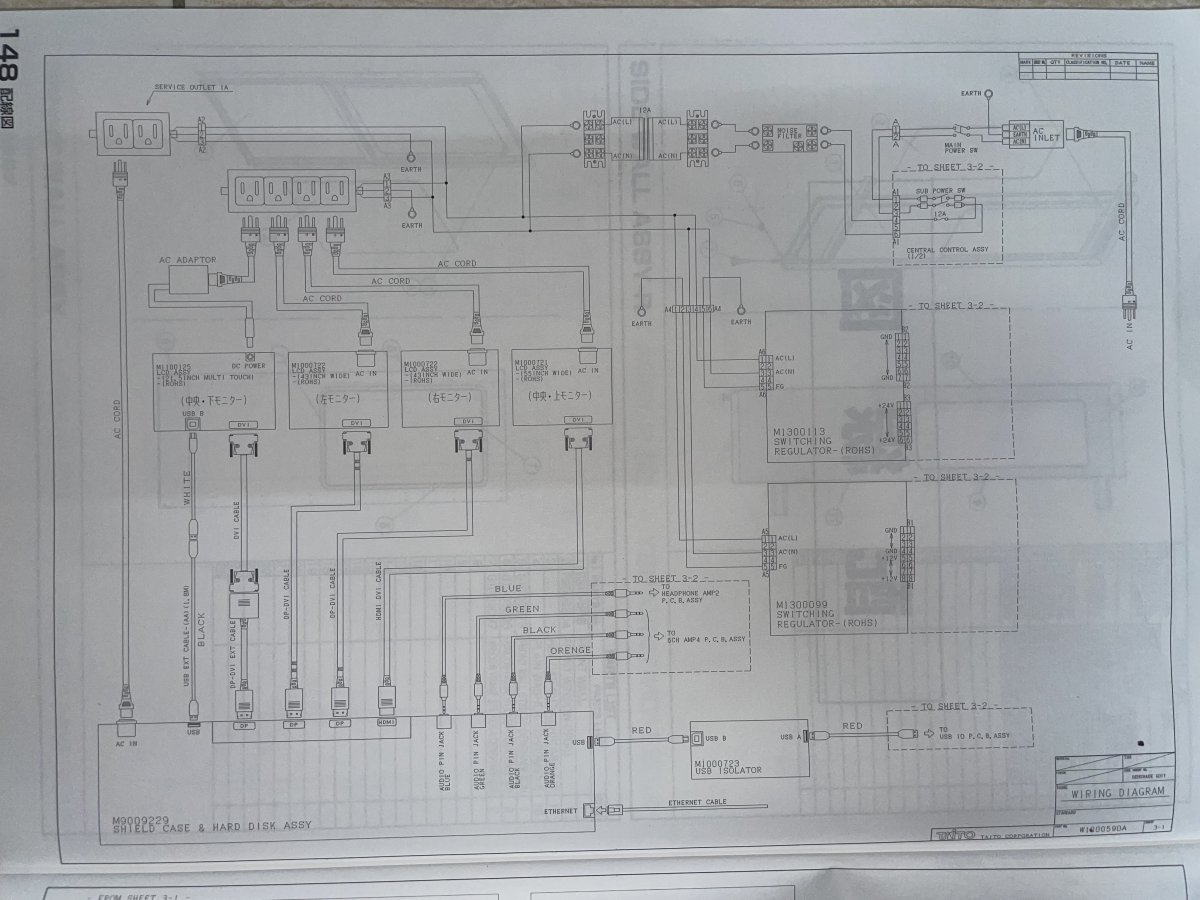

Someone on here scanned the schematic for us i think, i don't know who you are, i got it second hand, but thankyou to whoever you are, you made my life much easier!
