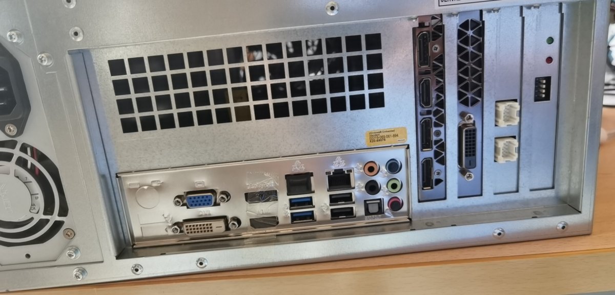

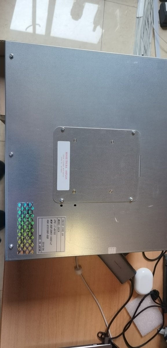

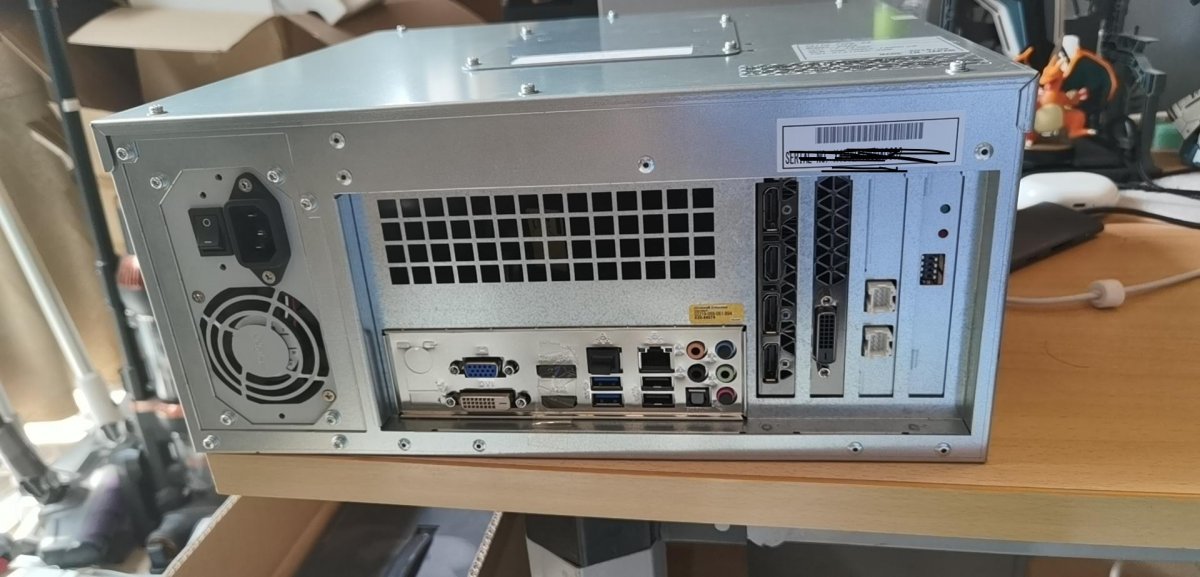

First of all ,thanks emulate58's 1TB TTX3 img . It's working well on my TTX3.
But ,I had got a X4 from Japan , it's a Starwing Paradox game.
When I got this one today , I tried a lot to find the bios password . So I entered the bios ,and change the taito model for develpment mode. After that ,now I can boot X3's 1TB harddisk。
It runs well , the x4 is silent . I had tried some games , almost all are ok ,but someone had problem : street fight 5 , tenken 7 ....
I have not test all ,but some one can not start .
If you have a chance to get a Taito x4, it's worth to get one .

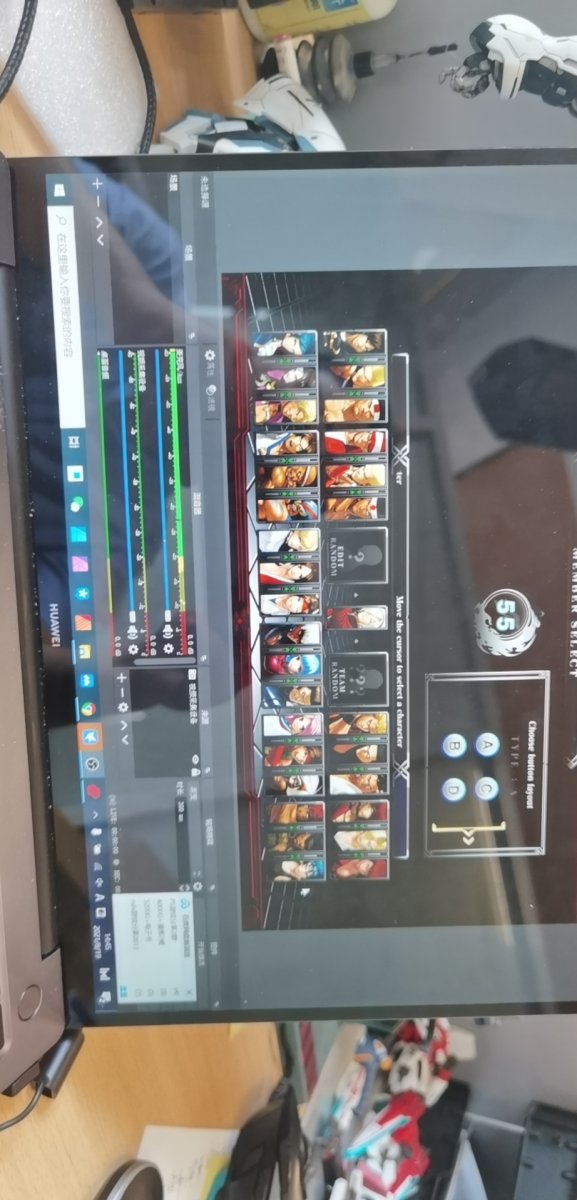

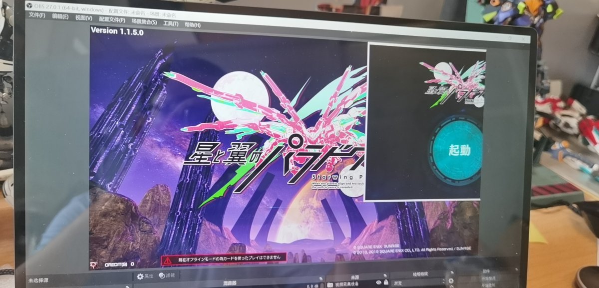

attched are some phone for view but not so good because I used a video capture for dispy on my note book.
This is the devlpment mode.
